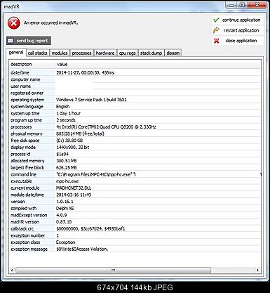

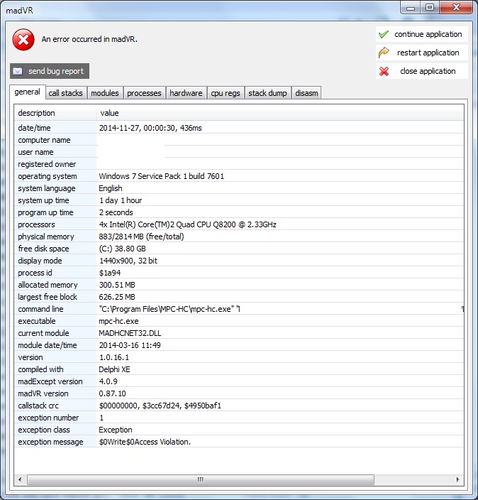

    I'm experiencing a strange issue with MadVR and MPC-HC while playing a SD video of any kind. When I go to full screen, it freezes and generates an error message:

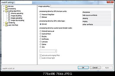

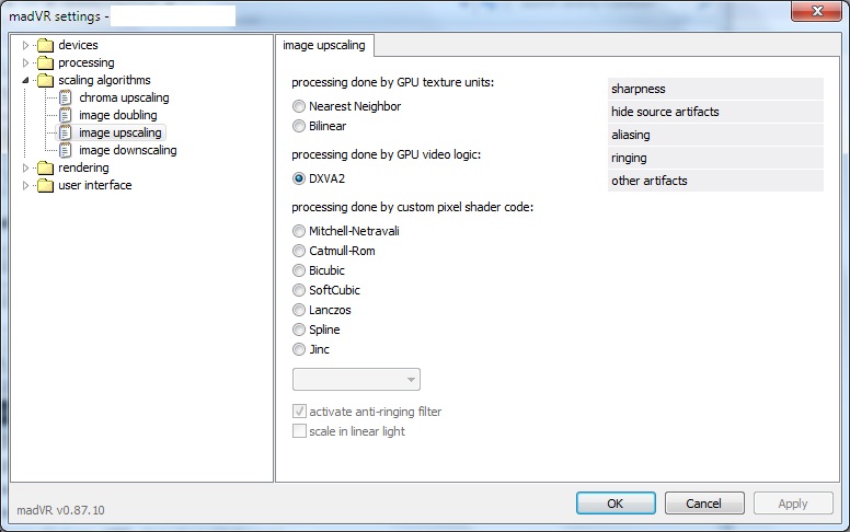

    From turning on and off various settings, I've narrowed it down to the Image Upscaling setting in MadVR. If I put it on any other setting than DXVA, it causes the crash:
