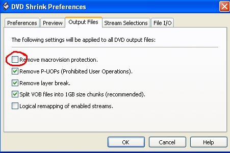

  7. I got one DVD movie and played it in the Chinese DVD player in question, and the player does honor macrovision (alternating brightness change when signal going through vcr, - if the DVD disk has macrovision. This flavor of macrovision is called Analog Protection System (APS). To make a test disk, I used DVD Shrink and unticked Remove Macrovision Protection (see screenshot).
    I have uploaded two DVD folders - one minute video- (one with macrovision and one without macrovision) that can be burned to disk and tested in a DVD player/vcr. In my case, the folder "macrovision" when played through the vcr shows the alternating brightness, while the folder "no macrovision" plays perfectly.
