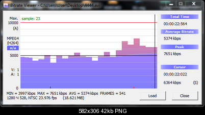

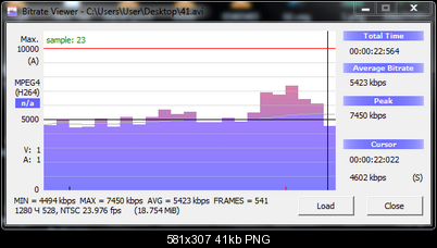

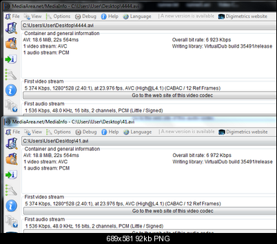

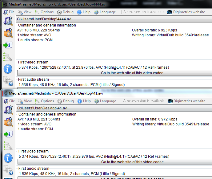

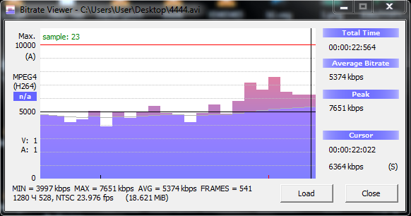

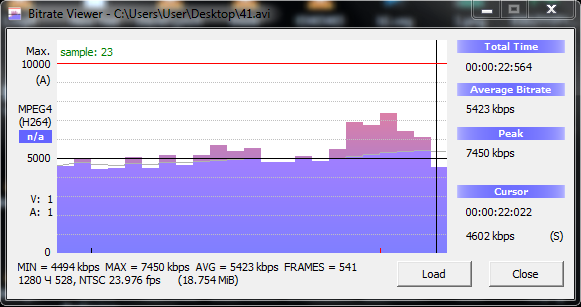

  5. i set crf to 22 and when i check the bitrate it is 5374 kbps. and i use this bitrate in 2 pass.
    and here are the results:
    crf
    2pass
    so, if i set the bitrate of crf compressed video for 2 pass will it give me the same quality?
  6. Member Cornucopia's Avatar
    CRF uses 1 pass. It doesn't need a 2nd pass. You get consistent quality, at the expense of unknowable (possibly larger) filesize. If, on the other hand, you choose 2pass VBR (NOT the same thing as CRF), you get consistent filesize, at the expense of unknowable (possibly worse) quality. To use VBR EFFICIENTLY, you should do 2pass vs. 1pass, because VBR wants to "look ahead". With 1pass, it can only look ahead 1 frame or 1 GOP (maybe 2). With 2pass, it can look ahead to anywhere/everywhere in the file (because it has already done it in the first pass). CRF doesn't look ahead, which is why its levels might be a little more "wild" and/or higher. It is possible to constrain both so that they put out equivalent filesizes (rarely identical) and near-equivalent quality at that size. But why do that? - use the tool that best suits your needs.
  7. i meant 2pass VBR not 2 pass crf
  8. so, do they give the same quality when they are at same avarage bitrate?(crf and 2 pass vbr). if not then why?
  9. Member Cornucopia's Avatar
    At the same AVERAGE bitrate, they are the same AVERAGE quality. There will be some times throughout the file when one is better quality than the other, and vice versa.
    Both (at equal AVG bitrate) are giving you similar, but not identical "guesses" of image.
