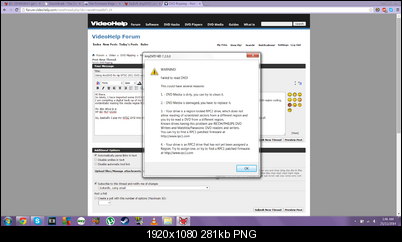

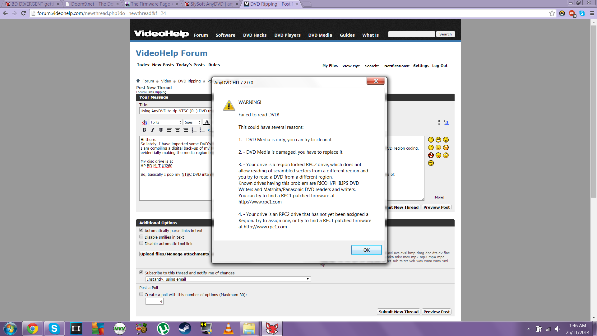

    So, basically I pop my NTSC DVD into my (R4) encoded disc drive on my laptop, and I get an error message from AnyDVD along the lines of:
    Any advice on how to bypass this issue, would be greatly appreciated..thanks!

    NTSC/PAL and Region Codes(R4) have ZERO to do with each other.
    As AnyDVD says.....make sure your DVD drive has a region assigned to it first.

    After doing some Googling, your HP drive matches a Matshita drive....and it is very possible you may be sh!t out of luck after all.
    http://club.myce.com/f88/matshita-uj-812-a-101267/#post637240

    Get an external optical drive, preferably USB3 if you have any USB3 ports on that laptop. Matshita drives are consistently the worst, and cannot be used for your purpose here without changing the region code. And you can only change the region five times.
