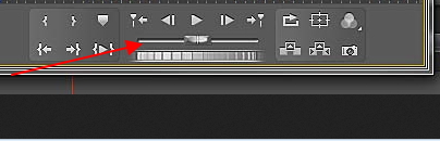

    2) may i know the name of this tool and why there isn't in premiere cc (red arrow)?

  4. Member Cornucopia's Avatar
    From the look of it, that's just a jog/shuttle wheel (aka speed control for speeds in addition to standard 1xFwd).
    What are the "possibilities" you seem to be missing?
    hi
    sadly the jog/shuttle wheel is gone in cs6 and later

  7. The jog/shuttle wheel has nothing to do with scrolling titles.
    To repeat Scott's question, what are you actually trying to do you think Premiere can't handle?
    hi
    about jog/shuttle i miss it , that's all , was replaced by J-K-L keys to scrub footag http://blogs.adobe.com/kevinmonahan/2012/07/24/alternatives-to-the-jog-shuttle-control...miere-pro-cs6/ , i know it doesn't have nothing with scrolling text

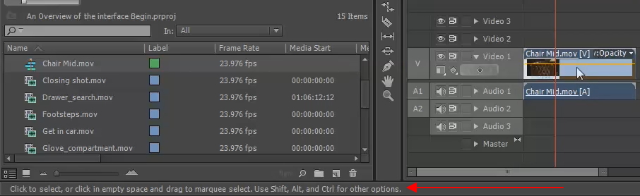

    Hi
    boring about lynda tutorials i bought a video2brain tutorial and it's much much much better
    it's off topic but may i ask you how can i enable the tips that you can see in the screenshow ?
    thanks to everyone !
    really a great forum!
