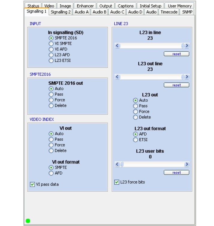

  16. Capturing Memories dellsam34's Avatar
    Jan 2016
    If capturing analog video sources that are widescreen in nature such as anamorphic laser discs, game consoles, widescreen encoded tapes, cable and TV boxes that don't have HDMI out, a capture device that is capable of AFD is required, The capture device can carry over the AFD code or create one on the fly if it is not found. Some of the pro capture device such as S&W TBS800 and similar from Gras Valley, Ensemble Designs and Aja are AFD ready, enabling integration of SMPTE 2016 into the workflow, so they can keep the code, add the code or remove it for SDI digital output.
    As of the date of the creation of this thread this standard hasn't been finalized yet, so this may be something to look for from now on if 16:9 analog material are to be captured.
    Here is more about SMPTE 2016 (AFD):
    https://en.wikipedia.org/wiki/Active_Format_Description
    From the TBS800 control menu:

    Converting HD to SD and cramming it through composite in anamorphic is plain nuts, Composite is 4:3 you cannot fit a 16:9 frame without squashing it horizontally.
    Not quite correct. While I agree it is nuts to do this with an HD source, analog anamorphic SD video – yes even as Composite – is tried and tested in many parts of the world. It is not like you are squeezing the video horizontally more than you would with a letterboxed picture; rather you stretch it vertically to make use of those lines that would be black letterboxes otherwise. So really, all it does is gain vertical resolution, nothing more.
  23. Capturing Memories dellsam34's Avatar
    Jan 2016
    That's what the AR code does, I've already explained it above.
