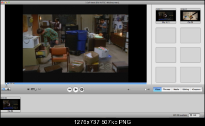

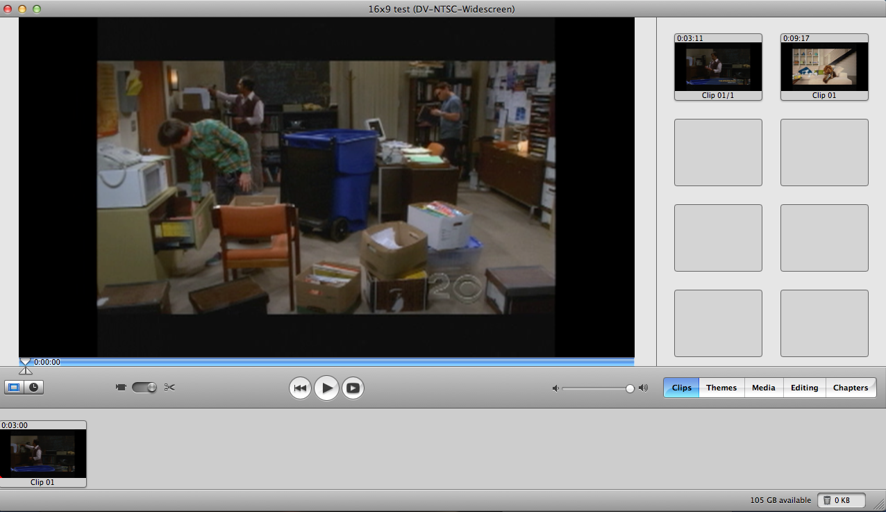

    I've tried this, and iMovie automatically pillar boxes the clip. See attached image. Is there a setting that fixes this for output?
Name:	Screen Shot 2014-11-22 at 12.31.56 PM.png

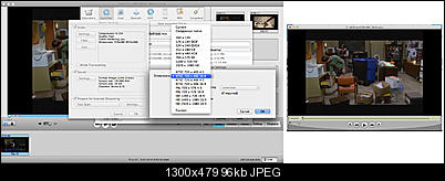

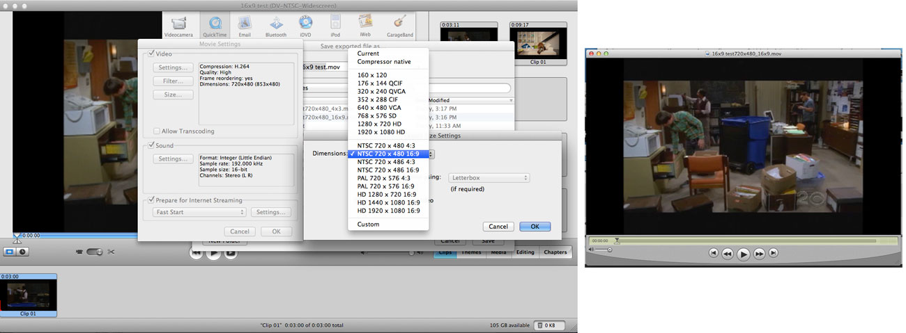

    Sorry, I still don't know how to implement what you are saying. Outputting a Quicktime at 720x480 using either of the two choices in iMovie (16:9 or 4:3) gives me an unsqueezed or squeezed version which is still pillar/letterboxed.
    Am I missing a step somewhere? Is there a place where I need to choose between outputting square or non-square pixels? I'm guessing the process is straightforward, if anyone can tell me what I'm not doing correctly, I would greatly appreciated it!
    FYI: I'm drawing my signal directly from either a live or recorded broadcast from my DVR--if that needs to be considered….

  8. The problem is that your source device is letterboxing the 16:9 source into a 4:3 DAR analog frame. You need to convince the device to output a 16:9 DAR analog frame.

    The ADVC is capturing a true 4:3 picture. Your DVR is letter boxing the original 16:9 HD picture to create a new 4:3 aspect ratio picture and downsizing to SD to sent out via the DVR's S-Video connection or composite connection. Most are programmed to do that because it is assumed that SD connections are going to be used with an 4:3 SD TV, and reformatting the picture that way allows a 4:3 SD TV to display a smaller 16:9 picture area without distortion.
    Some set top boxes can be set up to output anamorphic 16:9 SD instead of letter boxing to 4:3, but that option is probably not common because a picture formatted in that way looks distorted on a 4:3 TV. An anamorphic picture would completely fill a 4:3 TV screen (no letter boxing), but people would look too tall and skinny.
