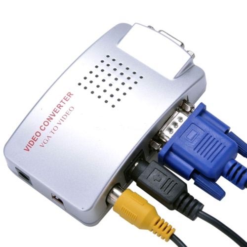

  1. When I'm travelling I want to be able to plug my notebook into any TV such as in a hotel room.
    I've purchased a converter (see attachment) which are widely available on eBay. I use the yellow S-Video cable out to the TV but get a poor quality black & white picture.
    I've returned the unit to the supplier and got a replacement, but it's the same. I've tried two different laptops and two different TV's but they are all the same.
    Are these converters simply rubbish?
    Can anyone suggest one that works?
    Rod

  2. Since that box is standard definition only, it will only work, if at all, in very cheap, older hotels. (And yellow is usually composite, not s-video.)
    So it's not rubbish, just seriously outdated and mostly useless.

  8. I don't know if this will help or not, but I've plugged an NTSC source into an old PAL TV via S-video before, and that came out all black and white and low quality. Could that be a clue? Are you somehow outputting the wrong format or framerate or something, or is it getting converted the wrong way somewhere along the line?
    Like I said, I don't know whether that's helpful or not...
    Feb 2004
    Australia
    Check tv specs for pal or nstc
    The dip switches on the unit are normally set to nstc, thus b/w picture on pal sets... set to pal to change output signal to match your tv (uk = pal)
  10. I didn't notice the OP was in the UK. NTSC composite video will usually be displayed BW by PAL TVs. So yes, change the dip switches to PAL.

    Yes I'm in the UK and have selected PAL on the converter box. I'm then selecting a UK television station on my notebook and connecting via the converter box into the yellow composite video into the TV.
    The picture is poor quality and no colour.
    To try to find the problem I've tried a different laptop computer, a different TV and different cables. All combinations give the same poor quality. The TV's I'm using are small screen, I'm not using a 40" TV !!
    The supplier has replaced the converter box and the replacement is the same.
    Is the conclusion these converter boxes simply don't work?
    I accept HDMI would be a better conversion, but I find very few TV's in hotels have this available whilst most have composite video.

  12. Originally Posted by RodA View Post
    I have one that I use for VGA -> NTSC. The picture is in color for me. But as I said earlier composite and s-video are low quality, period. You wont be able to read normal sized text on a computer desktop easily. It doesn't matter how big the TV is. On a small TV you'll get a small fuzzy picture. On a big TV you'll get a big fuzzy picture.
    Of course, we don't know exactly what you're seeing. If your picture is about the same as those I posted in the earlier link (color issues aside) then that's normal. Any VGA -> analog SD will give similar results.
    I'm just trying to watch the news on TV whilst away from home, outside the UK. I find the only UK TV station hotels offer is BBC World, after 30 minutes of that you tend to end up in the bar!!
    Outside the UK you may have to select NTSC.
  15. First, thanks to everyone who has made suggestions to try to fix the problem. I now know a lot more about video than when I started!
    I've tried connecting the video (Y) out of the converter box into another TV. This one is a multi-standard TV I use in my touring caravan. When I select the AV input it tells me I'm using PAL-I (correct for the UK) and I get a very good colour picture. If I change the output from the box to NTSC the TV tells me I've changed and again it's a good colour picture.
    When I connect the box to another TV (a Sony), I still get a black & White picture?
    The Sony TV information tells me the video input is: Y: 1V p-p, 75 ohms, 0.3V negative sync/Pa/Ca: 0.7Vp-p, 75 ohms/PR/CR: 0.7 V p-p, 75 ohms
    I've contacted Sony support to see what they have to say.
    I'm pleasantly surprised at the good quality TV picture I get on my caravan TV from the computer.
