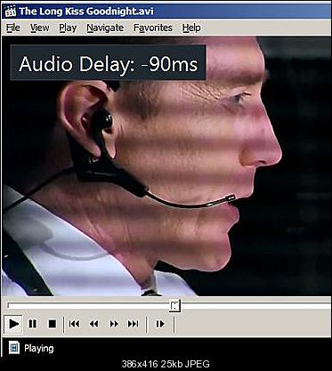

    If you play the mkv using VLC or MPC, you can adjust the delay during playback.
    Note the delay and use that value
    In VLC it's the 'j' or 'k' keys;in MPC it's the '+' or '-' on the keypad.
