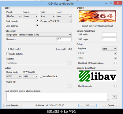

  5. Click image for larger version
Name:	x264 settings.png
    Here are the settings that I use.
    Oh and I gave UT codec a try and now I see lots of options for the codec to choose in my list (yup, I'm a bit new at this stuff) care to give me pointers - UTvideo Pro, UTvideo RGB, UTvideo RGBa, UTvideo YUV420 and so on and on

  7. Originally Posted by bigbangnet View Post
    That's about as fast as it will get.
    Pick the one that matches the capture. Use RGB for 24 bit RGB capture, RGBA for 32 bit RGB capture.
