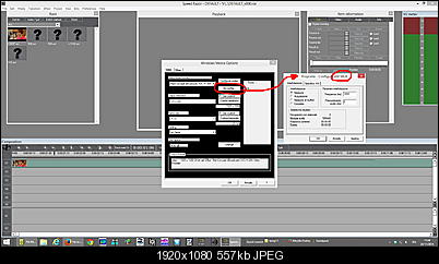

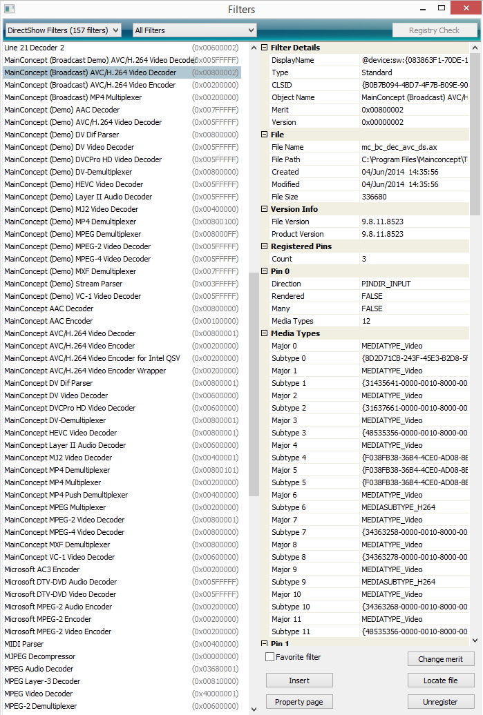

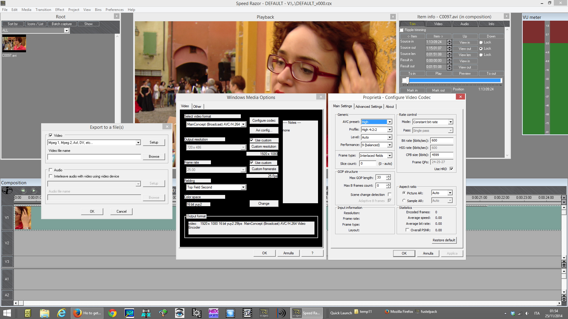

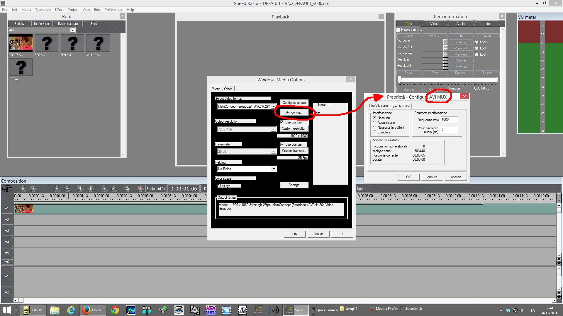

  1. the same problem of duration doubled is present trying to export by speed razor. However I think it uses the same directshow avi mux
    so I wonder: can I try to replace the avi mux module present in directshow with another?
  2. I used mainconcept MP4 muxer - can you try that in graphstudio or s**** r**** ?
  3. Remember that AX components ? You can try their AX64 file writer, and/or AX MP4 multiplexer filter as well
    Did you try the "dump" filter jagabo suggested ?

    the problem of the ax64 is that the speed razor for cats don't see it in list of codecs, is there a way to "see" it?
    I searched the dump in the DSFMGR but I cannot find it, where is downloadable?

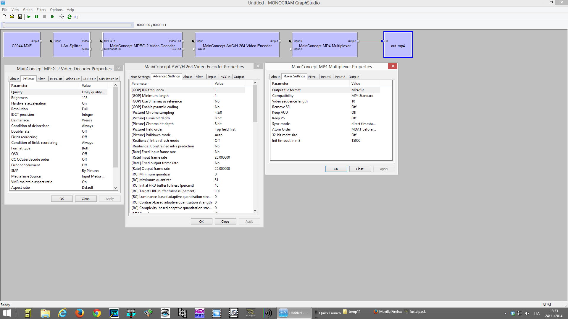

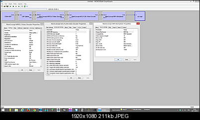

    or is the Mainconcept MP4 Multiplexer?
  9. Yes, mainconcept mp4 multiplexer - you had the same one in your 1st screenshot on the last page (post 49)

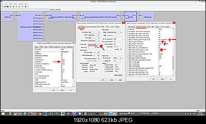

  12. Click image for larger version
    trying using mainconcept mxf decoder but after the press play, system freeze and I have to kill graphstudio with the task manager
    using ffdshow as decoder, when I press the play button don't do nothing (but ffdshow seems take progressive output also when the interlacing options are cheched)

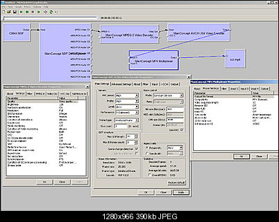

    also trying this:
    but graphstudio don't write the mp4 output file
  14. I don't know, maybe contact rovi/mainconcept ? The other difference was graphstudio next (not graphstudio original), and broadcast avc encoder (422)

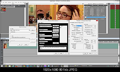

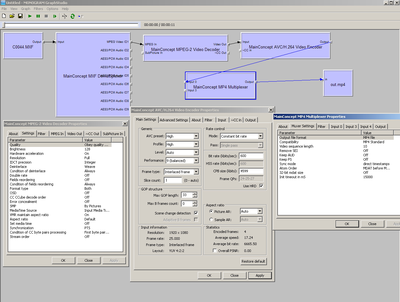

  24. upload sample with "double duration"
  25. Click image for larger version
    from the timeline of the dyno-nle I have select 5seconds. If I try export with all other encoder I get a 5seconds of file, but only with the mainconcept and only in "interlaced field" the duration is doubled (5seconds.avi = 10,0 seconds)

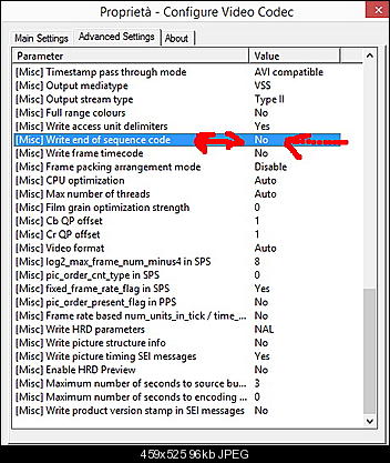

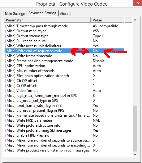

  26. ps: duration become 10 seconds , 40 ms if in the advanced settings, the "write end of sequence" is set to yes:
    otherwise is 10,00 (exactly the double)

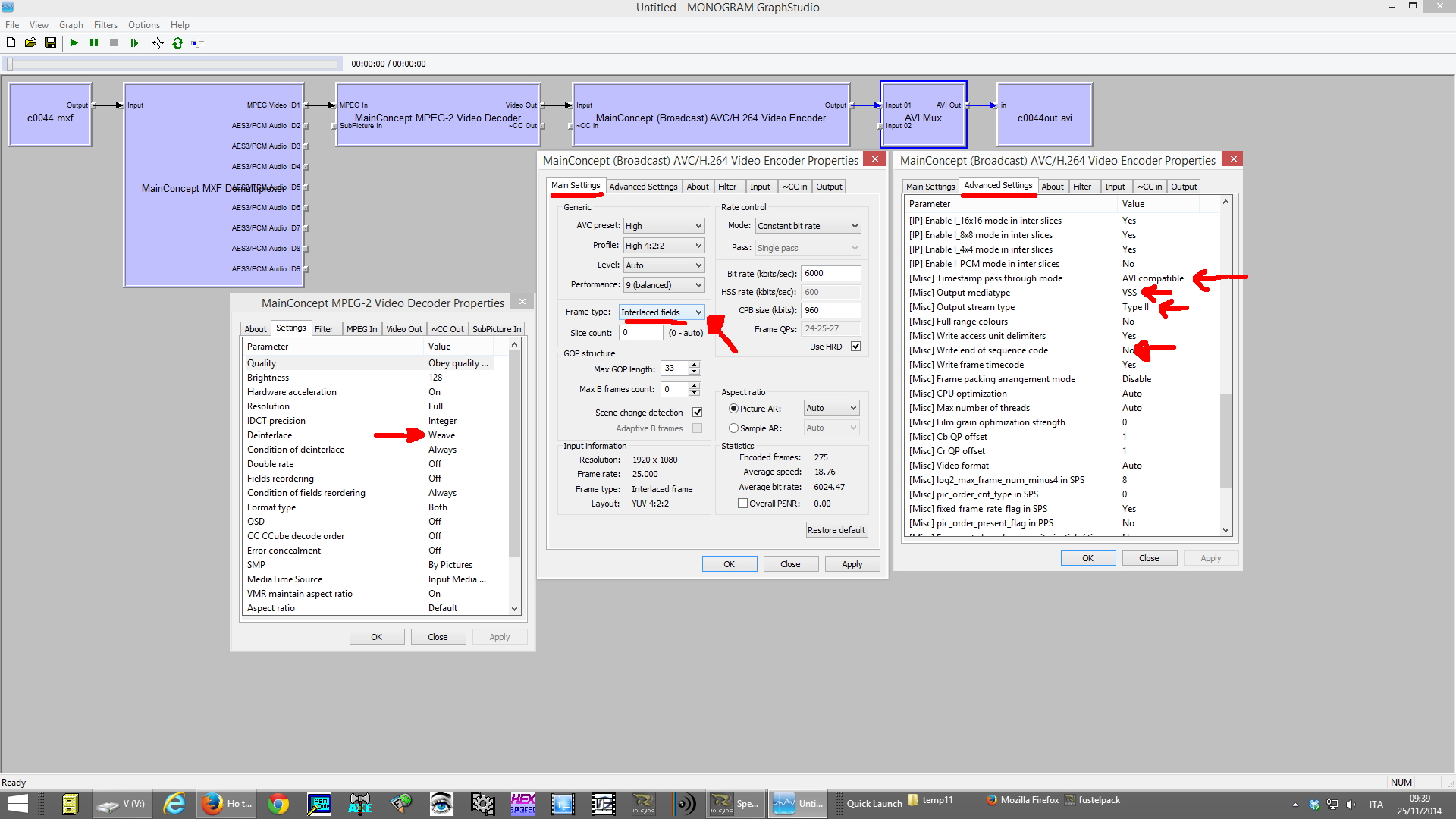

  30. ok but the doubled duration is not guilty of Speed Razor For Cats 5.51, is a problem in output of the mainconcept codec: in fact the same doubled duration is present if you try to encode the C0044.mxf using graphstudio once time in "interlaced fields" and in "interlaced frames"
    when encoding in "interlaced frames" duration is the same of the original c0044.mxf
    when encoding in "interlaced fields" duration is doubled (C0044out.avi)
    seems duplicate frame, considering the attached C0044out.avi really is not a way to cut the frame duplication with ffmpeg to half duration?
