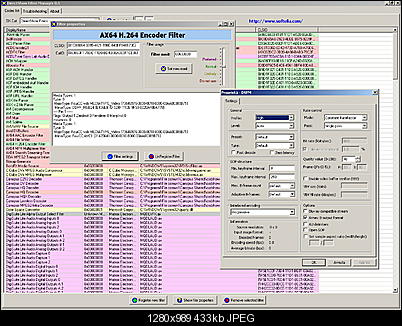

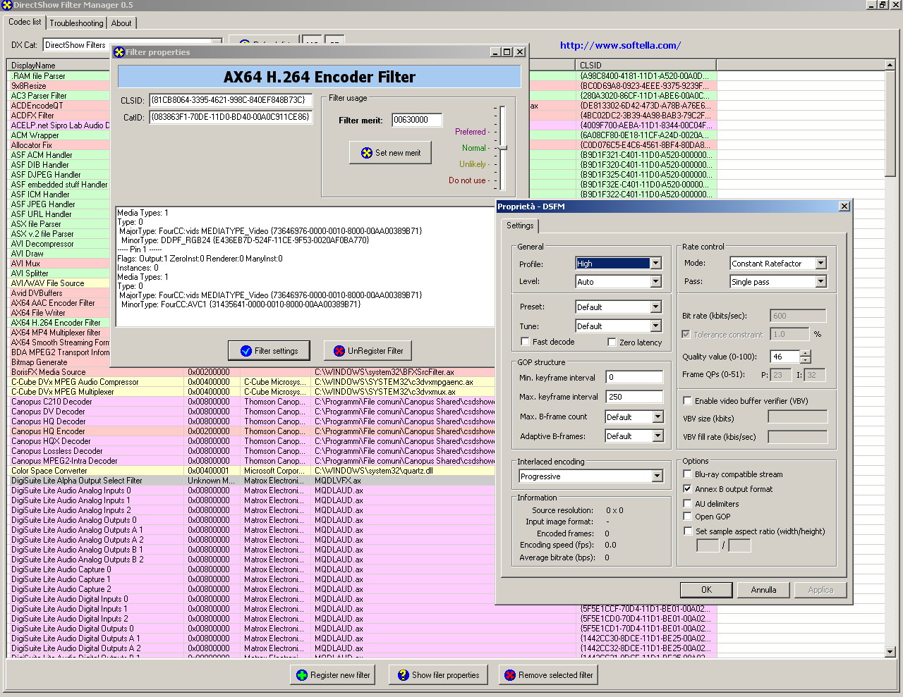

  7. think I have correctly installed the ax codec (seems good... high422, interlaced ec..) but ..

    speed razor don't "see" the codec in the list of codec altought it seems correctly installed

    It's a wrapper for x264. The preset and tune should be a big hint, but I tested it already and verifed MBAFF, the metadata even says x264

    It' s just a directshow filter for x264. It uses the same x264 libraries . It encodes MBAFF only. So not useful for you

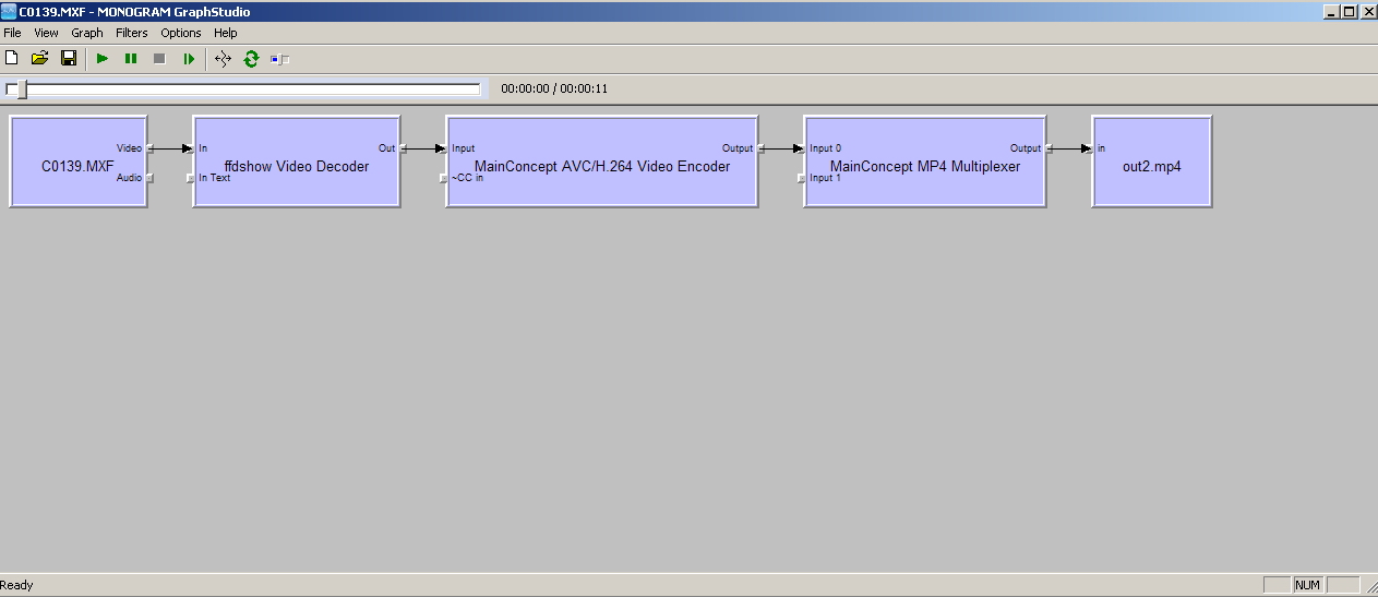

    Yes duration is correct
    Construct a graph,
    1) graph => insert file source (async), select input file
    2) graph => insert filter (add the mainconcept filter).
    3) Connect the pins from output to input of the mainconcept box (drag a line from the boxes). Graphstudio should automatically put in a directshow splitter and decoder, that you have arranged merits for (higher priorities get connected first)
    4) change your settings. Right clicking any box gives you more options, you can check the input and output pins, colorspaces etc...
    5) Insert mainconcept mp4 multiplexer filter, connect the pins
    6) Insert file writer (graph=> insert filter)
    7) push the play button to "encode" it
    (This is for video only. You can do the same thing with audio and plug it into the multiplexer filter)

  21. 1) I originally used ffdshow for video decoder, but I noticed output pin was 4:2:0 and I couldn't get it to decode 4:2:2 properly (thus couldn't encode 4:2:2 properly), so I swapped it out with mainconcept .
    2) Check decoder settings as well, some are set to "deinterlace" by default. You need to disable all processing, esp. deinterlacing. It's called "weave" in many decoders. Never leave any settings on "auto"
    3) Sometimes other splitter might work better, like lav splitter source. I used Mainconcept MXF Demultipexer from file source (async)
    4) I'm using graphstudio next, not graphedit, maybe there is a difference there with the file writer? (it looks like he's using graphstudio) . I've written other things like MKV before so if it's supposed to be AVI only, I don' t know how it works .

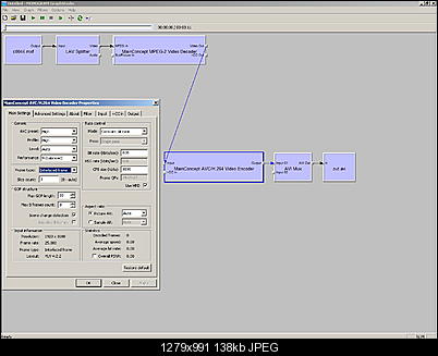

  22. Originally Posted by poisondeathray View Post
    You may be right but in the past I've had problems trying to write other types of data with File Writer. And I know there's more than one filter with that name. Is yours qcap.dll?

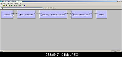

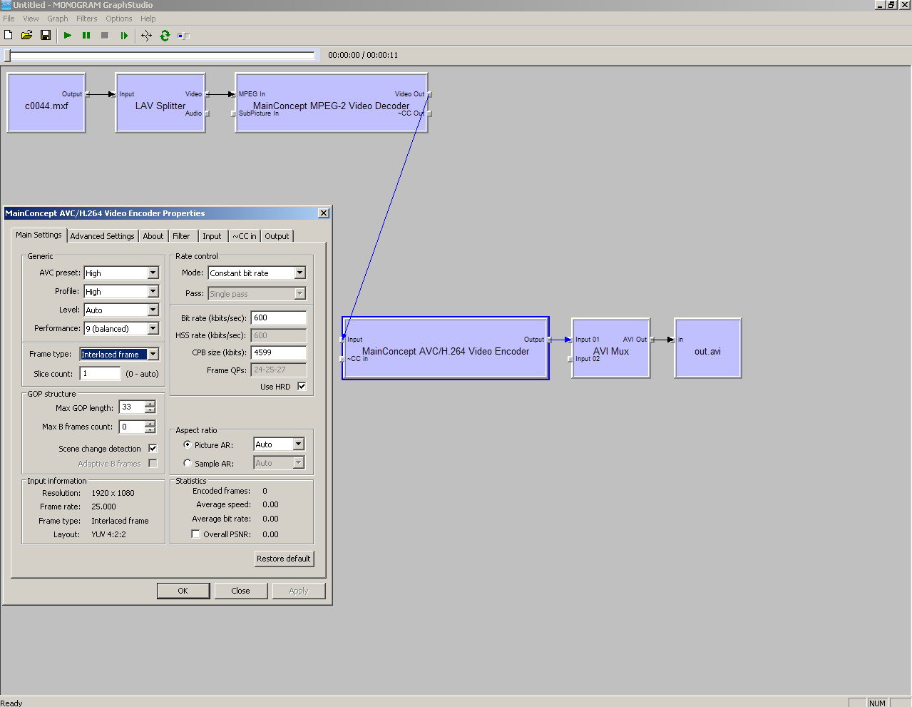

  23. Yes, it's qcap.dll . It works with the MP4 multiplexer as in his screenshot above. Maybe the MP4 multiplexer is doing the actual muxing and writing?

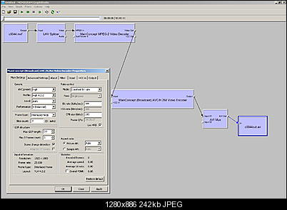

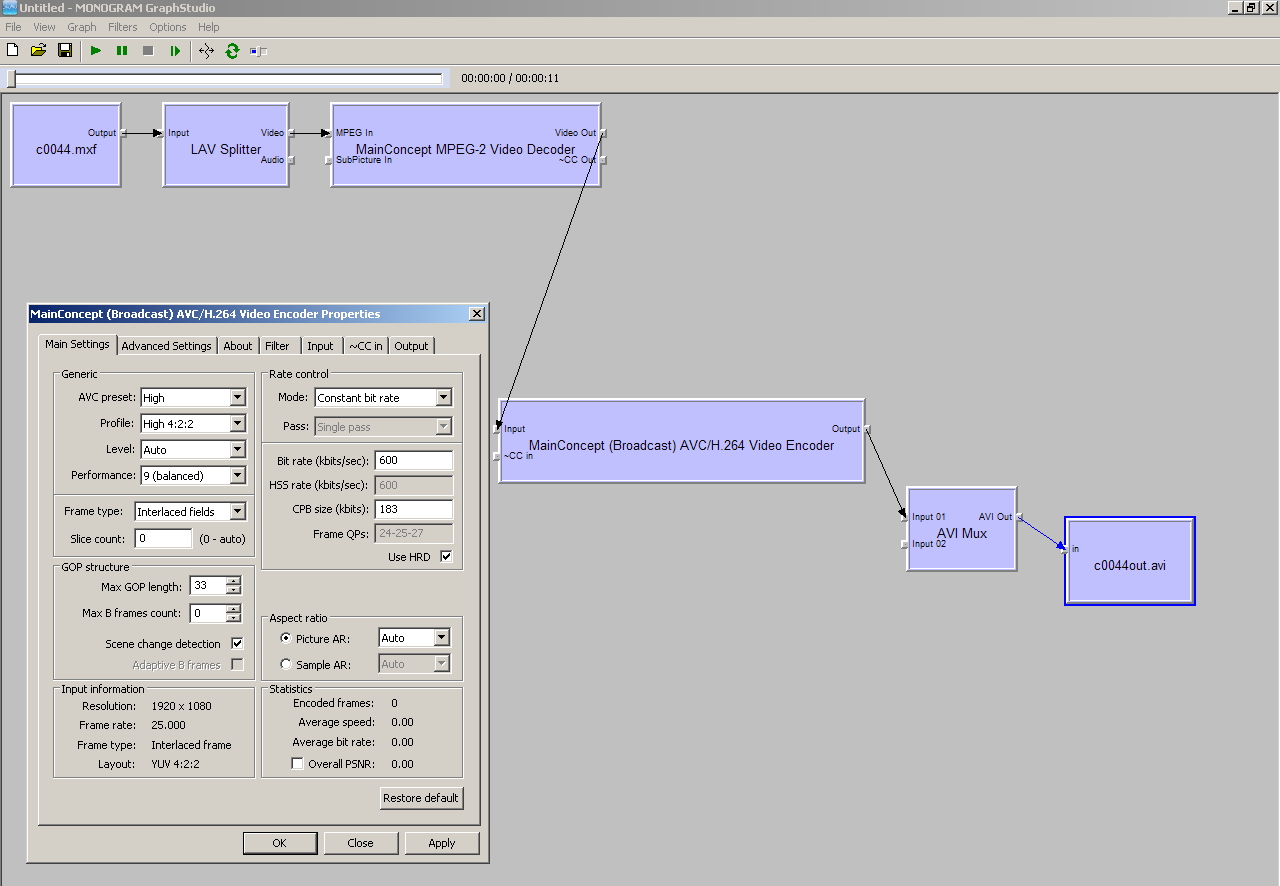

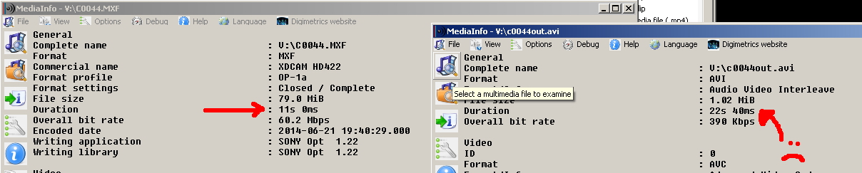

    hoewver using the mainconcept (broadcast or non broadcast) h264 avc codec, when I set in the "frame type" menu --> interlaced frames, I get an avi (mpeg in avi) file that have the same duration of the original.
    When in the "frame type" I set "interlaced fields" ---> the duration is doubled (or almost doubled) and seems there is no option to remediate.
    In the "advanced settings" menu of the encoder, to write an avi file, is possible that is necessary set the [MISC]Timestamp pass throught mode ---> AVI compatible

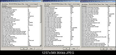

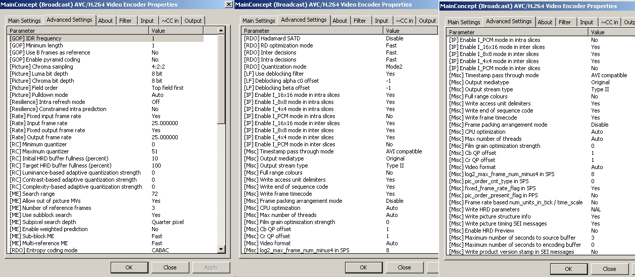

  25. And I don't think the "regular" encoder can do 422, it's not the right version in your screenshot
    Check advanced settings, post screenshot of that when you switch the encoder
  26. ok but don't change nothing: the problem of the doubled duration remains

  27. Originally Posted by poisondeathray View Post
    I have try all possible combinations but the doubled duration remains
    Maybe I was the one with the "bad' File Writer in the past. For some reason the Win7 64 bit computer I'm on right now doesn't have File Writer at all. I just checked on another Win7 system and I was able to write the output of other muxers with File Writer (qcap.dll).
  29. Originally Posted by marcorocchini View Post
    I think this is the common problem where some decoders don't interpret field-sequential encoding correctly.
  30. I don't think he has the field rate issue - because his screenshot shows 0:11 in the main screen (and interlaced frame, 422 as the input). So everything up to the encoder looks ok. I used mainconcept mxf demuxer (not lav), but I doubt it has any effect since your time looks ok up to the encoder
    I think you already tried it, but I had pulldown: no pulldown, and timestamp pass through was "keep input"
    I dont' know if it makes a difference, but I was using graphstudio next , not graphstudio
