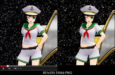

  2. Here's the comparison (Youtube vs Source), you can clearly see that the edges on the left are not okay.
Name:	bandicam 2014-11-21 14-57-39-641.png

  4. The jaggies are most likely occuring when YouTube is re-downscaling your upscaled image using less subtle tools methods than you used to upscale. Had you uploaded a video that matched your original source this would probably not happen.
    As for the 60p thing. Sure it's "good news," but If you only have 24 images per second to begin with, what's the point of uploading 2.5x as many frames as you actually have? Upload at 24.
