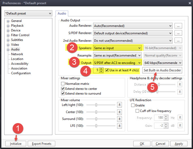

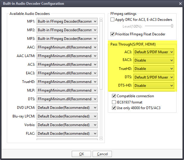

    Try this: Right click on Pot Player's window. Click "Audio", then click "Audio Renderer" then select the audio device for S/PDIF. In my case that is "Realtek Digital Audio".
  3. Click image for larger version
ID:	28687Click image for larger version
    It is not that hard.
  4. Thanks sheppaul!
    That did it. Is there a data flow chart of how PotPlayer processes the stream, including codecs and how settings effect the decoding?
    Call me old school, but unless I can picture it in my head I don't really get it
  5. It's not different from general codec setup process.
    Order of priority for spdif setup.
    1. SPDIF settings in the second screenshot. For example, eac3/truehd/dts-hd will be re-encoded into ac3 as the spdif settings are disabled.
    2. While doing re-encoding into ac3, channel (speakers) setting will be used. If you want to upmix stereo (like mp3) into 5.1 ch, set speakers to 5.1 ch and disable #4 option in the first screenshot above.

  7. I just now installed the latest PotPlayer based on this thread... I also wanted to play a video containing 5.1 channel AAC, transcode to AC3 and output over SPDIF. But, the option in step 3 of steppaul's instructions (set Output to SPDIF after AC3 re-encoding) isn't there in the drop-down menu - it only offers PCM and LPCM.

    I have latest Potplayer version and the option is there. Try initialize potplayer first. Step 1 in tutorial. You can get to this option also right click on potplayer screen - Audio - Output mode as in preference audio 1. PCM 2. LPCM 3. S/PDIF after AC3 encoding 4. S/PDIF after DTS encoding.
