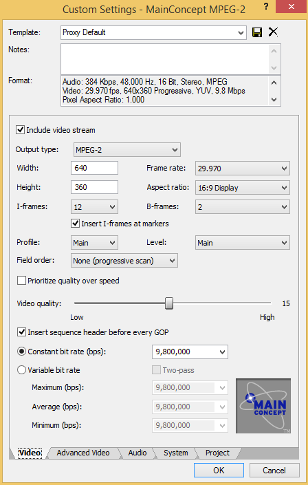

    Can you tell if the settings below are correct?
  4. DV actually makes an excellent proxy -- i-frame editing, relatively clean image, etc. Low bitrate i-frame h.264 also works, but tends to be too blurry to judge focus.
    edit: (Cross-posted.) i-frame (no GOPS) is more important than raster size or bitrate for responsive editing.
  5. I'm guessing from your other thread, that you're using vegas' internal smart proxy feature. I haven't used it
    But in general, MPEG2 editing responsiveness will be noticibly better if you use I-frame only (ie. set I frames to 1, b-frames to zero)
    Bitrate doesn't really affect responsiveness much, unless it's really high
    smrpix raises a good point about quality - for proxy edits all you need is "good enough" for what you are doing. If you need to resolve fine details, maybe fine mask work - then obviously you can't use a low res/ low quality proxy for that .

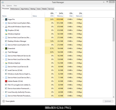

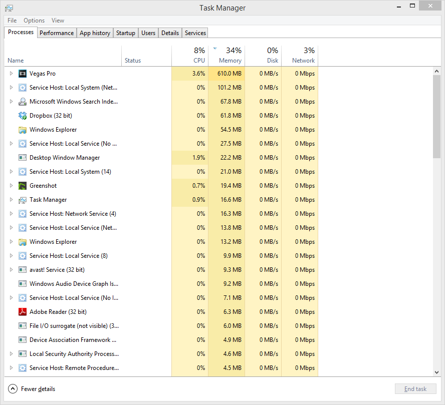

    Here's how the task manager looks like (prior memory bottleneck):

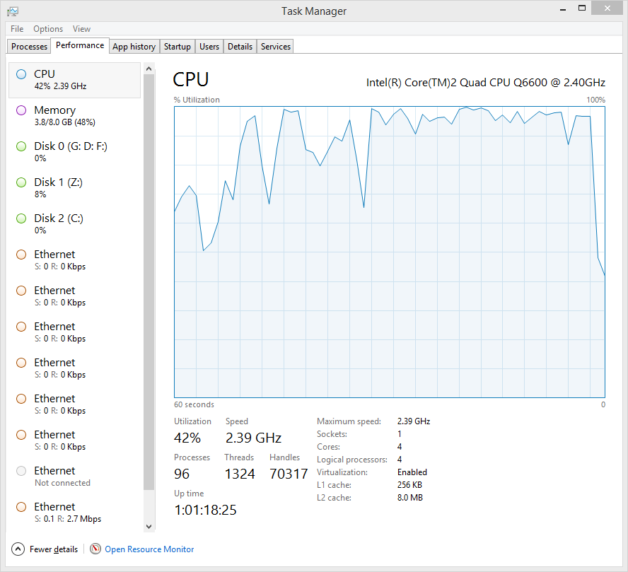

  10. Did you check taskmanager when you were in the middle of the project with the "extremely unresponsive" periods ?
    If it is a memory issue, then adding system memory would help
    Oddly enough no other programs or background processes are slowed down, only Vega's preview window.
    But if other programs aren't slowed down at that time and you aren't maxed out with memory consumption, that suggests system memory isn't the problem

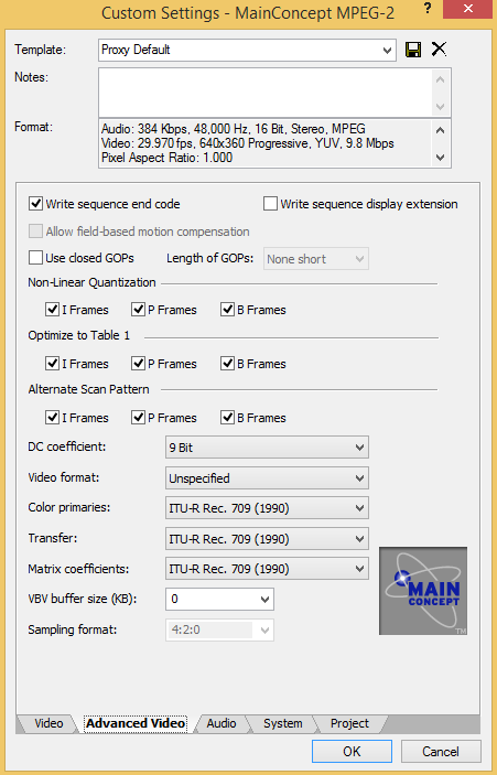

  11. Going back to settings:
    Should I leave the "Advanced video" settings as it is?
    I have only changed I-frames to 1 and B-franes to 0.
    Use closed GOPS is unchecked.
    Will do next time :P
  12. closed GOP is irrelevant with a GOP size of 1 (they are all closed) .
    But closed GOP's can help with long GOP proxies
    The other mpeg2 config settings won't matter for your purpose

  14. GOP settings are somewhat confusing.
    If I check closed GOPs a submenu asks for: None short, First short, All short.
    None short is set by default.
  15. Member Cornucopia's Avatar

    Also, it looks to me like you need to give your machine a break and stop running other processes when editing:
    From that picture, Dropbox, WinSearchIndexer, DesktopWinMgr, Greenshot, AdobeReader, poss. 2nd instance of Explorer shouldn't be running concurrently. There may be others that aren't showing up, too. Think Lean, mean fighting machine!

    Again, it's irrelevant with I-frame only. (GOP size of 1). That setting only applies with long GOP, so you can leave it (it does nothing with I-frame only)

    Thanks for the input Cornuccopia. So none short is short?

  19. Member Cornucopia's Avatar
    Didn't you just read what pdr just said? It doesn't matter for I-frame-only GOPs.
    IF you were NOT using I-frame-only GOPs, it would matter. And in that instance, what I believe that dropdown to mean is:
    1. All short = Every GOP in the media & sequence renders is a short GOP from start to finish.
    2. First short = Every GOP in each piece of media (and in each render of whatever sequence) STARTS with a short GOP and then defaults to "auto" or long after that.
    3. None short = Every GOP in the media & renders defaults to "auto" or long THROUGHOUT the entirety of each piece.
    But you're going to put that aside and listen to us, right?
