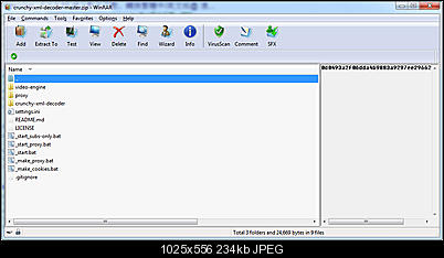

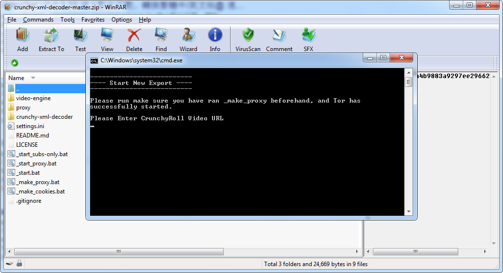

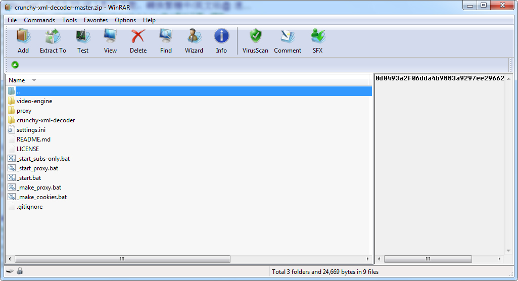

  9. I downloaded crunchy-xml-decorder, and it appears like this. Click image for larger version
ID:	28795 Click image for larger version
  10. Deceased
    Dec 2007
    Well, some batch file that is customized for downloading from crunchyroll won't work for soompitv. You'll have to do it manually for soompitv (or change the batch file).
