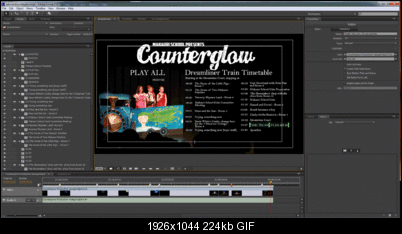

    Hi, I have being roped into to filming and editing our schools 2 hour production I have had so many problems I am about to say it is good enough but it bugs me I have spent so long and it won't go out how I would like, so search for an answer for someone who knows, cos I have no idea.

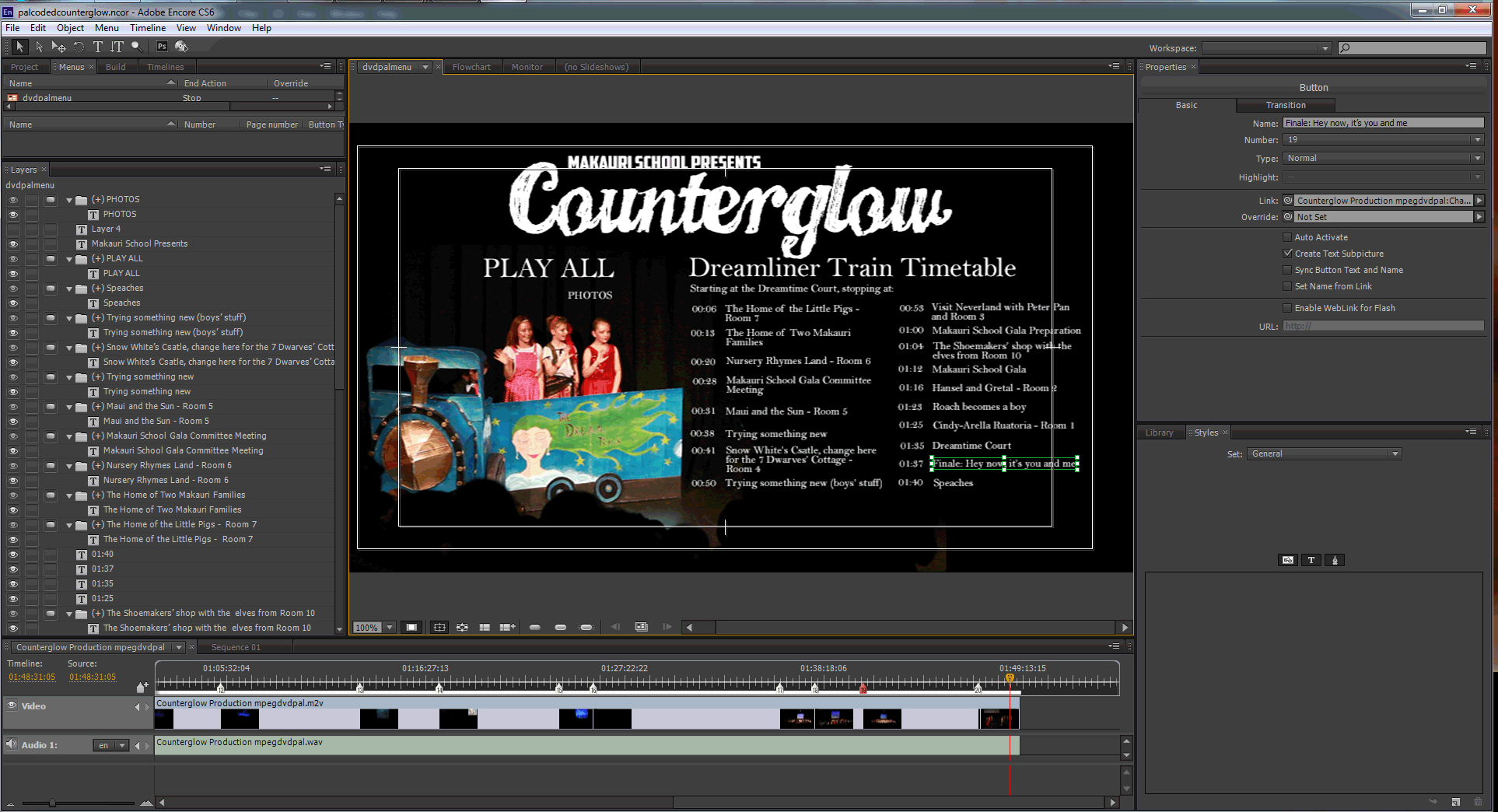

    In photoshop I have created a very basic menu with a background photo and text as layers for buttons for each scene with a play all and photos button. I imported it into encore cs6 set all the buttons up exactly the same (I chose the number order, normal type, only checked "create text subpicture") 19 buttons work perfectly but for some reason 3 buttons don't work on preview or on the dvd player, they are set up exactly the same. There numbers in the order are 19,20 and 21. You cant selected with a mouse or use the arrows to click on them in preview and on the remote it just doesn't move from the button it is currently highlighting. Any ideas, I have tired from scratch, deleting the layers and retyping them, playing with all the different buttons nothing works on the preview or dvd but it looks like its a button when you click on the show highlighted buttons. Hope someone has a clue what to do next as my final solution is going to be to deleted the button options that don't work.
    Thanks for your help.Click image for larger version
  2. Maybe because the max buttons you can have on a DVD menu is 18.

    As above.
    For a 4:3 dvd you can have IIRC 24 buttons.
    Looking at the menu, some content is outside the 'safe' area. Might not display properly on all equipment.
    But best to split your menu on to two pages and bring the content within the 'safe' area.

    Thanks I was worried it might be something like that but like the whole process I didn't know it - I should have visited sooner. I have made the last few scenes one button and that has solved the problem and edged in the text.
    It's 36 buttons actually.
    For an anamorphic 16:9 menu those 36 buttons need to be spread across at least 2 display modes, so the number of buttons one can use in the menu halves to 18. In case all 3 display modes are allowed for the menu (wide, Letterbox, Pan & Scan), only 12 buttons can be used (36/3=12).
