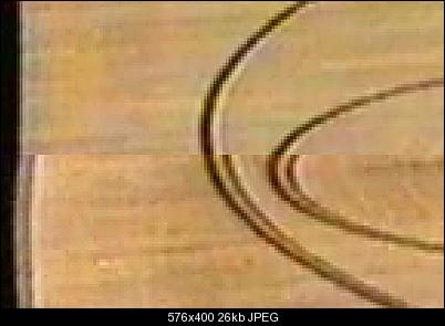

    Very bad stuff. The video is progressive, encoded as interlaced. That's not all: every frame is duplicated. At some point it was maybe field-blend deinterlaced ? ?
    To add to the grief, there was definitely no line tbc. Look at the left-hand border:
    Don't see much hope here.

    That's a shame. Color's not too bad (red is oversaturated a bit and starting to bloom. but you can't have everything). The bad ripples and jitter can't be repaired after caprture -- can be fixed only during tape play. Extensive field blending can't be repaired, either. Where the dupe frames came from is anyone's guess. Any idea about how this tape was captured ? (not that it would help at this point).

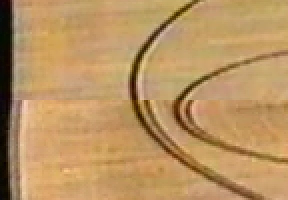

  10. The video was blend deinterlaced at some point. In addition, for much of the clip one field was shifted to the right by about 5 pixels before the blend deinterlace. That's what causing blending artifacts on stationary elements. I see no way of fixing that. In the top half of this 4x enlargement you can see the video before the field shift, the bottom after:
    You could fix the colors and reduce the noise but I don't think it's worth it.
