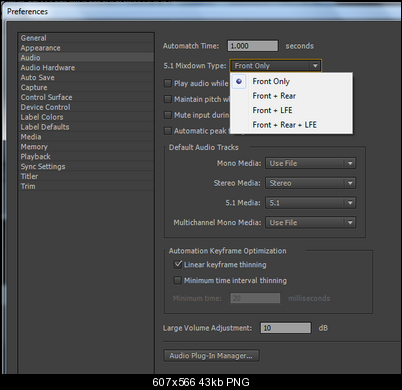

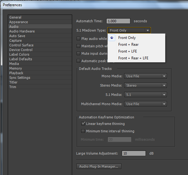

    i need to downmix 5.1 to stereo. but when i do this exported stereo audio sound is low. but when i extract all 6 channels from 5.1 audio and add them to 6 tracks and mix them to stereo sound level is not reduced. will it make any difference if i use multitrack(6 channels) mix to stereo? will it sound different from the original?

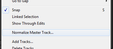

  4. Well, it has options:

    http://tv.adobe.com/watch/adobe-evangelists-paul-trani/normalizing-audio-for-the-whole-master-track/
    seems it does auto normalize. but i don't know how to stop it.

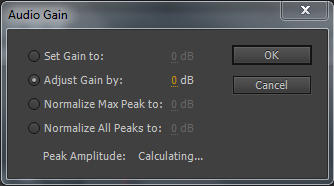

    and it has an option:

  5. Personally i would use: Front +Rear or even Front + Rear + LFE (i don't want to start discussion about LFE - i know is not recommended by Dolby).
    And i would set normalize Max Peak to -3dB.
  6. You probably want to normalise. If I had to guess, it's reducing the volume of the individual channels as it downmixes to stereo, so when they're combined, the peaks won't be louder than maximum and distort. That's normal, but to be absolutely safe, the volume needs to be reduced a fair bit. After the audio is downmixed to stereo, it's then "normalised" which adjusts the volume until the peaks are at maximum. Normally that'd increase the volume again by a reasonable amount. If it's not normalised after downmixing it wouldn't be unusual for the downmixed audio to be fairly low in volume.
    I'm still guessing, but looking at the bottom picture from your previous post, there's an option called "automatic peak......" Unfortunately it's not possible to read it all but I suspect that's the normalising option when downmixing and it'd probably be the one to check.
    As for the downmix type..... I don't use the program but the centre channel doesn't rate a mention. I guess it's always included when "front" is referred to, so you'd probably want to select the "front + rear + LFE" option to downmix all 5.1 channels to stereo. The LFE channel tends to be optional when downmixing (you could look at it as just adding extra bass) so "front + rear" would give you all the other channels without the LFE channel.
    The first "audio gain" picture in your post. It also has a normalising option but I suspect it normalises the original audio so it would have it's peaks at maximum, but if you're downmixing you probably only need to check the "automatic peak......" option. Hopefully that's a good guess. What does the "automatic peak......" option actually say when you can read it all?
    [Attachment 28739 - Click to enlarge]
    That's for creating a peak file for displaying the waveform and nothing to do with normalising, so you can ignore everything I said about that setting.
    Hopefully there's a "normalising" option somewhere which needs to be enabled. Have you tried the "normalise peaks" option from the previous pic you posted? (1st pic, post #4)
