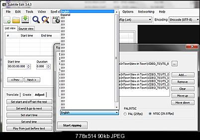

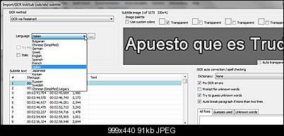

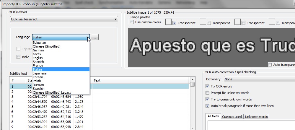

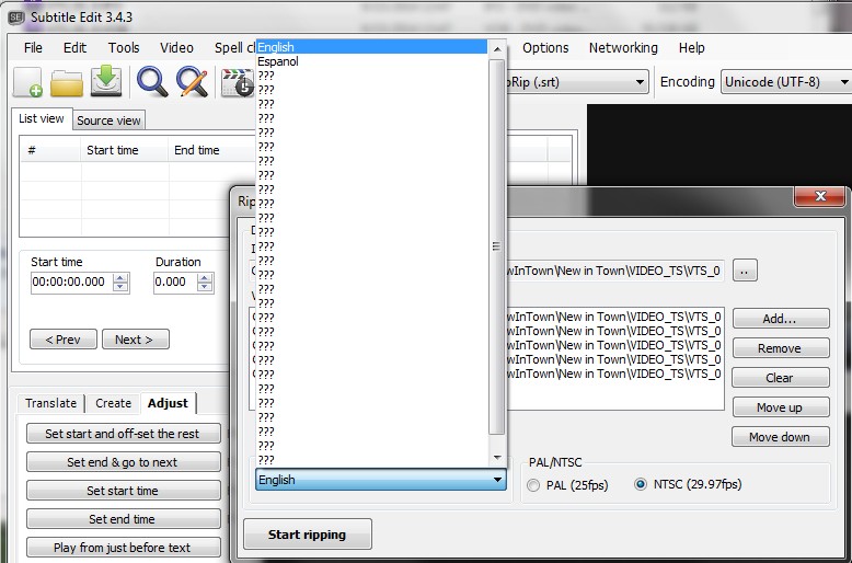

    Easiest way for me is to use Subtitle Edit and do an import OCR subtitles from VOB/IFO. Then select the IFO that is the same format as as the VOB's that contain multiple 1GB VOBs (usually the main video.) Click Start ripping and it will rip ALL the subtitles from the DVD after selecting the Language you want.
Name:	ScreenHunter_125 Nov. 18 23.22.jpg

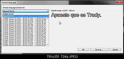

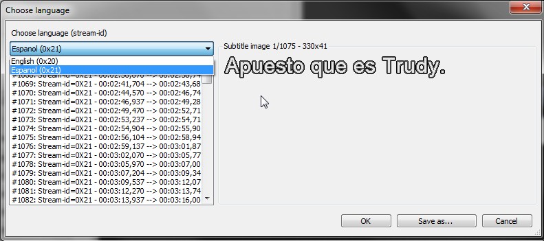

    Then select the language again on the next screen:
Name:	ScreenHunter_125 Nov. 18 23.23.jpg

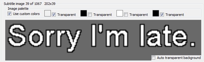

    Select your decoder language. If you do not have it, click the 3 dots and download it:
Name:	ScreenHunter_125 Nov. 18 23.24.jpg

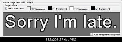

    Make sure you letters are white with black borders that do not intersect. If you have trouble decoding, check use custom colors and adjust/transparent until you do.

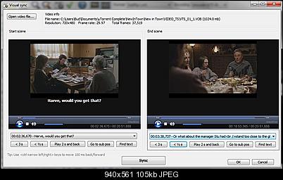

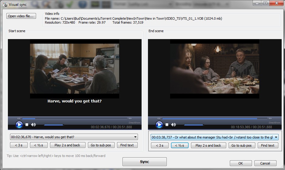

    once they are ripped, you can save as SRT from the main page. Subtitle edit has a lot of sync methods also but the one easiest is to load your COMBINED VOBS into the editor and use the Visual Sync to set the first and last subtitle and then let it sync.
Name:	ScreenHunter_125 Nov. 18 23.43.jpg

    In Subtitle Edit just drag-drop the .sup file from PGCDemux and it'll initiate OCR. (Budman1' image #2)

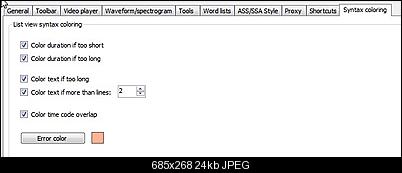

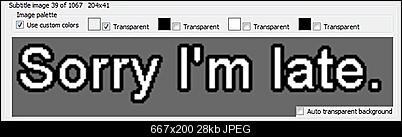

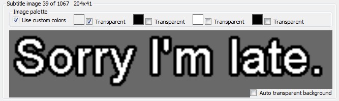

  10. Well it seems I fixed the problem by playing around with the tick boxes for image palette. For future reference how should these tick boxes be checked? Additionally, since I haven't used this program before, do the subtitles highlighted with yellow contain spelling errors?
    Thank you so much again manono, budman1, and videoburger for helping me out.

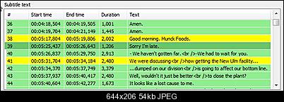

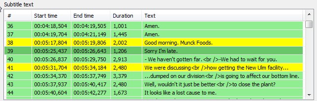

    harrybot, Most I know about the colors is yellow is spelling errors or at least unknown words that decoded correctly as in the following example. The Pink (red?) color is set in your settings and could be any pf the one checking in the settings.
Name:	ScreenHunter_131 Nov. 19 22.26.jpg
ID:	28672Click image for larger version

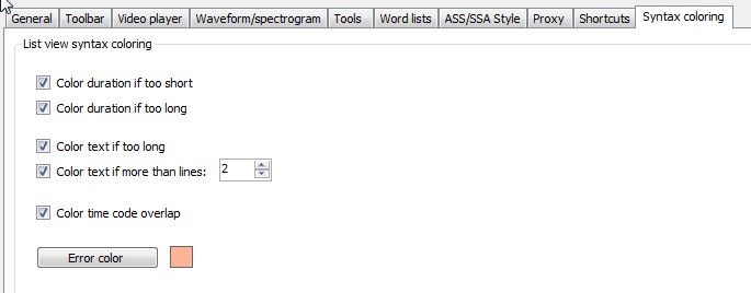

    As to the colors setting in the custom colors... I find white letters with black shadows and/or outline work best unless the shadow makes the letters blend together as in the example below. The boxes correspond to (at least my best guess) left to right are Background, Border(Outline), Letters themselves and then shadow. Notice I checked transparent for shadow because the letters blended together and they separate better.
Name:	ScreenHunter_130 Nov. 19 22.25.jpg
ID:	28674Click image for larger version
Name:	ScreenHunter_131 Nov. 19 22.25.jpg
    Hope that helps...
