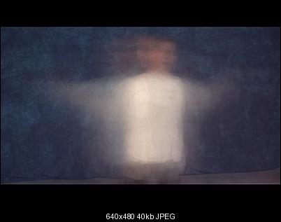

  1. Is it possible to superimpose every 5th frame of a video to a single photo using a batch process? Will FFMPEG do this?
    Thanks!
    Bob
    For example IF this photo was produced from a video? ...

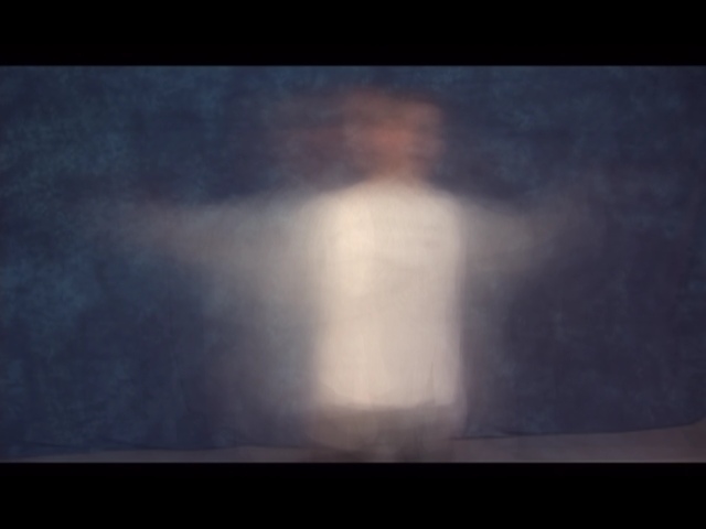

    e.g. here is a random hand waving tai chi clip from youtube, selecting every 5th frame
    https://www.youtube.com/watch?v=bNyNMz_Qs1s
    ffvideosource("Tai Chi Movements - Tai Chi- Wave Hands Like Clouds Tips - YouTube.mp4")
    selectevery(5,0)
    avgall2
    function AvgAll2(clip c) { c.FrameCount() <= 1 ? c : AvgAll2( Merge(c.SelectEven(),c.SelectOdd()) ) }

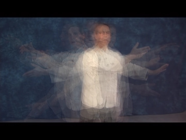

    There are many different ways of doing this, and you can get different types of looks - so if do a better job describing the desired end effect it would help
    e.g. less frequent samples - instead of every 5th frame, every 200th frame
