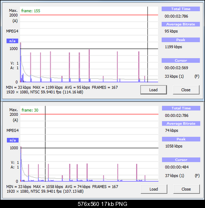

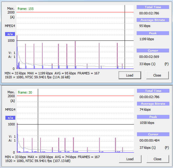

  9. Originally Posted by cheyrn View Post
    I know there is some type of compression that is based on not repeating pixels that are the same from one period to the next.
    All high compression codecs do this.
    With constant quantizer or CRF encooding content does make a difference. Big changes mean more bitrate is needed for those frames. More bitrate means more CPU power is required to decode. Two videos, both encoded at CRF 18:
    function blinkbig(int len)
      ColorBars(height=1080 , width=1920).AssumeFPS(60).Trim(0,-1)
      \ + ColorBars(height=1080, width=1920).AssumeFPS(60).Trim(1,len-1).Amplify(0.0).RGBAdjust(r=0.0, g=0.0, b=0.0)
    function blinksmall(int len)
      ColorBars(160,120).AddBorders(880,480,880,480).AssumeFPS(60).Trim(0,-1)
    Per frame bitrate from bitrate viewer, big on top, small on bottom:

    I attached files.
    I noticed this comment from ffmpeg:
    [mpeg4 @ 05600ac0] Video uses a non-standard and wasteful way to store B-frames
    ('packed B-frames'). Consider using a tool like VirtualDub or avidemux to fix it
    The strobe files were made with the blink function in the first avs script posted above. Stacks is made with the second. The point was that it has common data between frames. black has all common data between frames. Dot (ignore that it's not a dot) has fewer pixels than the strobe that change. They are also aligned vertically.
    So, the point is if the content is affecting playback, what about it and how I encoded it causes the problem.
