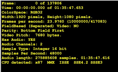

  22. DirectShowSource() may not be returning 23.976 fps -- put Return(Info()) right after DirectShowSource() and see what it says.
  23. Well, it says it's 23.976 fps.

  25. Member Cornucopia's Avatar
    Do you like the original audio? (while still in SbS) If so, you could just as easily extract it and remux with the converted video.
    Though I notice your pic shows a difference in audio vs. video length of ~1 1/2 frames (@23.976), audio being shorter. This could have been the result of the conversion from the rip. Depending upon choices made there, that could have resulted in "processing" of the audio, even if you didn't realize it.
    It would help if you showed ALL the details (by using [Debug | Advanced Mode])
