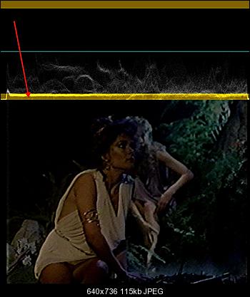

  1. So, on this batch of DVD-R's I'm cleaning up, the levels are just...way too dark. Like, max IRE of 200 type dark on first, maybe second, gen NTSC tapes. A simple levels readjustment just looks overblown, and a brightness adjustment looks crummy. I know you can't reclaim what's already been thrown out by a bad VCR and DVD-recorder, but there's gotta be a way to make it, well, watchable.
    On a different note, on some disks, there's a strange, almost tearing/slurping sound in the upper-midrange. I really don't know how to describe it. It's almost like bad noise-reduction or a really compressed MP3 file. It seems to come and go on different recordings. The source is pretty junky, being fairly well-loved SLP mono VHS tapes recorded in 1992 (8/5/92 to be exact: the transferring VCR, and presumably the recording VCR, shows the date of the recording-this was a Panny feature, right?). Taking off anything above 4k seems to reduce it, but it takes off a bit too much audio for my taste. Is this the tape, the deck, the DVD machine, or just my speakers?

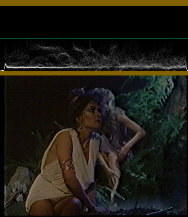

  2. RE: dark levels
    You need to work in YUV, and lift the Y values up or offset, and then perferentially boost shadows
    If you work in RGB, you will clip values Y <16 . You have to be careful about what software you are using
    The problem with making it "brighter" or boosting shadows, is it will reveal a lot of crap and compression noise - I'll leave that up to you to decide what to do with it
    This was done in avisynth . You still need to make some adjustments to color and noise but it will get you started
    levels(0,1,255,16,255,false)
    hdragc(max_gain=2, coef_sat=0.80)
    (is that an upskirt shot from the 80's ? )

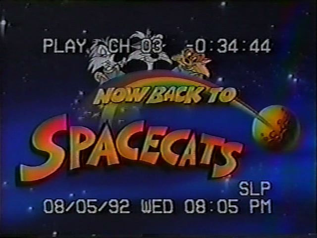

    Do you still have the original tape? This looks like it might have resulted from a bad analog signal chain. You might get better results using a different VCR, cables, capture card, or capture settings.
    Neither of these tapes are in my possession. The Spacecats thing comes from a bootleg DVD I'm cleaning for a friend of mine who collects that rare stuff, and the MTV comes from a Betamax tape that my cousin transferred over the summer (the original tape is currently in Oyster Bay, NY, quite a ways away). I was there to help him with the transfer, and it didn't look that bad on the TV (the chain was just a Sony Super-Beta deck plugged into a Toshiba DVD-Recorder, pretty similar to my own setup really-no maladjusted Proc Amps or TBC's). How it went from decent to murky just confuzzles me. His TV must have been really screwy!

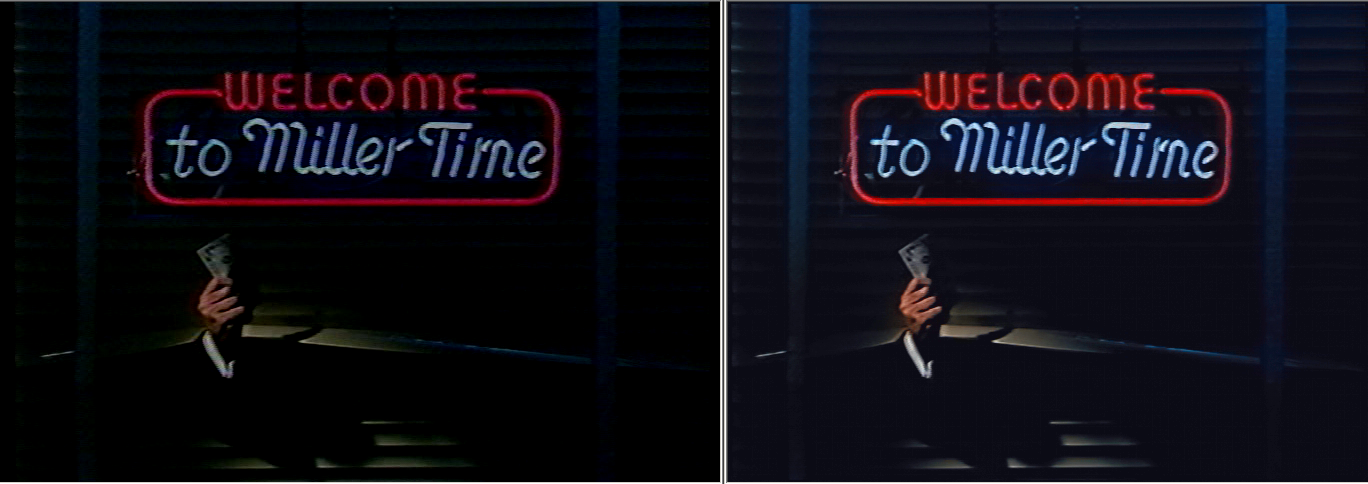

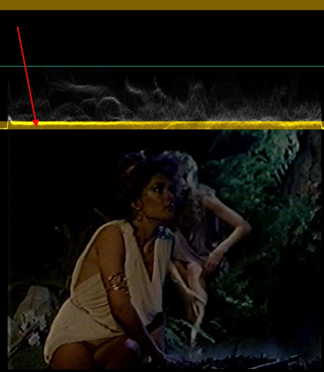

    The concept here is YUV to RGB conversions . IF you try to adjust the screenshot in your 1st post, it will be "impossible" to improve much, because the shadow detail has already been clipped (loss of data) from the YUV to RGB conversion for the screenshot . The screenshot is in RGB, our displays/monitors work in RGB
    The original MPEG, in YUV contains all the data that was originally recorded. What happens with a standard Rec601 conversion to RGB, is Y' 16-235 gets "mapped" to RGB 0,0,0 -255,255,255. Notice 0-15 , and 235-255 get cut off. Well that 0-15 happens to contain usable details in your mpg . You can illustrate this by looking at a Y waveform, or YC waveform in premiere . That area in bright yellow in the brown zone is 0-15 getting clipped. All values in that brown zone will get clipped (on both ends). Vegas gets around that by using "studio RGB". Essentially Y' 0-255 gets "mapped" to 0,0,0-255,255,255 , so that head and tail room are preserved, not clipped.
    The avisnyth code might be hard to understand, but it's analogous to levels in photoshop, or after effects, or premiere
    That 0,1,255,16,255 => that "16" is the output black level, so that would bring that clipped zone back up to "zero" or legal range. Then you can do whatever you want in RGB . If you look at say fast color corrector in premiere, you'll notice those numbers as well . So if you adjust output black by 16 with fast color corrector, you'll get the same effect in YUV
    So all you are doing is bringing that "illegal range" data, back in to "legal range" . You're shifting the values up. Here is the levels adjustment alone

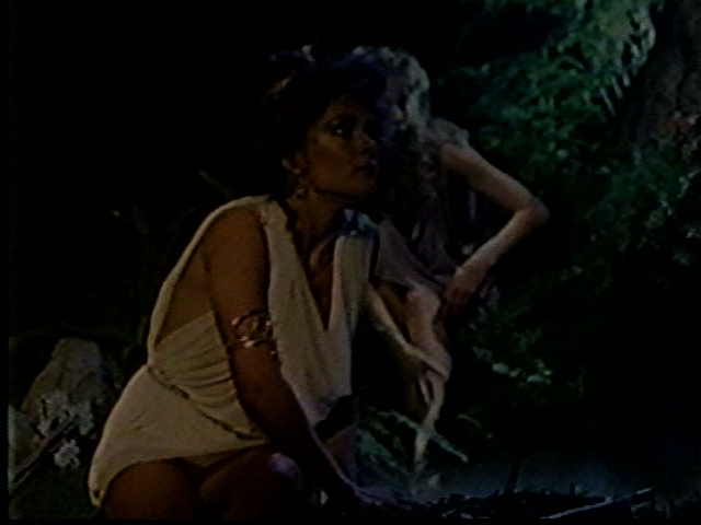

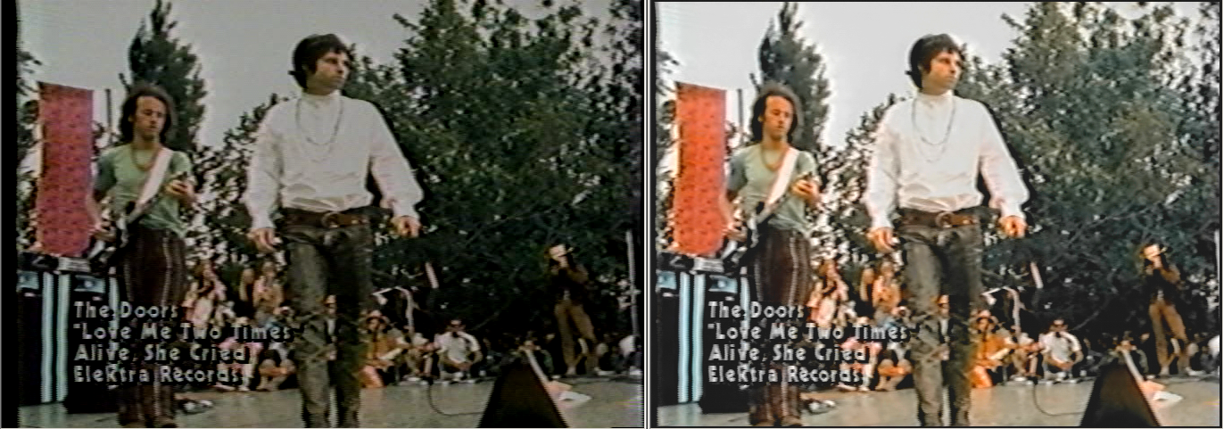

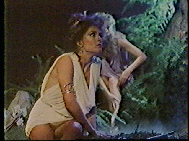

  15. So I tried it out in Vdub, and whaddya know there's something in the dark!
Name:	Screen Shot 2014-11-18 at 6.19.51 PM.png
Name:	Screen Shot 2014-11-18 at 6.05.10 PM.png

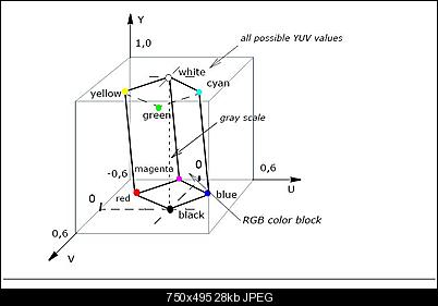

    By DEFINTION, an ITU Rec 601 or 709 conversion clips values
    Mapping 16-235 to RGB 0-255 means you clip values . If I were to map 0-255 to 0-255, there would be 1:1 mapping and no clipping

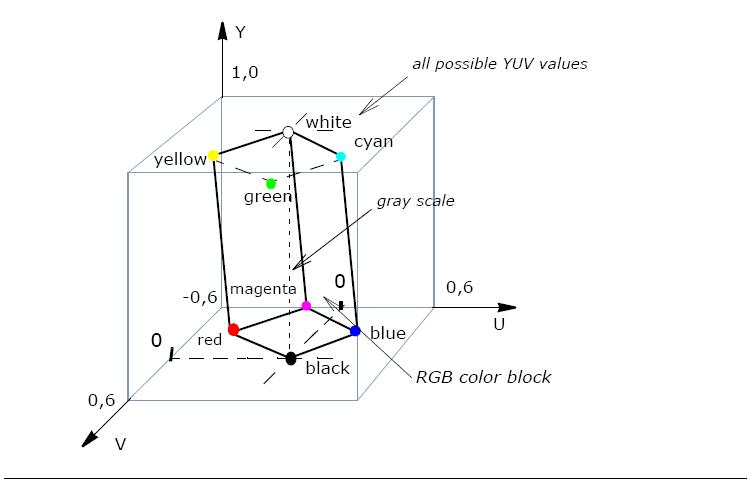

    There is loss in all 8,16, and 32 bit modes. ALWAYS. Why ? Because YUV <=> RGB transforms are lossy by definition. YUV is a larger colorspace model than RGB, and can hold more values than can be expressed by RGB color model. There are out of range and out of gamut colors that cannot be expressed in RGB . All RGB values can be expressed in YUV, but the reverse is NOT true. You can minimize the rounding losses when working at higher bit depths , but you still incur losses that are out of gamut.
    However, you are partially correct - In 32bit mode in premiere and AE is a special mode that does not clip right away , because it actually acceses YUV values before the RGB conversion . But strictly speaking, this is NOT an ITU Rec 601 /709 conversion in this mode . However - not all filters in PP/AE work in 32bit ! If you legalize in YUV first, you will never go wrong, in any mode.
