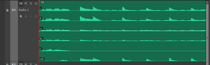

    adobe:
    this is how it must be:

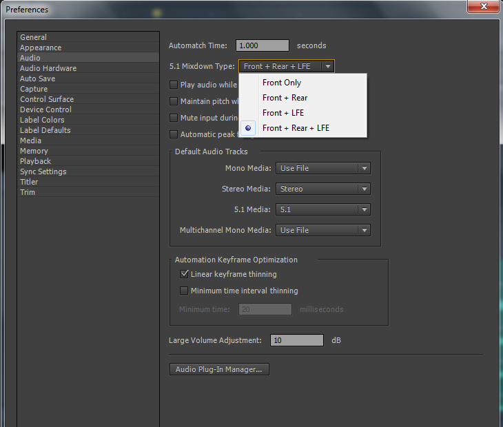

    and what should i choose on 5.1 mixdown type?:

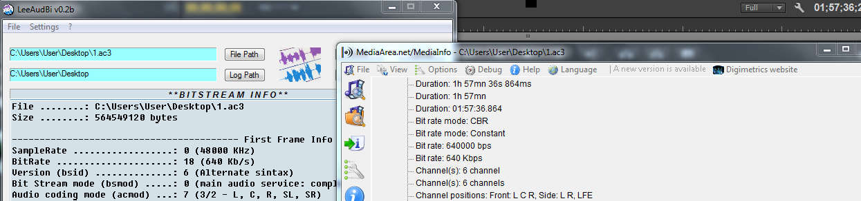

  2. Member Cornucopia's Avatar
    They're not mapped differently, they're just visually listed/arranged differently. All of those look to be the same: industry-standard 5.1 arrangement for AC3 coding.
    The nomenclature might be slightly different, though. Some apps explicitly mention the LFE's ".1" channel, some assume it. Some consider the surrounds to be side-firing, some consider them to be rear-firing. Only in this modern era where there is the possibility of side AND rear speakers (7.1 or greater) does that actually begin to need clarification.
    Your mixdown type ought to be determined by what system you physically have available at your disposal.
  3. Different formats use different channel mappings. Most programs (probably all) remap imported audio using the wav channel mapping. See the list of channel mappings at the bottom of this page. http://avisynth.nl/index.php/GetChannel
    Why Adobe Premiere Pro isn't displaying the channels in that order, I have no idea. I've never used it. As long as it's labelling them correctly though, the order in which they're displayed shouldn't matter.
    When you export audio, it should be remapped as required according to the output format. It's not something the user should normally need to think about.
    I don't understand the 5.1ch mixdown options.
    MediaInfo displays the same channel positions regardless of the format (AC3, DTS, AAC etc). I don't know why, but it doesn't display the real channel mapping.
  4. Member Cornucopia's Avatar
    All surround channel "mappings" are going to be out of SOME order if they're listed in a sequential order that doesn't visually represent their spatial positioning. But, it doesn't matter so long as they are actually MAPPED correctly. IOW, if the channel labelled LF is in the file where it is expected to be, and that signal shows up in LF's waveform slot and then gets rendered to the channel you expected LF to get assigned to, all is good.
    We've already had the discussion about channel ordering in file formats, hello_hello. I don't think we want to dredge that up again do we? I though we informally agreed to disagree.
    Again, MI is giving a casual listing, not a definitive ordering. It doesn't need to, because for any given format, that format is supposed to define how the ordering should be. You don't see MI getting literal with RGB or YUV color channel bitstream ordering either (for probably the same reason).

  8. as they are correctly mapped then no problem.
    but i want to understand what is this. what does 5.1 mixdown type actually mean? what you mean with front only?
    and i want it for internet. i mean stereo.
  9. It indicates when PP mixes down to stereo, what channels are used in the mix. If you pick Front only, then L + R are used only , the others are discarded
