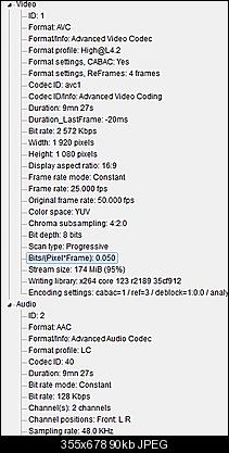

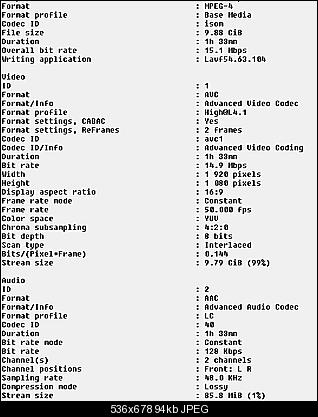

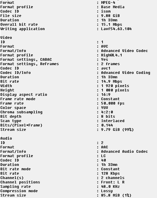

  1. I have captured 1080i video from Satellite HD Channels using AverMedia Game Capture HD II. I am in PAL region. The captured video is in H.264 format in MP4 container.
    MediaInfo says the video has 50 Fps and it is interlaced. Shouldn't it say 50 fields per second and 25 frames per second? Below is the MediaInfo of the original file captured.

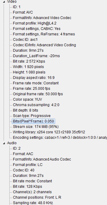

    When I converted the video to a lower bitrate using AviDemux, MediaInfo says the file is progressive with 25 Fps. Why was the source 50 Fps? I captured Hollywood movies. Below is the MediaInfo of the converted file.

    My other question is, the 'converted movie, despite showing as Progressive in MediaInfo, still has a lot of combing in fast moving scenes, on my progressive computer monitor. When I enable De-interlace in VLC, the combing is gone. Does it mean, AviDemux is not doing 'enough' de-interlacing while converting? What is the best strategy for me to edit the captured video (cuting out commercials), may be increase some brightness (I see many movies are low in brightness), and then converting to progressive video with a lower bitrate so that each movie fits in 1.5 GB or something? I want to use Freewares only, I hope it is possible. I am ready to use AviSynth if someone guides me, especialy, for an effective de-interlacing. Would I benefit from converting it to 720p as opposed to 1080p?
