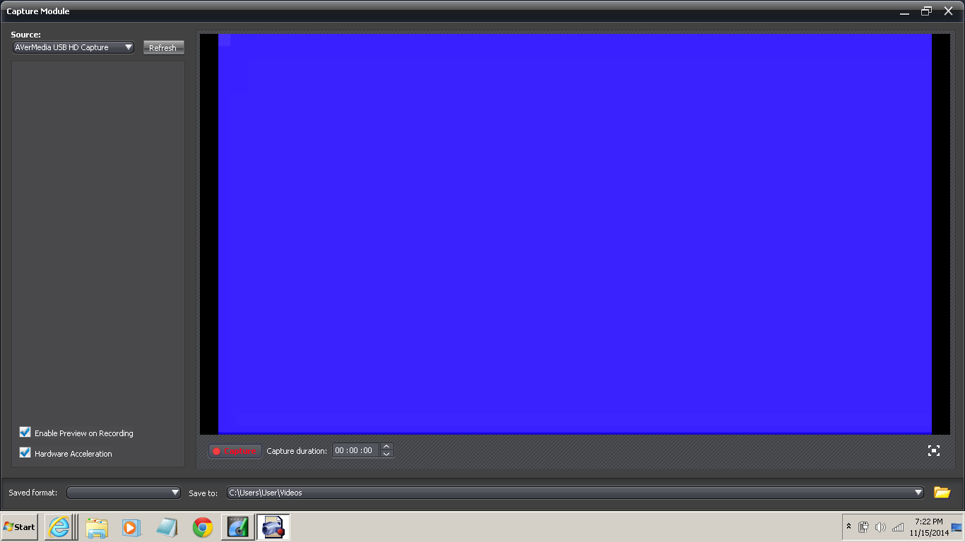

    Hello there,

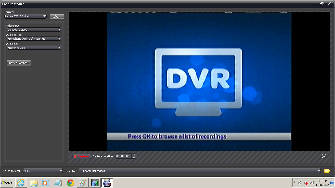

    I had to register a new account just to see if anyone can help me. I have an Avermedia USB HD DVR (C874) and have installed the latest version of TotalMedia Extreme 2 on my PC. However, whenever I want to record video on to my PC, I have a blue and/or black screen. What is worse is that I also have a Dazzle DVC100 (with corresponding software installed) and when I select the Dazzle on the TotalMedia Capture Module, it shows video and audio.
    I tried uninstalling and reinstalling the corresponding Avermedia software but to no avail. I also have screen captured images of the Module with blue/black screen and with the dazzle selection. Any and all help would be thankful.
Name:	DVR problem.png
Name:	DVR problem control.png
  2. As you can see from the pictures the dazzle has "composite" in selected and you have to "tell" the software to do the same for the aver media card ( maybe is tuned to svideo analog or YbPbr digital and you connected the source video to the composite so you get blue screen ( if it is analog some show noise some blue screen). Another thing that I can think off ( on the pictures) is that the avremedia card is not recognized by the software ( Total media one ) and it doesn't show the fields (settings changers ) that are there for dazzle but i don't see them on the avermedia screen. Did you try to see if another software can do or only this software? Maybe the software is not so good I don't have any experience with it so I cant comment on it.

    I have reconnected the composite cables towards the DVR and/or disconnected the dazzle, but still displayed the blue screen. When I turn on my PS3 (that is connected to the DVR), the blue screen turns into a black screen. I tried the DVR with the Pinnacle Studio with no success (no even a recogition). How can I have or tell the TotalMedia Extreme software to recognize the video/audio from the DVR or the DVR itself?
