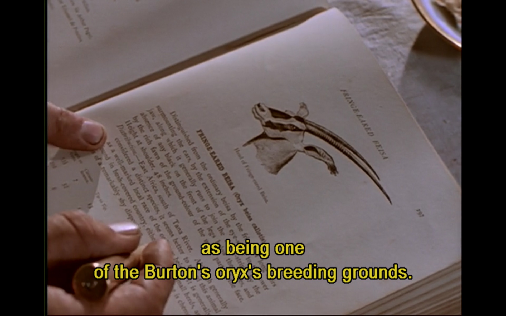

    Totally new to the encoding and handbrake scene.
    trying to encode my dvd ripped iso using handbrake to the modern x264 encoding mkv settings.
    My source is 720x480 mpeg-2 from the dvd iso.
    but what i noticed is this green band that appears on the left side of the video, which after a while will dissapear then reappear.
    I don't think it's telecine or interlaced (then again i'm nub so i'm not sure on that).
    Any ideas what it is and how do i get rid of it ?
    I tested a left crop 30 which seems to get rid of it, but i'm not sure if that is the right way to go about it, because it changed my resolution .... so wouldn't i lose detail ? also would look odd that one video was using a different reso from my other encodes for the same dvd that didn't have this issue
    here is the screenshot of the green band i mentioned
    https://forum.videohelp.com/images/imgfiles/swpaFu7.jpg

    Why is your jpg image 1920x1200? Where is the green band in the image? Is the thin light line on the left of the image what's left of the green band?

    We're not sure either. We don't know what your original video looks like. All we have to go by is an odd-sized jpg with a 1.6:1 aspect ratio.

    Thanks, but usually a capture of a video frame is preferred over screen shots.
    You should submit a few seconds of your original, unprocessed video rip or from an unaltered VOB file. You can do that easily and quickly with the free DGIndex utility. Here's a brief tutorial from a former member about how it's used: https://forum.videohelp.com/threads/359295-Record-without-interlacing?p=2272359&viewful...=1#post2272359

  4. Why is your jpg image 1920x1200? Where is the green band in the image? Is the thin light line on the left of the image what's left of the green band?
    yes that thin green line to the left. it shows up when playing the video in mpc-hc. not sure what that is but need to know how to get rid of it.
