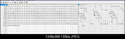

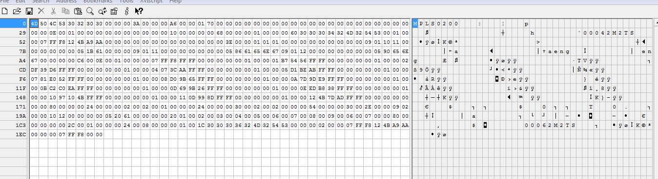

    Hello, use for example (XVI32) hex editor, open * .mpls main, inside BDMV / PLAYLIST, replace @ ASCII hex value (40) to hex ​​(50) ASCII p. This reverses the eyes.
    Based on the screenshot from the Edge of Tomorrow playlist, the quote makes no sense.
