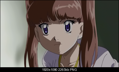

  1. I have a source that looks wierd and Ive only come across this once before.
    Can anyone suggest something to try in order to lessen or remove thes line across the picture?
  2. A general approach might be to try a vertical blur
    But what is the temporal relationship? Do the lines move? are they static ? Do they change in size or color ?

    Are you referring to the curved vertical lines in the left of the image? You've seen that many times, not just once. It's called banding. It's caused by over filtering, careless re-encoding, insufficient bitrate, etc.

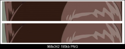

    You could try a mild high to mid frequency luminance noise suppression, like this:

    They are reduced, using noise suppression is always a tradeoff, you reduce too much and you influence other parts of the image.
    But I am sure that with all your criticism you have a much better idea!
    Before and After:

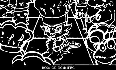

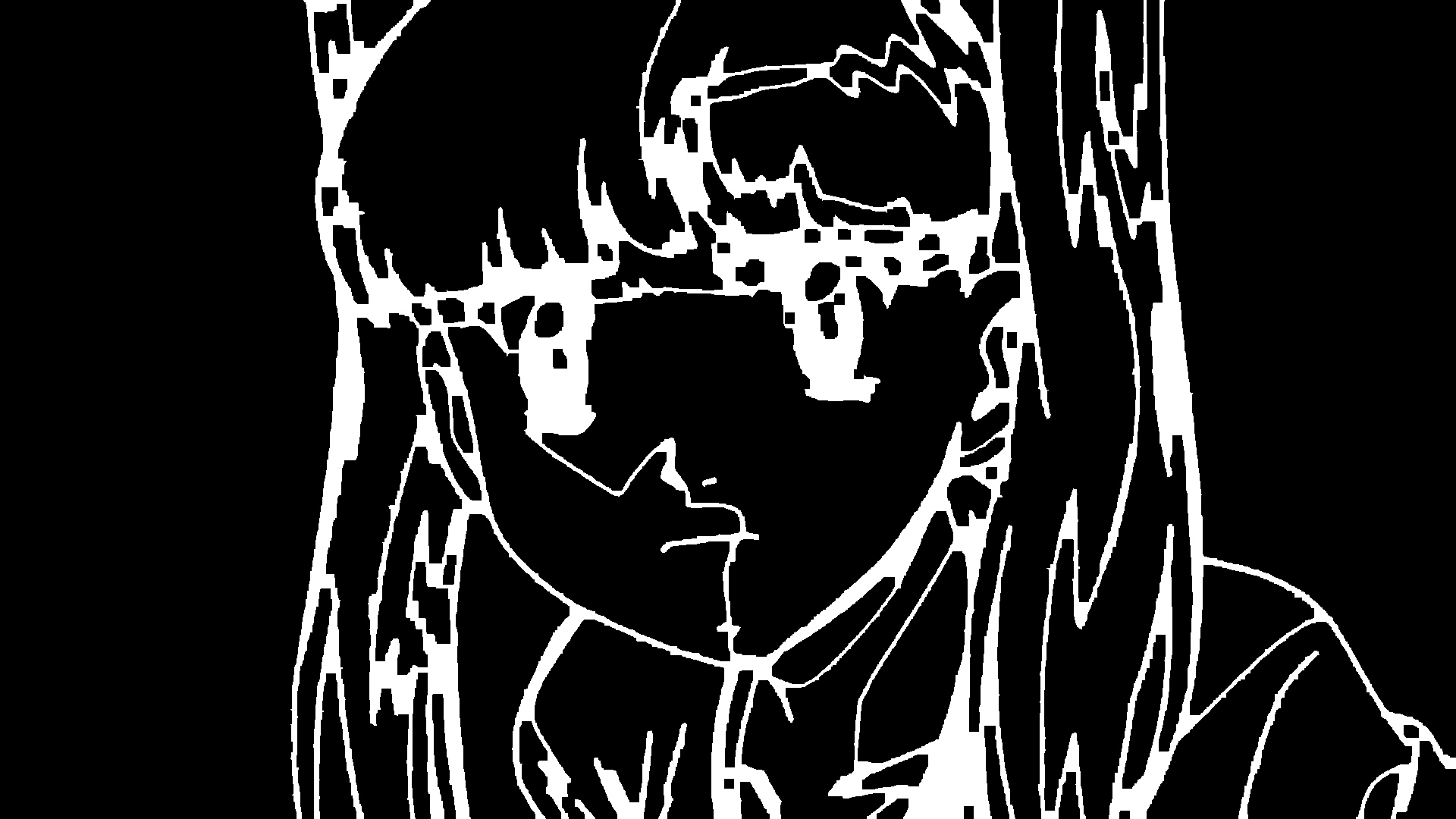

    Actually it's not too difficult in avisynth masktools to generate a cartoon line mask to protect the actual cartoon lines .
    eg. the base mask is just this
    o=last
    mt_hysteresis(o.mt_edge ("cartoon",thy1=8, thy2=10),o.mt_edge ("hprewitt")).mt_expand_multi(sw=6, sh=6).mt_inpand_multi(sw=6, sh=6)
    Here is the binarized version of it so you can visualize what is going on

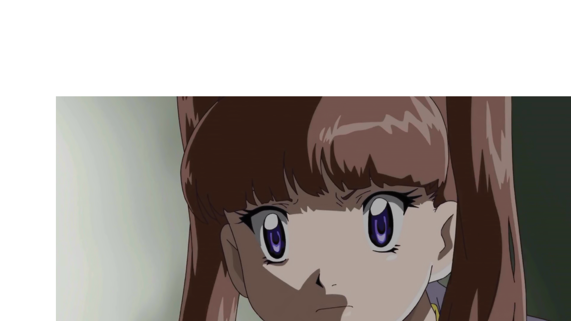

    You can combine it with other types of mask, refine it with various masktool operators etc..
    I did this a few days ago when I was patiently waiting for a reply to the question . It's heavily filtered with the line protection mask, and moderately dithered in preparation for encoding (you won't retain the dither unless you use dither retention settings or very high bitrates).

    BUT the actual problem is refining the mask so it works for the actual video across different scenes and scenarios . Often you'll have holes in the mask, or need other masks for coverage in different scenes. You want to do as less work and scripting as possible, but that involves some tradeoffs. The temporal characteristics of the artifacts and whether or not you are limited to spatial processing. Many things are not conveyed by a static screenshot, or a short description. I'll have a look at your video sample if I have time later, but I suspect you need to combine it with a shadow/luma mask to protect shadow detail in some of the other shots (or just set a generic threshold for the shadow mask across all scenes)

  21. I won't have time to look at it this week in detail.
    But a quick look tells me you're going to have problems with using a cartoon based edge mask alone. Because you're going to be using strong filters in Y, U and V to get rid of the horizontal lines , there are a lot of shadow areas which will get destroyed unless you protect them with a shadow/luma mask (e.g. even in the first few frames) . In the other section with smoke, that will get killed and since it's neither dark, nor lines, (it's "grey") it's difficult to isolate with masks in avisynth, maybe a saturation mask. If you want a great job, you're going to have to use different masks / different settings on different sections . If you want an OK job, you're going to have to make tradeoffs

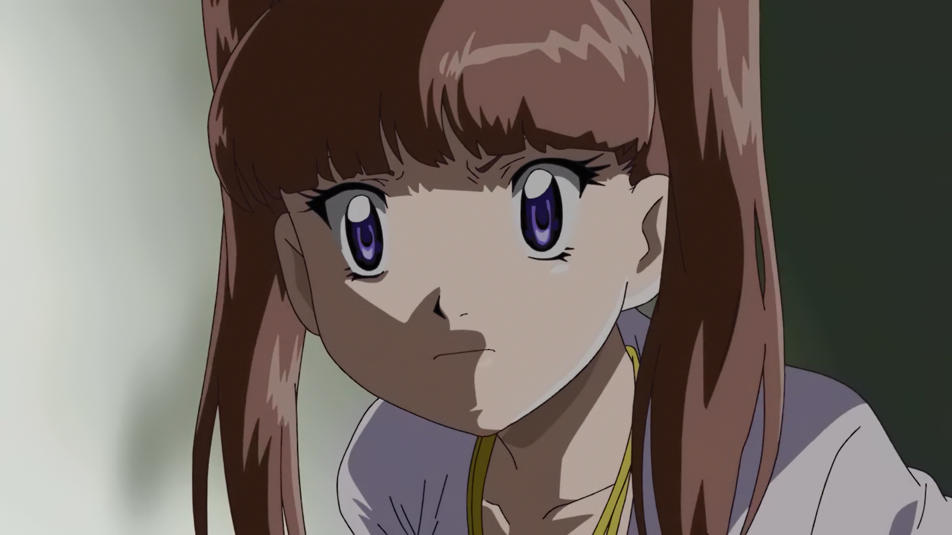

    a = ffvideosource("D:\Ins\Digimon Fusion Preview-002\Digimon Fusion Preview-002.mkv").addborders(0,0,0,8)
    a
    LSFMOD()
    spline36resize(a.width * 3, a.height)
    deen("a2d")
    flash3kyuu_deband()
    deen("a2d")
    flash3kyuu_deband()
    deen("a2d")
    flash3kyuu_deband()
    fft3dfilter(bt = 1, bw = 32, bh = 64, ow = 16, oh = 32, sigma=2)
    spline36resize(a.width, a.height)
    LSFMOD()
    flash3kyuu_deband()
    That kind of works, although I'm not sure it's any better than newballs and I'm not sure all of those lines are necessary. Some of the lines are rather indistinct and they're the first to go. The black lines around the center animal's watch in the first frame and his mouth are prime examples, they're more blurs than actual lines and are vulnerable to denoisers. Even PDR's script misses them entirely.
    Hopefully it will give someone more sensible some ideas.
  23. Originally Posted by ndjamena View Post

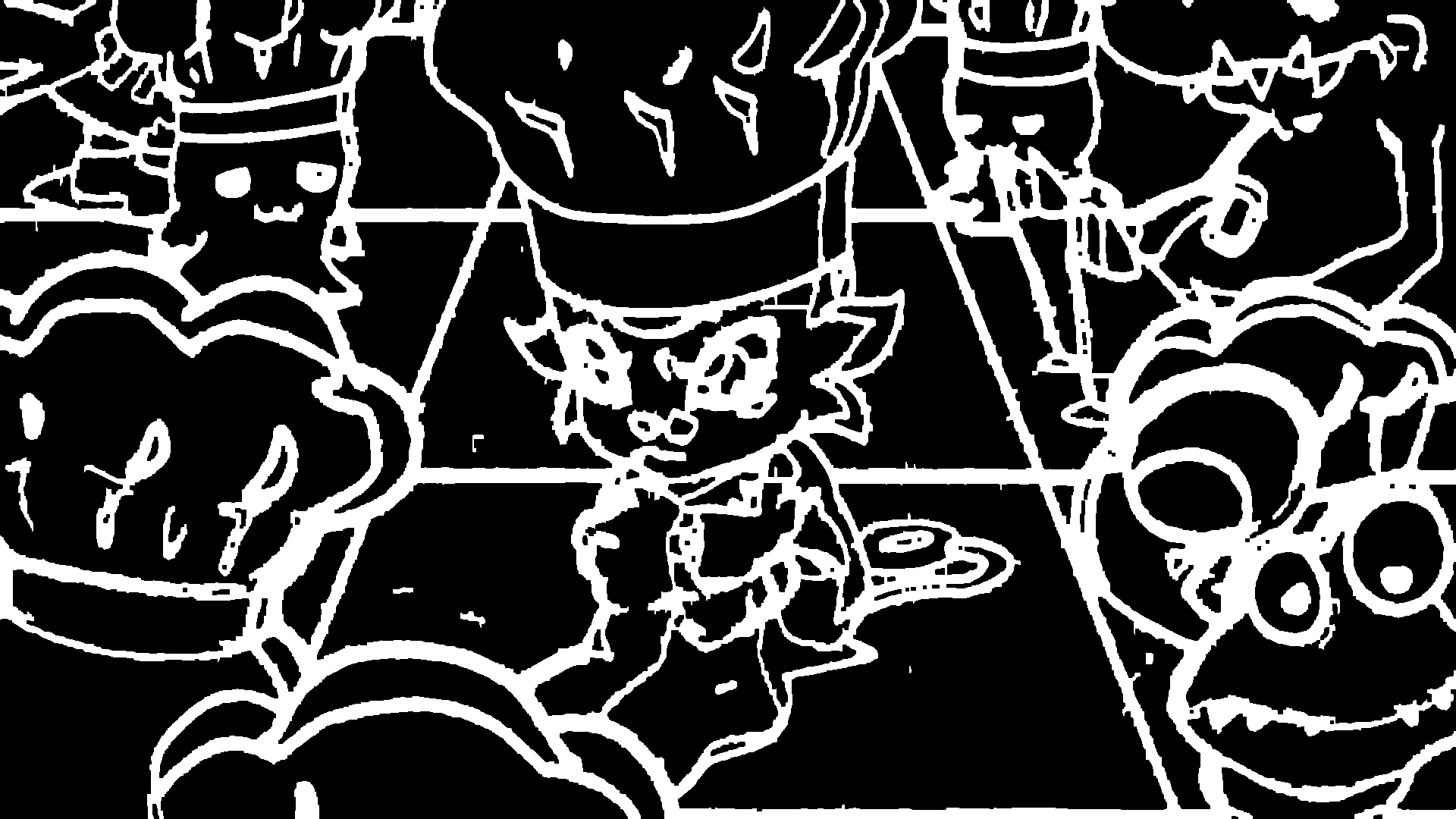

    That "base mask" was intended for that 1st screenshot. I didn't have access to the video at the time
    Obviously you have adjust the mask to fit the video. As you alluded to, especially with cartoons, one of most common problem scenarios are "dark scenes." The problem is lines are "dark" , and shadows are "dark" as well - therefore you get no separation. And commonly used denoisers usually destroy shadow detail, thus the lines there as well. So the usual techniques use are some combination of:
    a) either adjust the thresholds lower (detect more lines)
    b) create separation by prefiltering (e.g. brighten the scene and boost and increase shadow contrast, just for the mask creation)
    c) combine masks using masktools operators , use different types of masks , not just edgemasks e.g. combine a luma mask with the cartoon line mask; or use a saturation mask (lines are often low saturation, compared to flat colored areas) . You can use operators like "OR" or "AND" or "ANDN" to refine and include or exclude regions with mt_logic
    Here is an example of prefiltering for the mask by using (b), brightening shadows . This will cover the dude in the middle. This works ok on the other scene with the girl too. You have to examine the other scenes to see if it's appropriate, or make adjustments . I don't have time to fiddle with this right now. Trying to do everything with 1 mask will invariably be worse, but it's less work than making a mask per scene
    o=last
    pre=o.hdragc(coef_gain=2).blur(0,1.5).deen(mode="c2d", rad=1, thry=2)
    m1=mt_hysteresis (pre.mt_edge("cartoon", thy1=6, thy2=10),pre.mt_edge ("hprewitt", thy1=8, thy2=10)).mt_expand_multi(sw=2, sh=4).mt_inpand_multi(sw=2, sh=2)
    m1
    There are stray pixels , and you miss some (e.g. green guy's nostrils in the corner are difficult to separate because of the blur in the original), but this is typical for avisynth type masks - they aren't perfect
