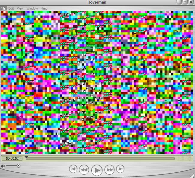

    I was able to rename it to .dv but when it plays, it's all jibberish. It does the same thing in vlc and quicktime. Screenshot is of the video player. This one is QuicktimeImage

    VLC log gives me this:
    avcodec warning: cannot decode one frame (120000 bytes)
  6. Looks like the file is corrupt. You might be able to restore some of it with VirtualDub.
