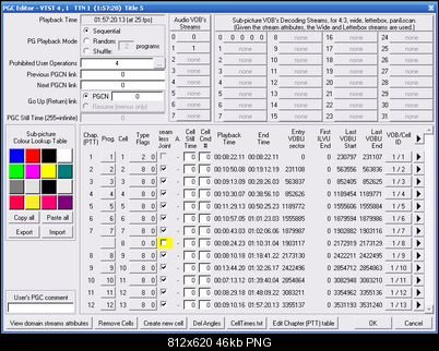

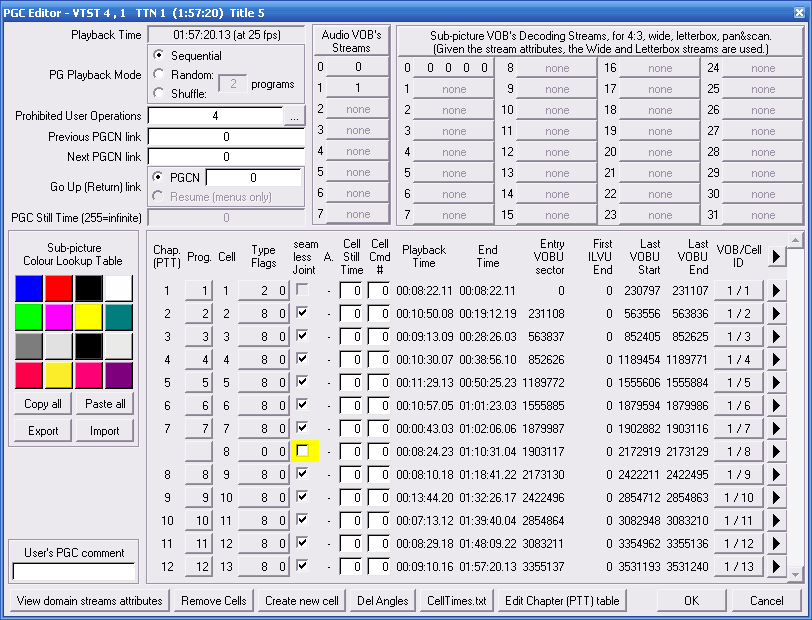

    Originally Posted by jman98 View Post
    To be honest, it might be somewhat difficult to accurately determine the previous layer break location after a rip has been done (I have no idea whether this is true or not - just suggesting it)
    If the layer break is in the middle of a Titleset (which it is most of the time), you can tell the position by looking at the Seamless flag of the Cells in PgcEdit. Per standard a layer break is non-seamless (however, it can be seamless also, see below), so the flag is missing – PgcEdit will mark it yellow. Also, often there is no chapter point at the layer break (same program, just a Cell split in two).
    Like this for example. Layer break is at the end of Cell 7 and Cell 8 is the first Cell on the second layer.
Name:	Layer Break.PNG
    By the way, I have never experienced any trouble by setting Seamless flag at the layer break anyway – actually this completely removes any pause between the layers on all my players and it's widely recommended.
