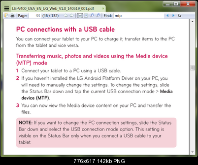

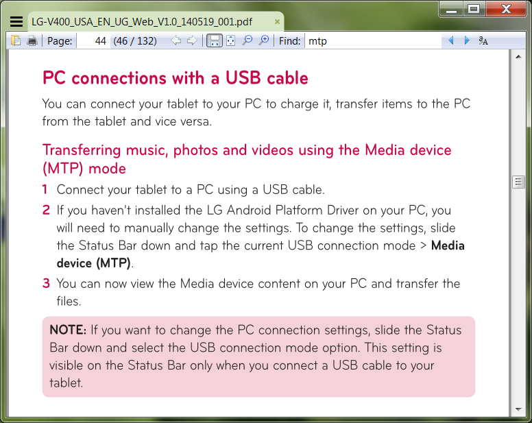

  10. Originally Posted by vhelp View Post
    regarding the notification, mine must be different from yours posted because my notification display completely different things, and nothing to do with usb anything.
    From LG G pad 7.0 User Manual:
