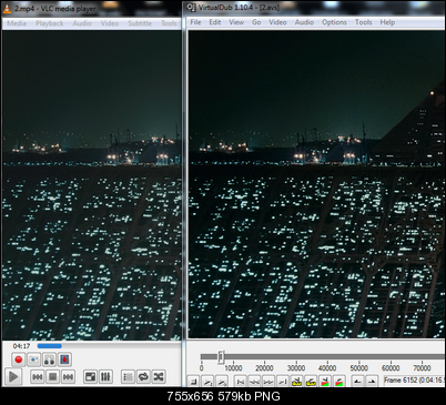

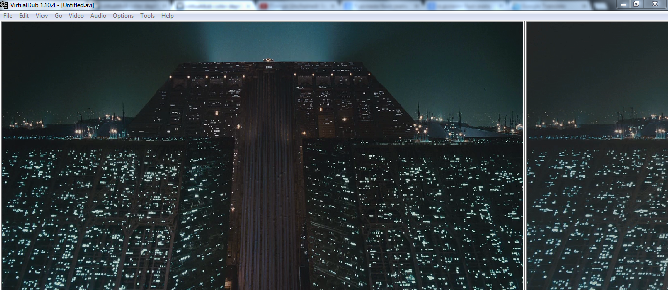

  1. when i import 2.mp4 to sony vegas its color same as vlc. how to fix this on virtualdub? Click image for larger version

  2. Add the Alias Video filter. You probably want rec.709 and Full (0-255).
  3. Member Cornucopia's Avatar
    Notice you said "import mp4". That is your answer: Vdub does NOT open mp4 directly, it uses an input plugin. That plugin is changing things. So, change your plugin to something that doesn't, or correct/compensate for how it's changing (you could use a histogram & waveform monitor to figure it out).
    Just a guess, but it looks like Constrained vs. Full RGB levels (after colorspace conversion from Y'CbCr).
    ...doh! jagabo beat me to it.
  4. Originally Posted by jagabo View Post
    will it be original color depth then? i did and it worked. but i am not sure if it is same as the source color depth. And what rec.709 and Full (0-255) mean? are these settings for original color depth of any kind of hd video?

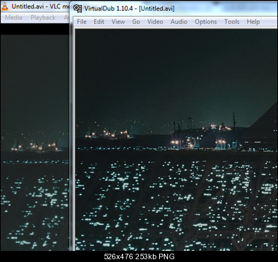

    same thing on avi without alias filter:

  5. Video normally uses limited range luminance levels (16-235). PCs use full range levels (0-255). For video to display correctly on a PC monitor the limited levels need to be expanded to full range otherwise it can look "washed out". For normal video "16" is black, but for a PC "0" is black, which means "16" will display as dark grey on a PC monitor.
    I suspect in your case VirtualDub is correct and the other programs are not. I have my video card set to expand the video levels so they're always correct regardless of the player used, but as a quick test I disabled that setting and opened an AVI with VirtualDub. The video still displayed correctly (levels expanded). I opened the same video in VLC and it looked like it had less contrast, so VLC doesn't expand the levels by default (whether it does may depend on the renderer being used). VLC may have a setting.... I don't know, I rarely use it. After I reset my video card to expand the levels once more, the video looked fine again in VLC too.
    For Nvidia, the setting is in the Nvidia control panel under "adjust video colour settings". Selecting "with Nvidia settings" and then "full (0-255)" from the from down list expands the video levels. Other cards have a similar option somewhere.
    Not that it should matter unless you need to adjust the colours and therefore need to preview the video accurately, because it shouldn't effect the levels used for encoding, just for previewing.
    The above applies when converting video to RGB for display on playback. It can also apply when re-encoding if the video is being converted to RGB in the process (some VirtualDub filtering maybe?), but even if it is, normally the limited range video would be automatically converted to full range RGB and then back to limited range when it's encoded. Not all programs follow the same rules though....
    There's also different "formulas" for converting the colours to RGB on playback which produce slightly different results. Standard definition uses rec.601 and high definition uses rec.709. If the wrong one is used for converting to RGB on playback, the colours can look a little "off". Some programs (Avsynth, VirtualDub etc) default to rec.601 if video is being converted to RGB during the encoding process. That's okay even if it's HD as long as it's converted to RGB using rec.601, filtered, and then converted back to YUV using rec.601 for encoding. It's a whole other topic really.....

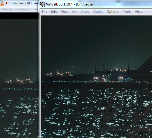

    even after i change nvidia to Full (0-255) there is a little difference:
    why you players can't show the original color?!

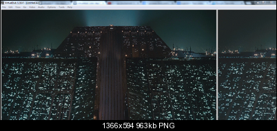

    and why in virtualdub when i set Alias Video filter to rec.709 and Full (0-255) it goes grey dark?
    all i want is to compress video at original color in virtualdub.
    They look the same to me, I think, although maybe they're resized a bit differently? It's hard to tell.
    You could check the display setting in Virtualdub's preferences, but other than that, I'm not sure. Maybe VLC is doing something to the video. Are any of it's filters enabled?
    I've no idea. I don't use VirtualDub much and I had no idea the Alias filter existed. The info for it says, "re-label video with a different colour space or colour encoding without changing video data" which seems like it's a way of writing the info but maybe it doesn't actually change the levels or colours. I don't know, but that's the way I read it.....
