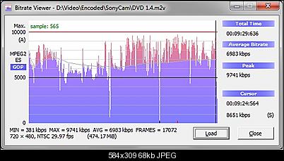

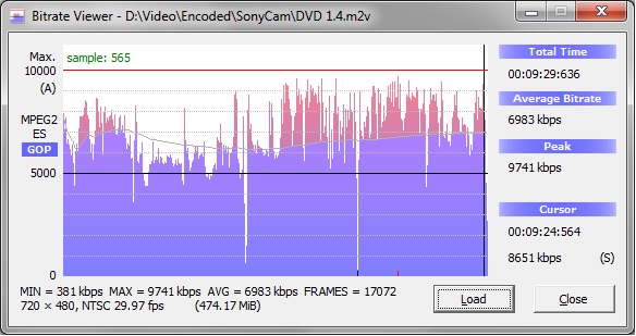

  1. This has probably been rehashed before, so my apologies if I am bringing up a beaten, dead horse. Here is my understanding of DVD bit rates:
    Max Rate: 10.08 Mbps
    Headroom: -0.4 Mbps
    Audio (5.1 or 2 channel stereo): -0.384 Mbps
    Peak Data Rate for Video on DVD: 8.912 Mbps
    Now if I have a DV-AVI file that averages 29 Mbps then some serious compression is needed, on the order of 2/3. In PPro if I use MPEG-2 VBR 2-pass, I get a little worried because in the following example the peak rate exceeds 8.912 Mbps by quite a margin while the average is a low 7 Mbps. Probably just a testament to AME, but none-the-less, VBR seems like a lost puppy.

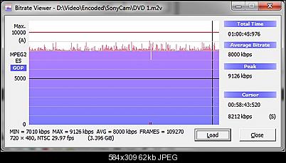

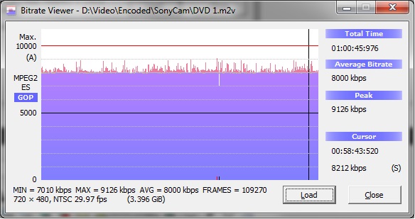

    However, if I choose MPEG-2 CBR with a target rate of 8 Mbps then the peak is a more reasonable 9.1 Mbps.

  2. For short videos you might as well use CBR near the max bitrate that's legal for DVD. But with long videos you need to use a lower average bitrate. Using VBR lets the encoder use bitrates higher than the average for shots that need it and lower bitrates for shots that don't.
    Say you had a two hour video that consisted of a black screen for an hour and high action video for an hour, requiring an average bitrate of 4000 kbps. VBR allows the encoder to use hardly any bitrate for the first hour then give the last hour nearly 8000 kbps (in the end averaging 4000 kbps). Encoding with CBR would waste 4000 kbps on the first hour and the second hour would be starved of bitrate. The second hour of the CBR encoding would have inferior picture quality.

    I kind of agree as well about CBR for short videos to fill a disc and VBR for longer ones. But I feel it should be pointed out that his first VBR encode is perfectly fine since he has the figure wrong for the max allowable bitrate. It's 9.8 Mbps and his first encode maxes out at below that. And I don't know where he dug up that audio figure.

    I think I understand the philosophy now. When dealing with long movies (>1 hour) the movie may not fit on the DVD at a reasonable bit rate unless VBR is used which allocates more bit rate for complex scenes while conserving bit rate for less complex scenes. CBR makes no provisioning and will potentially waste bandwidth on less complex scenes, but this is of no concern if the video is short duration.
    In summary, I wanted to understand this better because VBR 2-pass takes so long compared to CBR. And for the amount of DVDs I need to encode (about 50), I think I am happier with keeping the DVD length to within an hour and using CBR. A target rate of 9 Mbps sounds like the sweet spot.
