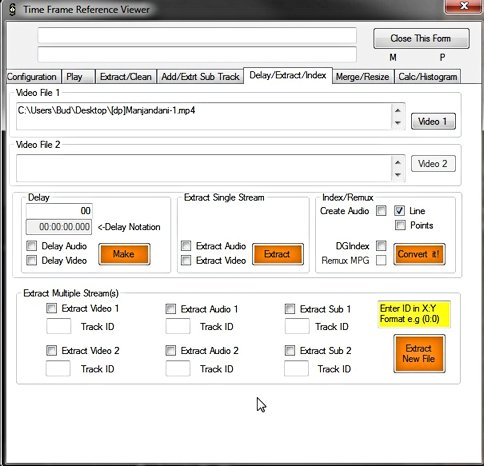

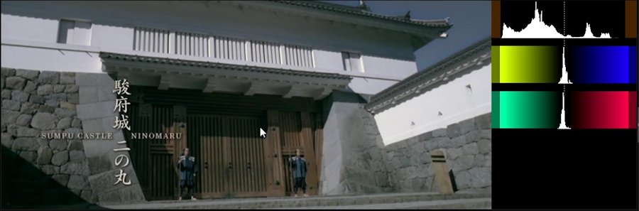

    The GUI shown in the images is my GUI I am writing, and yes it will split, join, merge, crop, pad, play, preview, sync (visually or audibly), resize, deblock, blur, color adjust(increase/decrease), and more. It is a work in progress so I correct and change as needed when I encounter a problem.
    Document (DOCX) for some of the features is at https://files.secureserver.net/0s1H0CP5f5WZAc
    You are right in that some Mpeg and MP4 will join one way while other formats and combinations like MP4(video,audio,subtitle) will not so I built in these filters. The combining problem of MP4's was a problem several of my friends had as they tried to Join their 'LEGAL' digital versions of movies that were on a 2 sided DVD. I added this feature for that reason.
    The bottom line is the method I suggested works and that is what you asked for. If you have other movie formats or wish to do several at a time then the method must be more complicated or written specifically for that.
    All the methods suggested above well beautifully in some instances but cause unwanted problems (as does mine) in other situations such as recoding (if you do not wish), changing formats (if you do not want), wrong aspect (if program specifics set wrong). etc.
    I am hoping my utility when completely stable will handle generic uses that can be accomplished by clicking the Exceute button in the right hand pane of my example) or you can change the ffmpeg parameters if you are familiar in the upper window of the right hand panel. This will allow for using and just requesting a modification if problems arise.
    Anyway, I'm getting long winded from all the Thanksgiving Turkey I ate but the command line will work for what you wanted to do. I use my utility now to arrive at the correct command line that works for most of my uses.

    UPDATE: Just tried WMV!/2 and WMA1/2 WMV videos and they join with the command line/Text file I suggested earlier. They MUST be complete files formatted correctly. As mentioned earlier, if it is a clip that is just cut out without rebuilding, it most likely will need reencoded first.

    In case anyone is interested, These are the results of my merges both with ffmpeg and the CMD /b copy method and the results I obtained. Most files were using the AVC video and AAC audio codec except for the MPEG type files that used MPEG2 video and mp2 audio.
    MKV ffmpeg=joins ok but first subtitle
    MKV copy /b = 2 complete movies but time says only one and plays one
    MP4 ffmpeg = joins but loses DVBsubs and srt subs
    MP4 copy /b= 2 complete movies but time says only one and plays one
    VOB FFmpeg = multiple errors trying to join and aborts
    VOB /b works and carries over the DVD subtitles
    3GP ffmpeg=joins/ plays fine ... Subtitles ??????
    3GP copy /b = 2 complete movies but time says only one and plays one
    FLAC ffmpeg= Multiple errors during conversion. Fails (possible bad Flac file to begin with?)
    FLAC copy /b = 2 complete movies but time says only one and plays one
    MPG ffmpeg=joins/ plays fine. Gives correct time and size. Subtitles ??????
    MPG copy /b = Seems to play ok but Time and size is given as only one video.
    M2V = Same as MPG
    M2V /b copy = Same as MPG
    Will post update when I join M2TS from Blu-ray.
