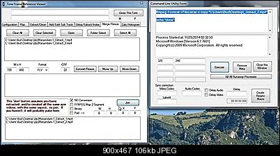

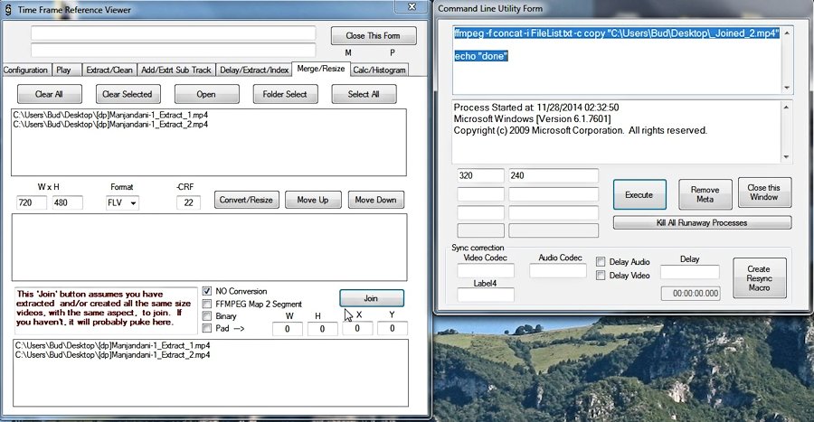

  27. Member Budman1's Avatar
    Jul 2012
    NORTHWEST ILLINOIS, USA
    Just had occasion to do this (add mp4's together) and found that if you use the Binary method to join (copy /b video.ext + video2.ext output.ext) you will get a video that has 2 mdat,2 moov, etc. This result may play in some but not all players and some streaming Servers like Plex wil stop after the first video plays.
    What does work is if you join with FFMPEG type editors.
    This video will have 1 Mdat and 1 Moov atoms with 2 trak atoms that will play on most if not all players/Servers. FFMPEG is fairly easy to use and requires no installation and since you have a 'Few' to join it should work well for this.
    UPDATE: EXAMPLE WRONG WILL POST CORRECT LATER... SORRY about that.
    Correct method would be to be sure only video/audio present and use the concat method with file list. Make a text file with a file similar to this and give it a name such as Filelist.txt:
    file 'C:\Users\Bud\Desktop\[dp]Manjandani-1_Extract_1.mp4'
    file 'C:\Users\Bud\Desktop\[dp]Manjandani-1_Extract_2.mp4'
    Then concat with:
    ffmpeg -f concat -i FileList.txt -c copy "C:\Users\Bud\Desktop\_Joined_2.mp4"
Name:	ScreenHunter_131 Nov. 28 02.33.jpg
  28. Hi Budman1 ,
    Thanks . The commands-line works .
    Regards .
  29. Wich Gui for ffmpeg program did you use to make those screenshots ?
    Do you have the syntax for splitting any video file ?
    I splitted a wmv video file in 2 files, then I joined with ffmpeg, but the video can't play on MPC. Nevertheless, I can play it on WMP and VLC. Why ?
