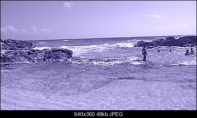

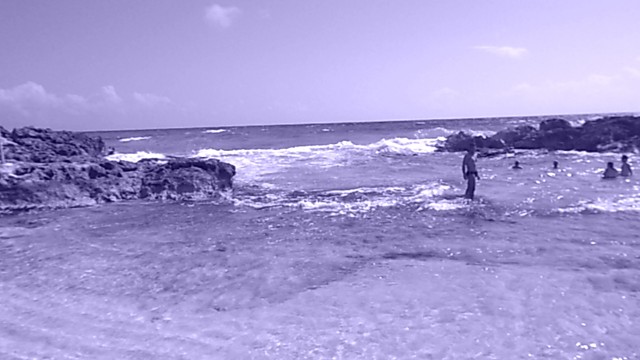

    Last summer on a trip I forgot to take my camera and I had to shoot with a Nikon Coolpix still camera which had its settings screwed up. Result is a number of clips where the dominant colour is blue. Almost everything has different tones of blue. Now I wish to "correct" these clips so that I can have other colours and the clips become as natural as possible. I am attaching one of the clips here as an example. Help from experts is appreciated.
  2. The chroma channels are completely flat, but the U channels is offset (hence the purple cast). So you're out of luck as far as automated correction is concerned, there are no colors there to restore. You can reduce it to pure greyscale by removing the U channel offset. The only way to get full color is to use colorizing software and paint each frame by hand.

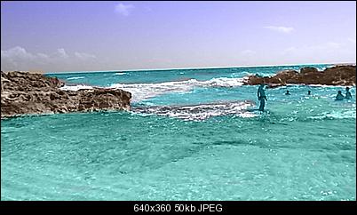

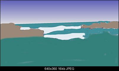

    He created an image that was a gradient from blue at the top to green at the bottom. Then he replaced the colors in the video with the colors from the gradient. I don't think you can do that in VirtualDub. It's pretty easy in AviSynth:
    AviSource("DSCN1182.AVI")
    gradient=ImageSource("gradient.jpg").ConvertToYV12()
    MergeChroma(gradient)
    Original video (only greyscale information will be used):

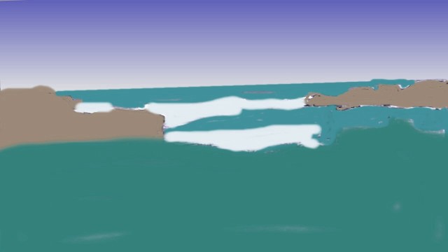

    Quick/dirty colors painted by hand:
    Colors overlaid onto original video:

  16. Nah, it's crap. But it should give the OP an idea what's he needs to do. It will takes forever with a paint program. It really needs to be done with specialized software that lets you mark objects and motion track. Even with the correct software it's a major undertaking.
    Deshaking the video first will make things a little easier.
