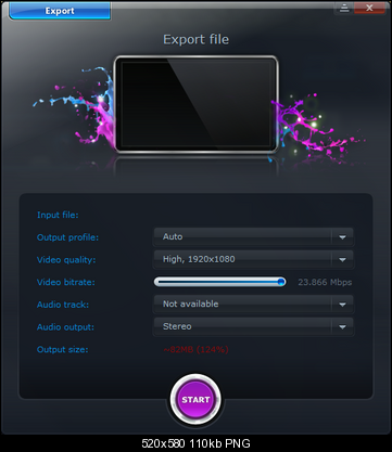

  8. Mirillis Action! have option to convert file,
    by right click in program and select Export selected file
    or this option don't work for you?
  9. No.
    Export is for mobile devices mostly and it has a very poor interface. You can't set anything here beside the profile and a reduced bitrate slider.
  10. Its have option export to Full HD MP4 with bitrate up 20mbps
    and quality very good
    what file you trying to convert?
