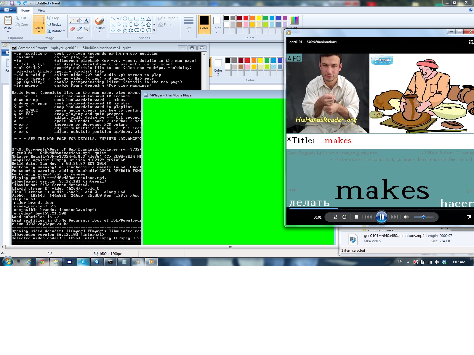

  1. I'm using a flash card system that calls MPlayer to play the video that I put into the flash cards. The video plays fine in Media Player but when played via MPlayer the video frame flashes green momentarily has the video exits. And if i hover the mouse over the playing video the mouse cursor casts a green shadow.
    The video is MP4 x.264
    Are there encodings that MPlayer does not do well with and this is one of them? I'm using Video to Video to encode.

    Perhaps the fault is of Video to Video, or more specifically, of ffmpeg's mp4 muxer
    A MediaInfo report about the problematic file MIGHT help.
    Also, open the MP4 file with MPlayer from the command prompt,
    then copy and post here the warning/error messages (if any).

  4. Running errant mp4 with MPlayer from command line...
    C:\Program Files (x86)\Anki>mplayer C:\Users\Ownerc\Documents\HisHands\HHR_Video
    _Maker_Batch_Stuff\Final_Videos_And_Generated_Fram es_Folder_Inflections_4\gen010
    1---640x480animations---640x480-x264-1500.mp4

    [h264 @ 0116f7b4]concealing 1353 DC, 1353 AC, 1353 MV errors
    A: 1.1 V: 1.1 A-V: -0.003 ct: 0.022 0/ 0 51% 4% 1.2% 6 0
    [h264 @ 0116f7b4]Reference 5 >= 2
    [h264 @ 0116f7b4]error while decoding MB 5 1, bytestream (649)
    A: 1.2 V: 1.2 A-V: 0.007 ct: 0.023 0/ 0 50% 4% 1.2% 6 0
    [h264 @ 0116f7b4]Reference 3 >= 2
    [h264 @ 0116f7b4]error while decoding MB 8 0, bytestream (446)
    A: 1.2 V: 1.2 A-V: -0.003 ct: 0.022 0/ 0 50% 4% 1.2% 6 0
    [h264 @ 0116f7b4]top block unavailable for requested intra4x4 mode -1 at 10 0
    [h264 @ 0116f7b4]error while decoding MB 10 0, bytestream (14367)
    A: 1.2 V: 1.2 A-V: 0.007 ct: 0.023 0/ 0 50% 4% 1.1% 6 0
    [h264 @ 0116f7b4]Reference 4 >= 3
    [h264 @ 0116f7b4]error while decoding MB 13 1, bytestream (722)
    [h264 @ 0116f7b4]concealing 1348 DC, 1348 AC, 1348 MV errors
    A: 1.3 V: 1.3 A-V: -0.003 ct: 0.022 0/ 0 49% 3% 1.2% 6 0
    [h264 @ 0116f7b4]Reference 2 >= 2
    [h264 @ 0116f7b4]error while decoding MB 2 1, bytestream (333)
    A: 1.3 V: 1.3 A-V: -0.003 ct: 0.022 0/ 0 49% 3% 1.1% 6 0
    [h264 @ 0116f7b4]error while decoding MB 24 0, bytestream (324)
    A: 1.4 V: 1.4 A-V: 0.007 ct: 0.023 0/ 0 48% 3% 1.1% 6 0
    [h264 @ 0116f7b4]Reference 5 >= 4
    [h264 @ 0116f7b4]error while decoding MB 25 0, bytestream (12671)
    A: 1.4 V: 1.4 A-V: 0.007 ct: 0.023 0/ 0 47% 3% 1.1% 6 0
    [h264 @ 0116f7b4]top block unavailable for requested intra4x4 mode -1 at 6 0
    [h264 @ 0116f7b4]error while decoding MB 6 0, bytestream (828)
    A: 1.4 V: 1.4 A-V: -0.003 ct: 0.023 0/ 0 46% 3% 1.2% 6 0
    [h264 @ 0116f7b4]error while decoding MB 7 1, bytestream (705)
    A: 1.5 V: 1.5 A-V: 0.007 ct: 0.024 0/ 0 46% 3% 1.1% 6 0
    [h264 @ 0116f7b4]top block unavailable for requested intra mode at 16 0
    [h264 @ 0116f7b4]error while decoding MB 16 0, bytestream (208)
    A: 1.5 V: 1.5 A-V: -0.003 ct: 0.023 0/ 0 46% 3% 1.2% 6 0
    [h264 @ 0116f7b4]error while decoding MB 7 0, bytestream (13373)
    A: 1.6 V: 1.6 A-V: -0.003 ct: 0.023 0/ 0 46% 3% 1.2% 6 0
    [h264 @ 0116f7b4]Reference 5 >= 3
    [h264 @ 0116f7b4]error while decoding MB 7 0, bytestream (1151)
    A: 1.6 V: 1.6 A-V: -0.003 ct: 0.023 0/ 0 46% 3% 1.1% 6 0
    [h264 @ 0116f7b4]error while decoding MB 10 0, bytestream (450)
    A: 1.6 V: 1.6 A-V: -0.003 ct: 0.022 0/ 0 47% 3% 1.2% 6 0
    [h264 @ 0116f7b4]error while decoding MB 7 0, bytestream (258)
    A: 1.7 V: 1.7 A-V: 0.007 ct: 0.023 0/ 0 47% 3% 1.2% 6 0
    [h264 @ 0116f7b4]error while decoding MB 16 0, bytestream (18207)
    [h264 @ 0116f7b4]Reference 3 >= 3
    [h264 @ 0116f7b4]error while decoding MB 27 0, bytestream (377)
    A: 1.8 V: 1.8 A-V: 0.007 ct: 0.024 0/ 0 47% 3% 1.2% 6 0
    [h264 @ 0116f7b4]error while decoding MB 11 0, bytestream (547)
    A: 1.8 V: 1.8 A-V: -0.003 ct: 0.024 0/ 0 46% 3% 1.2% 6 0
    [h264 @ 0116f7b4]error while decoding MB 8 0, bytestream (173)
    A: 1.8 V: 1.8 A-V: 0.007 ct: 0.024 0/ 0 46% 3% 1.2% 6 0
    [h264 @ 0116f7b4]error while decoding MB 12 0, bytestream (8248)
    A: 1.9 V: 1.9 A-V: -0.003 ct: 0.024 0/ 0 45% 2% 1.2% 6 0
    [h264 @ 0116f7b4]error while decoding MB 24 0, bytestream (30)
    A: 1.9 V: 1.9 A-V: -0.003 ct: 0.024 0/ 0 45% 2% 1.1% 6 0
    [h264 @ 0116f7b4]error while decoding MB 5 0, bytestream (154)
    A: 2.0 V: 2.0 A-V: -0.003 ct: 0.023 0/ 0 45% 2% 1.1% 6 0
    [h264 @ 0116f7b4]error while decoding MB 17 1, bytestream (18)
    [h264 @ 0116f7b4]concealing 1344 DC, 1344 AC, 1344 MV errors
    A: 2.0 V: 2.0 A-V: 0.007 ct: 0.024 0/ 0 44% 2% 1.2% 6 0
    [h264 @ 0116f7b4]Reference 6 >= 4
    [h264 @ 0116f7b4]error while decoding MB 9 0, bytestream (5737)
    A: 2.0 V: 2.0 A-V: -0.003 ct: 0.024 0/ 0 44% 2% 1.2% 6 0
    A: 2.1 V: 2.1 A-V: -0.003 ct: 0.023 0/ 0 43% 2% 1.2% 6 0
    [h264 @ 0116f7b4]concealing 1345 DC, 1345 AC, 1345 MV errors
    A: 2.1 V: 2.1 A-V: -0.003 ct: 0.023 0/ 0 43% 2% 1.1% 6 0
    [h264 @ 0116f7b4]error while decoding MB 12 1, bytestream (35)
    [h264 @ 0116f7b4]concealing 1349 DC, 1349 AC, 1349 MV errors
    A: 2.2 V: 2.2 A-V: -0.003 ct: 0.022 0/ 0 42% 2% 1.1% 6 0
    [h264 @ 0116f7b4]Reference 4 >= 4
    [h264 @ 0116f7b4]error while decoding MB 3 0, bytestream (7132)
    A: 2.2 V: 2.2 A-V: -0.003 ct: 0.022 0/ 0 43% 2% 1.1% 6 0
    [h264 @ 0116f7b4]error while decoding MB 33 0, bytestream (-6)
    A: 2.2 V: 2.2 A-V: 0.007 ct: 0.023 0/ 0 43% 2% 1.2% 6 0
    [h264 @ 0116f7b4]error while decoding MB 9 1, bytestream (172)
    [h264 @ 0116f7b4]concealing 1352 DC, 1352 AC, 1352 MV errors
    A: 2.3 V: 2.3 A-V: -0.003 ct: 0.022 0/ 0 43% 2% 1.1% 6 0
    [h264 @ 0116f7b4]error while decoding MB 17 2, bytestream (-11)
    [h264 @ 0116f7b4]concealing 1303 DC, 1303 AC, 1303 MV errors
    A: 2.3 V: 2.3 A-V: 0.007 ct: 0.023 0/ 0 43% 2% 1.2% 6 0
    [h264 @ 0116f7b4]error while decoding MB 4 0, bytestream (9100)
    A: 2.4 V: 2.4 A-V: 0.007 ct: 0.024 0/ 0 43% 2% 1.1% 6 0
    [h264 @ 0116f7b4]error while decoding MB 25 1, bytestream (-30)
    [h264 @ 0116f7b4]concealing 1336 DC, 1336 AC, 1336 MV errors
    [h264 @ 0116f7b4]error while decoding MB 20 0, bytestream (62)
    A: 2.4 V: 2.4 A-V: 0.007 ct: 0.025 0/ 0 43% 2% 1.1% 6 0
    [h264 @ 0116f7b4]error while decoding MB 4 2, bytestream (-8)
    [h264 @ 0116f7b4]concealing 1316 DC, 1316 AC, 1316 MV errors
    A: 2.5 V: 2.5 A-V: -0.003 ct: 0.025 0/ 0 43% 2% 1.1% 6 0
    [h264 @ 0116f7b4]Reference 7 >= 4
    [h264 @ 0116f7b4]error while decoding MB 2 0, bytestream (11054)
    A: 2.5 V: 2.5 A-V: -0.003 ct: 0.024 0/ 0 43% 2% 1.1% 6 0
    [h264 @ 0116f7b4]error while decoding MB 34 0, bytestream (1)
    A: 2.6 V: 2.6 A-V: -0.003 ct: 0.024 0/ 0 43% 2% 1.1% 6 0
    [h264 @ 0116f7b4]error while decoding MB 19 0, bytestream (-32)
    A: 2.6 V: 2.6 A-V: 0.007 ct: 0.024 0/ 0 42% 2% 1.1% 6 0
    [h264 @ 0116f7b4]error while decoding MB 27 4, bytestream (-29)
    [h264 @ 0116f7b4]concealing 1211 DC, 1211 AC, 1211 MV errors
    A: 2.6 V: 2.6 A-V: 0.007 ct: 0.025 0/ 0 42% 2% 1.1% 6 0
    [h264 @ 0116f7b4]error while decoding MB 5 0, bytestream (10164)
    A: 2.7 V: 2.7 A-V: 0.007 ct: 0.026 0/ 0 42% 2% 1.0% 6 0
    [h264 @ 0116f7b4]top block unavailable for requested intra mode at 9 0
    [h264 @ 0116f7b4]error while decoding MB 9 0, bytestream (47)
    A: 2.7 V: 2.7 A-V: -0.003 ct: 0.025 0/ 0 42% 2% 1.1% 6 0
    [h264 @ 0116f7b4]error while decoding MB 16 0, bytestream (-12)
    A: 2.8 V: 2.8 A-V: -0.003 ct: 0.025 0/ 0 41% 2% 1.1% 6 0
    [h264 @ 0116f7b4]error while decoding MB 25 7, bytestream (14)
    [h264 @ 0116f7b4]concealing 1090 DC, 1090 AC, 1090 MV errors
    [h264 @ 0116f7b4]error while decoding MB 11 0, bytestream (9193)
    A: 2.8 V: 2.8 A-V: 0.007 ct: 0.025 0/ 0 41% 2% 1.1% 6 0
    [h264 @ 0116f7b4]error while decoding MB 4 0, bytestream (68)
    A: 2.9 V: 2.9 A-V: 0.033 ct: 0.029 0/ 0 41% 2% 1.0% 6 0
    [h264 @ 0116f7b4]error while decoding MB 6 0, bytestream (0)
    A: 2.9 V: 2.9 A-V: 0.023 ct: 0.031 0/ 0 41% 2% 1.0% 6 0
    [h264 @ 0116f7b4]error while decoding MB 25 7, bytestream (-21)
    A: 3.0 V: 3.0 A-V: 0.023 ct: 0.033 0/ 0 41% 2% 1.0% 6 0
    [h264 @ 0116f7b4]error while decoding MB 7 0, bytestream (7740)
    A: 3.0 V: 3.0 A-V: 0.023 ct: 0.035 0/ 0 41% 2% 1.0% 6 0
    [h264 @ 0116f7b4]error while decoding MB 33 1, bytestream (83)
    [h264 @ 0116f7b4]concealing 1328 DC, 1328 AC, 1328 MV errors
    A: 3.1 V: 3.0 A-V: 0.013 ct: 0.037 0/ 0 40% 2% 1.1% 6 0
    [h264 @ 0116f7b4]Reference 4 >= 2
    [h264 @ 0116f7b4]error while decoding MB 25 1, bytestream (171)
    A: 3.1 V: 3.1 A-V: 0.013 ct: 0.038 0/ 0 40% 2% 1.0% 6 0
    [h264 @ 0116f7b4]error while decoding MB 29 7, bytestream (22)
    [h264 @ 0116f7b4]concealing 1086 DC, 1086 AC, 1086 MV errors
    A: 3.1 V: 3.1 A-V: 0.013 ct: 0.039 0/ 0 40% 2% 1.0% 6 0
    [h264 @ 0116f7b4]error while decoding MB 26 0, bytestream (9232)
    A: 3.2 V: 3.2 A-V: 0.013 ct: 0.040 0/ 0 40% 2% 1.0% 6 0
    [h264 @ 0116f7b4]Reference 6 >= 3
    [h264 @ 0116f7b4]error while decoding MB 14 0, bytestream (65)
    A: 3.2 V: 3.2 A-V: 0.013 ct: 0.042 0/ 0 39% 2% 1.0% 6 0
    [h264 @ 0116f7b4]error while decoding MB 37 1, bytestream (45)
    [h264 @ 0116f7b4]concealing 1324 DC, 1324 AC, 1324 MV errors
    A: 3.3 V: 3.2 A-V: 0.013 ct: 0.043 0/ 0 39% 2% 1.0% 6 0
    [h264 @ 0116f7b4]error while decoding MB 25 7, bytestream (-9)
    A: 3.3 V: 3.3 A-V: 0.013 ct: 0.044 0/ 0 39% 2% 1.0% 6 0
    [h264 @ 0116f7b4]error while decoding MB 2 0, bytestream (11897)
    A: 3.3 V: 3.3 A-V: 0.013 ct: 0.045 0/ 0 39% 2% 1.0% 6 0
    [h264 @ 0116f7b4]top block unavailable for requested intra mode at 12 0
    [h264 @ 0116f7b4]error while decoding MB 12 0, bytestream (69)
    A: 3.4 V: 3.4 A-V: 0.003 ct: 0.046 0/ 0 39% 2% 1.0% 6 0
    [h264 @ 0116f7b4]error while decoding MB 11 0, bytestream (133)
    A: 3.4 V: 3.4 A-V: 0.003 ct: 0.046 0/ 0 39% 2% 1.1% 6 0
    [h264 @ 0116f7b4]error while decoding MB 24 7, bytestream (-4)
    [h264 @ 0116f7b4]concealing 1091 DC, 1091 AC, 1091 MV errors
    A: 3.4 V: 3.4 A-V: 0.003 ct: 0.046 0/ 0 38% 2% 1.0% 6 0
    [h264 @ 0116f7b4]error while decoding MB 3 0, bytestream (10457)
    A: 3.5 V: 3.5 A-V: 0.003 ct: 0.046 0/ 0 38% 1% 1.0% 6 0
    [h264 @ 0116f7b4]error while decoding MB 9 0, bytestream (19)
    A: 3.5 V: 3.5 A-V: 0.003 ct: 0.047 0/ 0 38% 1% 1.0% 6 0
    [h264 @ 0116f7b4]error while decoding MB 15 0, bytestream (81)
    A: 3.6 V: 3.6 A-V: 0.003 ct: 0.047 0/ 0 38% 1% 1.0% 6 0
    [h264 @ 0116f7b4]error while decoding MB 23 29, bytestream (-6)
    [h264 @ 0116f7b4]concealing 190 DC, 190 AC, 190 MV errors

  5. Running errant mp4 with MPlayer from command line...
    MPlayer Sherpya-SVN-r32492-4.2.5 (C) 2000-2010 MPlayer Team
    Playing C:\Users\Ownerc\Documents\HisHands\HHR_Video_Maker _Batch_Stuff\Final_Vid
    eos_And_Generated_Frames_Folder_Inflections_4\gen0 101---640x480animations---640x
    480-x264-1500.mp4.
    libavformat file format detected.
    [h264 @ 01e96dc0] brainfart cropping not supported, this could look slightly wro
    ng ...
    [h264 @ 01e96dc0] top block unavailable for requested intra4x4 mode -1 at 1 0
    [h264 @ 01e96dc0] error while decoding MB 1 0, bytestream (44773)
    [h264 @ 01e96dc0] concealing 1353 DC, 1353 AC, 1353 MV errors
    [h264 @ 01e96dc0] top block unavailable for requested intra mode at 10 0
    [h264 @ 01e96dc0] error while decoding MB 10 0, bytestream (2285)
    [h264 @ 01e96dc0] concealing 1305 DC, 1305 AC, 1305 MV errors
    [h264 @ 01e96dc0] concealing 1329 DC, 1329 AC, 1329 MV errors
    [h264 @ 01e96dc0] Reference 2 >= 2
    [h264 @ 01e96dc0] error while decoding MB 1 2, bytestream (119)
    [h264 @ 01e96dc0] concealing 1319 DC, 1319 AC, 1319 MV errors
    [h264 @ 01e96dc0] Reference 4 >= 4
    [h264 @ 01e96dc0] error while decoding MB 11 0, bytestream (4120)
    [lavf] stream 0: video (h264), -vid 0
    [lavf] stream 1: audio (aac), -aid 0, -alang und
    VIDEO: [H264] 642x514 24bpp 25.000 fps 423.2 kbps (51.7 kbyte/s)
    Clip info:
    major_brand: isom
    minor_version: 512
    compatible_brands: isomiso2avc1mp41
    encoder: Lavf54.63.104
    Opening video decoder: [ffmpeg] FFmpeg's libavcodec codec family
    [h264 @ 0116f7b4]brainfart cropping not supported, this could look slightly wron
    g ...
    Selected video codec: [ffh264] vfm: ffmpeg (FFmpeg H.264)
    Opening audio decoder: [faad] AAC (MPEG2/4 Advanced Audio Coding)
    AUDIO: 44100 Hz, 2 ch, s16le, 86.6 kbit/6.14% (ratio: 10825->176400)
    Selected audio codec: [faad] afm: faad (FAAD AAC (MPEG-2/MPEG-4 Audio))
    AO: [dsound] 44100Hz 2ch s16le (2 bytes per sample)
    Starting playback...
    [h264 @ 0116f7b4]top block unavailable for requested intra4x4 mode -1 at 1 0
    [h264 @ 0116f7b4]error while decoding MB 1 0, bytestream (44773)
    [h264 @ 0116f7b4]top block unavailable for requested intra mode at 10 0
    [h264 @ 0116f7b4]error while decoding MB 10 0, bytestream (2285)
    [h264 @ 0116f7b4]concealing 1305 DC, 1305 AC, 1305 MV errors
    Movie-Aspect is 1.25:1 - prescaling to correct movie aspect.
    VO: [directx] 642x514 => 642x514 Planar YV12
    Fontconfig error: Cannot load default config file
    Fontconfig failed to select a font. Trying without fontconfig...
    New_Face failed. Maybe the font path is wrong.
    Please supply the text font file (~/.mplayer/subfont.ttf).
    subtitle font: load_sub_face failed.
    A: 0.3 V: 0.0 A-V: 0.324 ct: 0.000 0/ 0 ??% ??% ??,?% 0 0
    [h264 @ 0116f7b4]concealing 1329 DC, 1329 AC, 1329 MV errors
    A: 0.4 V: 0.0 A-V: 0.314 ct: 0.003 0/ 0 ??% ??% ??,?% 1 0
    [h264 @ 0116f7b4]error while decoding MB 1 2, bytestream (119)
    [h264 @ 0116f7b4]concealing 1319 DC, 1319 AC, 1319 MV errors
    A: 0.4 V: 0.1 A-V: 0.284 ct: 0.005 0/ 0 ??% ??% ??,?% 2 0
    [h264 @ 0116f7b4]error while decoding MB 11 0, bytestream (4120)
    A: 0.4 V: 0.1 A-V: 0.254 ct: 0.007 0/ 0 ??% ??% ??,?% 3 0
    A: 0.4 V: 0.2 A-V: 0.224 ct: 0.009 0/ 0 ??% ??% ??,?% 4 0
    [h264 @ 0116f7b4]concealing 1304 DC, 1304 AC, 1304 MV errors
    A: 0.4 V: 0.2 A-V: 0.184 ct: 0.010 0/ 0 ??% ??% ??,?% 4 0
    [h264 @ 0116f7b4]error while decoding MB 7 0, bytestream (663)
    A: 0.4 V: 0.2 A-V: 0.154 ct: 0.011 0/ 0 ??% ??% ??,?% 5 0
    [h264 @ 0116f7b4]error while decoding MB 33 0, bytestream (3873)
    A: 0.4 V: 0.3 A-V: 0.124 ct: 0.013 0/ 0 ??% ??% ??,?% 6 0
    [h264 @ 0116f7b4]concealing 1283 DC, 1283 AC, 1283 MV errors
    A: 0.4 V: 0.3 A-V: 0.094 ct: 0.014 0/ 0 ??% ??% ??,?% 6 0
    [h264 @ 0116f7b4]concealing 1012 DC, 1012 AC, 1012 MV errors
    A: 0.4 V: 0.4 A-V: 0.064 ct: 0.016 0/ 0 ??% ??% ??,?% 6 0
    [h264 @ 0116f7b4]error while decoding MB 13 3, bytestream (1030)
    [h264 @ 0116f7b4]concealing 1266 DC, 1266 AC, 1266 MV errors
    A: 0.4 V: 0.4 A-V: 0.044 ct: 0.017 0/ 0 ??% ??% ??,?% 6 0
    [h264 @ 0116f7b4]error while decoding MB 12 0, bytestream (8584)
    A: 0.4 V: 0.4 A-V: 0.004 ct: 0.018 0/ 0 ??% ??% ??,?% 6 0
    [h264 @ 0116f7b4]Reference 7 >= 3
    [h264 @ 0116f7b4]error while decoding MB 8 0, bytestream (1923)
    A: 0.5 V: 0.5 A-V: 0.004 ct: 0.018 0/ 0 ??% ??% ??,?% 6 0
    [h264 @ 0116f7b4]error while decoding MB 17 0, bytestream (1075)
    A: 0.5 V: 0.5 A-V: 0.004 ct: 0.018 0/ 0 77% 9% 1.3% 6 0
    [h264 @ 0116f7b4]error while decoding MB 6 1, bytestream (1172)
    A: 0.6 V: 0.6 A-V: 0.004 ct: 0.019 0/ 0 73% 8% 1.4% 6 0
    [h264 @ 0116f7b4]error while decoding MB 9 0, bytestream (11255)
    A: 0.6 V: 0.6 A-V: 0.004 ct: 0.019 0/ 0 69% 8% 1.3% 6 0
    [h264 @ 0116f7b4]error while decoding MB 30 2, bytestream (456)
    [h264 @ 0116f7b4]concealing 1290 DC, 1290 AC, 1290 MV errors
    A: 0.7 V: 0.6 A-V: 0.014 ct: 0.020 0/ 0 66% 7% 1.2% 6 0
    [h264 @ 0116f7b4]error while decoding MB 25 0, bytestream (915)
    A: 0.7 V: 0.7 A-V: 0.004 ct: 0.021 0/ 0 64% 7% 1.3% 6 0
    [h264 @ 0116f7b4]error while decoding MB 16 0, bytestream (431)
    A: 0.7 V: 0.7 A-V: 0.004 ct: 0.021 0/ 0 62% 7% 1.4% 6 0
    [h264 @ 0116f7b4]error while decoding MB 18 0, bytestream (8525)
    A: 0.7 V: 0.8 A-V: -0.019 ct: 0.019 0/ 0 59% 6% 1.3% 6 0
    [h264 @ 0116f7b4]concealing 1343 DC, 1343 AC, 1343 MV errors
    A: 0.8 V: 0.8 A-V: 0.007 ct: 0.020 0/ 0 57% 6% 1.4% 6 0
    [h264 @ 0116f7b4]error while decoding MB 9 0, bytestream (1049)
    A: 0.8 V: 0.8 A-V: 0.007 ct: 0.020 0/ 0 55% 6% 1.4% 6 0
    [h264 @ 0116f7b4]error while decoding MB 8 0, bytestream (719)
    A: 0.9 V: 0.9 A-V: 0.007 ct: 0.021 0/ 0 53% 5% 1.4% 6 0
    [h264 @ 0116f7b4]top block unavailable for requested intra4x4 mode -1 at 2 0
    [h264 @ 0116f7b4]error while decoding MB 2 0, bytestream (10112)
    A: 0.9 V: 0.9 A-V: -0.003 ct: 0.021 0/ 0 52% 5% 1.4% 6 0
    [h264 @ 0116f7b4]concealing 1347 DC, 1347 AC, 1347 MV errors
    A: 1.0 V: 1.0 A-V: 0.007 ct: 0.021 0/ 0 51% 5% 1.5% 6 0
    [h264 @ 0116f7b4]error while decoding MB 4 0, bytestream (780)
    A: 1.0 V: 1.0 A-V: -0.003 ct: 0.021 0/ 0 51% 5% 1.4% 6 0
    [h264 @ 0116f7b4]error while decoding MB 16 1, bytestream (155)
    A: 1.0 V: 1.0 A-V: 0.007 ct: 0.022 0/ 0 51% 4% 1.3% 6 0
    [h264 @ 0116f7b4]error while decoding MB 11 0, bytestream (12635)
    A: 1.1 V: 1.1 A-V: 0.007 ct: 0.022 0/ 0 51% 4% 1.3% 6 0
    [h264 @ 0116f7b4]error while decoding MB 20 0, bytestream (808)
    A: 3.6 V: 3.6 A-V: 0.003 ct: 0.047 0/ 0 37% 1% 1.0% 6 0
    [h264 @ 0116f7b4]error while decoding MB 6 0, bytestream (7296)
    [h264 @ 0116f7b4]error while decoding MB 20 2, bytestream (101)
    [h264 @ 0116f7b4]concealing 1300 DC, 1300 AC, 1300 MV errors
    A: 3.7 V: 3.7 A-V: 0.003 ct: 0.048 0/ 0 38% 1% 1.0% 6 0
    [h264 @ 0116f7b4]error while decoding MB 33 1, bytestream (79)
    [h264 @ 0116f7b4]error while decoding MB 24 29, bytestream (-34)
    [h264 @ 0116f7b4]concealing 189 DC, 189 AC, 189 MV errors
    A: 3.8 V: 3.8 A-V: 0.003 ct: 0.048 0/ 0 38% 1% 1.0% 6 0
    [h264 @ 0116f7b4]Reference 9 >= 4
    [h264 @ 0116f7b4]error while decoding MB 6 0, bytestream (7017)
    [h264 @ 0116f7b4]error while decoding MB 6 1, bytestream (40)
    A: 3.8 V: 3.8 A-V: 0.003 ct: 0.049 0/ 0 38% 1% 1.0% 6 0
    [h264 @ 0116f7b4]error while decoding MB 22 0, bytestream (106)
    A: 3.9 V: 3.9 A-V: 0.003 ct: 0.049 0/ 0 38% 1% 1.0% 6 0
    [h264 @ 0116f7b4]error while decoding MB 18 9, bytestream (-36)
    [h264 @ 0116f7b4]concealing 1015 DC, 1015 AC, 1015 MV errors
    [h264 @ 0116f7b4]error while decoding MB 11 0, bytestream (5436)
    A: 4.0 V: 4.0 A-V: 0.003 ct: 0.049 0/ 0 38% 1% 1.0% 6 0
    [h264 @ 0116f7b4]error while decoding MB 14 1, bytestream (-26)
    A: 4.0 V: 4.0 A-V: 0.003 ct: 0.050 0/ 0 37% 1% 1.0% 6 0
    [h264 @ 0116f7b4]error while decoding MB 37 1, bytestream (136)
    [h264 @ 0116f7b4]error while decoding MB 20 16, bytestream (-6)
    [h264 @ 0116f7b4]concealing 726 DC, 726 AC, 726 MV errors
    A: 4.1 V: 4.1 A-V: 0.003 ct: 0.050 0/ 0 37% 1% 1.0% 6 0
    [h264 @ 0116f7b4]error while decoding MB 5 0, bytestream (3714)
    [h264 @ 0116f7b4]error while decoding MB 13 0, bytestream (-24)
    A: 4.2 V: 4.2 A-V: 0.003 ct: 0.051 0/ 0 37% 1% 1.1% 6 0
    [h264 @ 0116f7b4]error while decoding MB 10 0, bytestream (126)
    [h264 @ 0116f7b4]error while decoding MB 4 17, bytestream (2)
    [h264 @ 0116f7b4]concealing 701 DC, 701 AC, 701 MV errors
    [h264 @ 0116f7b4]error while decoding MB 3 0, bytestream (4524)
    A: 4.3 V: 4.3 A-V: -0.007 ct: 0.050 0/ 0 37% 1% 1.1% 6 0
    [h264 @ 0116f7b4]error while decoding MB 14 0, bytestream (-33)
    [h264 @ 0116f7b4]error while decoding MB 29 0, bytestream (-48)
    A: 4.4 V: 4.4 A-V: 0.003 ct: 0.050 0/ 0 36% 1% 1.1% 6 0
    A: 4.4 V: 4.4 A-V: 0.003 ct: 0.050 0/ 0 37% 1% 1.1% 6 0
    [h264 @ 0116f7b4]Reference 8 >= 4
    [h264 @ 0116f7b4]error while decoding MB 4 0, bytestream (3579)
    [h264 @ 0116f7b4]error while decoding MB 3 2, bytestream (-7)
    [h264 @ 0116f7b4]concealing 1317 DC, 1317 AC, 1317 MV errors
    A: 4.5 V: 4.5 A-V: 0.003 ct: 0.051 0/ 0 37% 1% 1.1% 6 0
    [h264 @ 0116f7b4]error while decoding MB 5 1, bytestream (-22)
    [h264 @ 0116f7b4]error while decoding MB 4 17, bytestream (4)
    A: 4.6 V: 4.6 A-V: 0.003 ct: 0.051 0/ 0 36% 1% 1.1% 6 0
    [h264 @ 0116f7b4]top block unavailable for requested intra4x4 mode -1 at 22 0
    [h264 @ 0116f7b4]error while decoding MB 22 0, bytestream (3782)
    [h264 @ 0116f7b4]error while decoding MB 12 0, bytestream (-34)
    A: 4.7 V: 4.6 A-V: 0.019 ct: 0.053 0/ 0 36% 1% 1.1% 6 0
    [h264 @ 0116f7b4]error while decoding MB 23 2, bytestream (115)
    [h264 @ 0116f7b4]concealing 1297 DC, 1297 AC, 1297 MV errors
    A: 4.7 V: 4.7 A-V: 0.055 ct: 0.057 0/ 0 36% 1% 1.1% 6 0
    [h264 @ 0116f7b4]error while decoding MB 22 16, bytestream (-4)
    [h264 @ 0116f7b4]concealing 724 DC, 724 AC, 724 MV errors
    A: 4.8 V: 4.7 A-V: 0.045 ct: 0.061 0/ 0 36% 1% 1.1% 6 0
    [h264 @ 0116f7b4]error while decoding MB 6 0, bytestream (3834)
    A: 4.9 V: 4.8 A-V: 0.135 ct: 0.065 0/ 0 36% 1% 1.1% 6 0
    [h264 @ 0116f7b4]error while decoding MB 6 0, bytestream (-27)
    A: 4.9 V: 4.8 A-V: 0.135 ct: 0.069 0/ 0 36% 1% 1.1% 6 0
    [h264 @ 0116f7b4]error while decoding MB 7 0, bytestream (-33)
    A: 5.0 V: 4.8 A-V: 0.125 ct: 0.073 0/ 0 36% 1% 1.1% 6 0
    A: 5.0 V: 4.9 A-V: 0.125 ct: 0.077 0/ 0 36% 1% 1.1% 6 0
    [h264 @ 0116f7b4]error while decoding MB 15 0, bytestream (2947)
    A: 5.0 V: 4.9 A-V: 0.115 ct: 0.081 0/ 0 36% 1% 1.1% 6 0
    [h264 @ 0116f7b4]error while decoding MB 39 1, bytestream (22)
    [h264 @ 0116f7b4]concealing 1322 DC, 1322 AC, 1322 MV errors
    A: 5.1 V: 5.0 A-V: 0.115 ct: 0.085 0/ 0 36% 1% 1.0% 6 0
    [h264 @ 0116f7b4]error while decoding MB 32 1, bytestream (122)
    A: 5.1 V: 5.0 A-V: 0.115 ct: 0.089 0/ 0 36% 1% 1.0% 6 0
    [h264 @ 0116f7b4]error while decoding MB 24 29, bytestream (-18)
    A: 5.1 V: 5.0 A-V: 0.105 ct: 0.093 0/ 0 36% 1% 1.0% 6 0
    [h264 @ 0116f7b4]error while decoding MB 15 0, bytestream (2924)
    A: 5.2 V: 5.1 A-V: 0.095 ct: 0.097 0/ 0 37% 1% 1.0% 6 0
    [h264 @ 0116f7b4]error while decoding MB 18 4, bytestream (22)
    [h264 @ 0116f7b4]concealing 1220 DC, 1220 AC, 1220 MV errors
    A: 5.2 V: 5.1 A-V: 0.095 ct: 0.101 0/ 0 37% 1% 1.0% 6 0
    [h264 @ 0116f7b4]error while decoding MB 34 1, bytestream (110)
    [h264 @ 0116f7b4]concealing 1327 DC, 1327 AC, 1327 MV errors
    A: 5.3 V: 5.2 A-V: 0.095 ct: 0.105 0/ 0 37% 1% 1.0% 6 0
    [h264 @ 0116f7b4]error while decoding MB 24 29, bytestream (0)
    A: 5.3 V: 5.2 A-V: 0.085 ct: 0.109 0/ 0 37% 1% 1.0% 6 0
    A: 5.3 V: 5.2 A-V: 0.085 ct: 0.113 0/ 0 37% 1% 1.0% 6 0
    [h264 @ 0116f7b4]error while decoding MB 34 1, bytestream (13)
    A: 5.4 V: 5.3 A-V: 0.085 ct: 0.117 0/ 0 37% 1% 1.0% 6 0
    [h264 @ 0116f7b4]error while decoding MB 35 1, bytestream (-16)
    [h264 @ 0116f7b4]concealing 1326 DC, 1326 AC, 1326 MV errors
    A: 5.4 V: 5.3 A-V: 0.075 ct: 0.121 0/ 0 37% 1% 1.0% 6 0
    A: 5.4 V: 5.4 A-V: 0.075 ct: 0.125 0/ 0 37% 1% 1.0% 6 0
    [h264 @ 0116f7b4]error while decoding MB 6 0, bytestream (2701)
    A: 5.5 V: 5.4 A-V: 0.075 ct: 0.129 0/ 0 37% 1% 1.0% 6 0
    [h264 @ 0116f7b4]error while decoding MB 32 2, bytestream (89)
    [h264 @ 0116f7b4]concealing 1288 DC, 1288 AC, 1288 MV errors
    A: 5.5 V: 5.4 A-V: 0.065 ct: 0.133 0/ 0 37% 1% 1.0% 6 0
    [h264 @ 0116f7b4]error while decoding MB 36 1, bytestream (108)
    [h264 @ 0116f7b4]concealing 1325 DC, 1325 AC, 1325 MV errors
    A: 5.5 V: 5.5 A-V: 0.065 ct: 0.137 0/ 0 37% 1% 1.0% 6 0
    A: 5.6 V: 5.5 A-V: 0.055 ct: 0.141 0/ 0 37% 1% 1.0% 6 0
    [h264 @ 0116f7b4]error while decoding MB 5 0, bytestream (2317)
    A: 5.6 V: 5.6 A-V: 0.055 ct: 0.145 0/ 0 37% 1% 1.0% 6 0
    [h264 @ 0116f7b4]error while decoding MB 30 2, bytestream (1)
    A: 5.7 V: 5.6 A-V: 0.055 ct: 0.149 0/ 0 37% 1% 0.9% 6 0
    [h264 @ 0116f7b4]error while decoding MB 36 1, bytestream (75)
    A: 5.7 V: 5.6 A-V: 0.045 ct: 0.153 0/ 0 37% 1% 0.9% 6 0
    A: 5.7 V: 5.7 A-V: 0.045 ct: 0.157 0/ 0 37% 1% 0.9% 6 0
    [h264 @ 0116f7b4]error while decoding MB 6 0, bytestream (1490)
    A: 5.8 V: 5.7 A-V: 0.035 ct: 0.161 0/ 0 37% 1% 0.9% 6 0
    [h264 @ 0116f7b4]error while decoding MB 35 4, bytestream (-9)
    [h264 @ 0116f7b4]concealing 1203 DC, 1203 AC, 1203 MV errors
    A: 5.8 V: 5.8 A-V: 0.035 ct: 0.164 0/ 0 37% 1% 0.9% 6 0
    [h264 @ 0116f7b4]error while decoding MB 39 1, bytestream (-49)
    A: 5.8 V: 5.8 A-V: 0.035 ct: 0.167 0/ 0 37% 1% 0.9% 6 0
    [h264 @ 0116f7b4]error while decoding MB 37 8, bytestream (1)
    [h264 @ 0116f7b4]concealing 1037 DC, 1037 AC, 1037 MV errors
    A: 5.9 V: 5.8 A-V: 0.025 ct: 0.170 0/ 0 37% 1% 0.9% 6 0
    [h264 @ 0116f7b4]error while decoding MB 24 0, bytestream (38)
    A: 5.9 V: 5.9 A-V: 0.025 ct: 0.172 0/ 0 37% 1% 0.9% 6 0
    [h264 @ 0116f7b4]error while decoding MB 29 6, bytestream (-11)
    [h264 @ 0116f7b4]concealing 1127 DC, 1127 AC, 1127 MV errors
    A: 5.9 V: 5.9 A-V: 0.025 ct: 0.175 0/ 0 37% 1% 0.9% 6 0
    [h264 @ 0116f7b4]error while decoding MB 34 1, bytestream (44)
    A: 6.0 V: 6.0 A-V: 0.025 ct: 0.177 0/ 0 37% 1% 0.9% 6 0
    [h264 @ 0116f7b4]error while decoding MB 11 3, bytestream (15)
    [h264 @ 0116f7b4]concealing 1268 DC, 1268 AC, 1268 MV errors
    A: 6.0 V: 6.0 A-V: 0.015 ct: 0.179 0/ 0 37% 1% 0.9% 6 0
    [h264 @ 0116f7b4]error while decoding MB 5 0, bytestream (534)
    A: 6.1 V: 6.0 A-V: 0.015 ct: 0.180 0/ 0 37% 1% 0.9% 6 0
    [h264 @ 0116f7b4]error while decoding MB 11 3, bytestream (36)
    A: 6.1 V: 6.1 A-V: 0.015 ct: 0.182 0/ 0 37% 1% 0.9% 6 0
    [h264 @ 0116f7b4]error while decoding MB 34 1, bytestream (32)
    A: 6.1 V: 6.1 A-V: 0.015 ct: 0.183 0/ 0 37% 1% 0.9% 6 0
    [h264 @ 0116f7b4]error while decoding MB 39 9, bytestream (-15)
    [h264 @ 0116f7b4]concealing 994 DC, 994 AC, 994 MV errors
    A: 6.2 V: 6.2 A-V: 0.015 ct: 0.184 0/ 0 36% 1% 0.9% 6 0
    [h264 @ 0116f7b4]error while decoding MB 7 0, bytestream (-48)
    A: 6.2 V: 6.2 A-V: 0.015 ct: 0.186 0/ 0 36% 1% 0.9% 6 0
    [h264 @ 0116f7b4]error while decoding MB 29 6, bytestream (-42)
    A: 6.3 V: 6.2 A-V: 0.015 ct: 0.187 0/ 0 36% 1% 0.9% 6 0
    [h264 @ 0116f7b4]error while decoding MB 3 2, bytestream (-12)
    A: 6.3 V: 6.3 A-V: 0.015 ct: 0.189 0/ 0 36% 1% 0.9% 6 0

  7. Hey!
    i ran the video with the latest mplayer... it did much better... it now plays... but three things were strange...
    1) My cursor still had a green shadow when hovering over the video
    2) A lot of scanning fonts happened at the beginning... I don't know why it was scanning fonts just to play a video.
    3) And the log has some some errors ... that I don't know if they mean anything significant
    Here is the cmd log split in to two parts...

    Playing gen0101---640x480animations---480x272.mp4.
    libavformat version 56.12.103 (internal)
    [lavf] stream 0: video (mpeg4), -vid 0
    VIDEO: [MP4V] 480x272 24bpp 25.000 fps 171.3 kbps (20.9 kbyte/s)
    Clip info:
    major_brand: isom
    minor_version: 512
    compatible_brands: isomiso2mp41
    Load subtitles in ./
    Load subtitles in G:/My Documents/Docs of Bob/Downloads/mplayer-svn-37324/mplaye
    r-svn-37324/mplayer/sub/
    libavcodec version 56.12.100 (internal)
    Selected video codec: [ffodivx] vfm: ffmpeg (FFmpeg MPEG-4)
    Opening audio decoder: [ffmpeg] FFmpeg/libavcodec audio decoders
    AUDIO: 44100 Hz, 2 ch, floatle, 86.6 kbit/3.07% (ratio: 10825->352800)
    Selected audio codec: [ffaac] afm: ffmpeg (FFmpeg AAC (MPEG-2/MPEG-4 Audio))
    Movie-Aspect is 1.76:1 - prescaling to correct movie aspect.
    VO: [directx] 480x272 => 480x272 Planar YV12
    A: 0.4 V: 0.0 A-V: 0.368 ct: 0.002 0/ 0 ??% ??% ??,?% 1 0
    [VD_FFMPEG] DRI failure.
    A: 7.0 V: 7.0 A-V: 0.032 ct: 0.252 0/ 0 7% 4% 0.7% 35 0
    Exiting... (End of file)

  10. Great! That fixed the font problem...
    But I am still getting a green shadow under my cursor when the cursor hovers over the playing video in mplayer. I tried to get a screen capture of this happening and the resulting screen capture turned solid green!
    Then I tried playing in Media Player and screen capture and the capture was perfect. See attached screen capture comparison...
    Any further ideas as to where the back layer green is coming from?
    Thanks so much!

  11. DECEASED
    Jun 2009
    Heaven
    Just a wild guess: buggy video drivers
    Also, give a try to MPlayer's -vo options...
  12. Long ago regular graphics cards could not display full motion video. A second video card was used for that. Your ran a VGA cable from the graphics card to the video card, then another VGA cable from the video card to the monitor. In order for video to appear in a window on the Desktop a rectangular hole was created on the Desktop. The video card would display the video in that hole. That hole was defined by a specific color. Any pixel of that color on the Desktop was treated as transparent by the video card -- the video would be seen through it. That technique was called Video Overlay.
    Modern graphics cards have no trouble displaying full motion video. But they can still emulate video overlay. A player creates a hole in the Desktop and the video is seen through that hole. That is why your screen capture doesn't show the video -- it only shows the hole (green in this case). The video isn't in the Desktop memory, it's elsewhere.
    The reason you get a green shadow under the mouse cursor is because Windows is set to create a drop shadow under the cursor. When you move the cursor over the video overlay hole the green hole is darkened around the cursor. That darker green is no longer treated as transparent by the video overlay process.
    You should be able to prevent these problems by not using video overlay. Configure the player to use a more modern video interface like EVR or VMR9.
  13. Thanks guys!
    In the past I have had a similar "Green background" problem with other video tools and no one could help.
    Jagabo, your explanation, has solved that mystery for me. Thanks for your detailed explanation!
    Here are the drivers that worked for me to get rid of that annoying green shadow...
