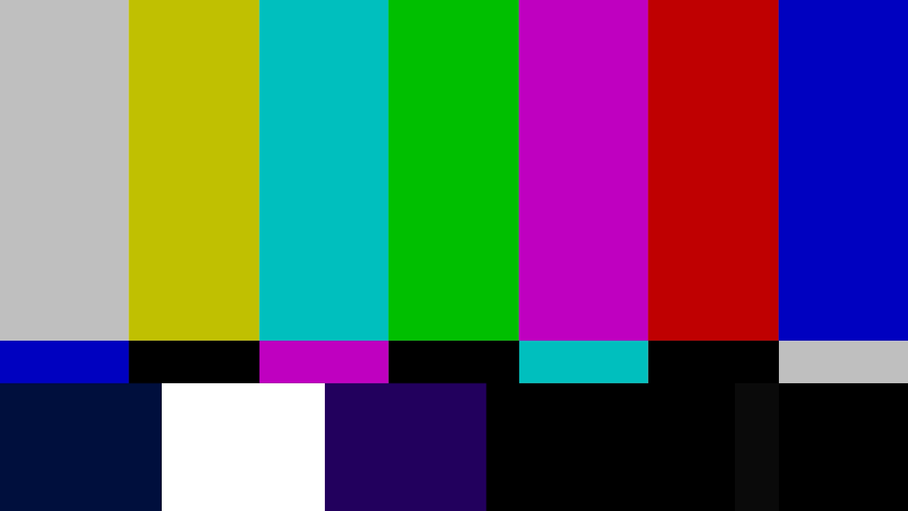

  3. Member Cornucopia's Avatar
    What is your necessity for cropping odd number of pixels?
  4. I thought it was just a thought experiment, and the effects on 4:2:0 encoding with x264
    However, if you have a real reason for this, you can crop odd dimensions and stay in 4:2:0 YV12, without incurring the loss of detail in the width dimension by colorspace conversion (up and downscaling chroma to 4:4:4 ) by using internal crop in the resizer
    (For this comparison I use bicubic, because ConvertToXX uses bicubic by default)
    e.g
    a) "original"
    colorbars(1280,720,"yv12")
    b) crop method, using yv24. Since it resizes chroma planes width and height, you lose quality in both dimensions
    converttoyv24
    crop(0,1,0,-1,true)
    converttoyv12
    c) internal resizer crop, notice width quality is preserved
    bicubicresize(1280,718,src_top=1, src_height=-1)
    These are just the avisynth manipulation part, you can carry on test the effects on the encoder
