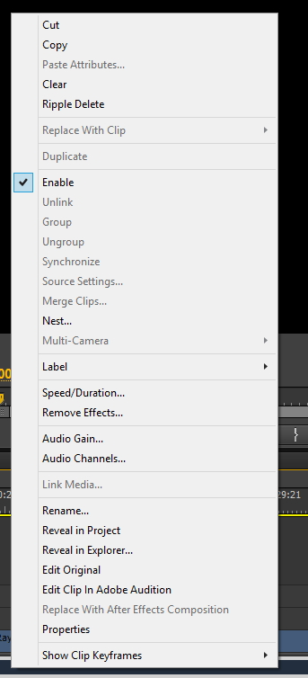

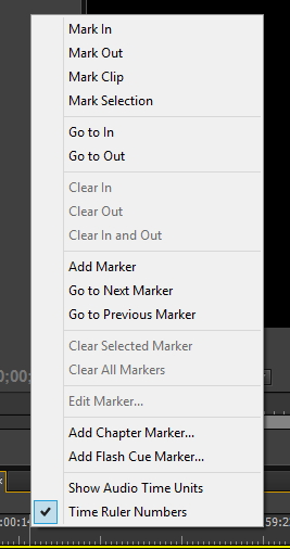

  13. I don't get what you're trying to do exactly...
    But you can display the audio in ms in PP, would that help you?
    1) Set the sequence settings "audio display format" to "miliseconds"
    2) In the timeline sequence, fly out menu, left click and checkmark "show audio time units"
    That changes the usual SMPTE display to hh . mm : ss . ms notation. Obviously you can change it back if you don't like it
    Sep 2014
    Rome
    hi
    i tried
    but i did not find
    where is it ?
    in the timeline sequence ,fly out menu is what there is in the screenshot ?
    thanks!

  15. Member Cornucopia's Avatar
    I'm using PProCS3, and in it you go:
    [Project | Project Settings | General], Audio Section: Display Format - Milliseconds or Audio Samples
    Then, RightClicking the TimelineSequence tab in the Timeline panel, check or uncheck "Show Audio Time Units".
    With Display format = Milliseconds, and SATU checked, your zeroed starting time looks like 00:00:00.000 (where right of decimal is msec 0-999)
    With Display format = Audio samples, and SATU checked, your zeroed starting time looks like 00:00:00.00000 (where right of decimal is samples 0-44099, etc. depending upon samplerate)
    With SATU Unchecked, regardless of Display format, your zeroed starting time looks like 00:00:00:00 (for SMPTE non-drop TC), or 00;00;00;00 (for SMPTE dropframe TC), or 0+00 (for "Film Feet+Frames", 16 or 35mm), or just 0 (for "Frames").
    Those are all chosen in:
    [Project | Project Settings | General], Video Section: Display Format.
    PProCC might be slightly different, but not too much.
