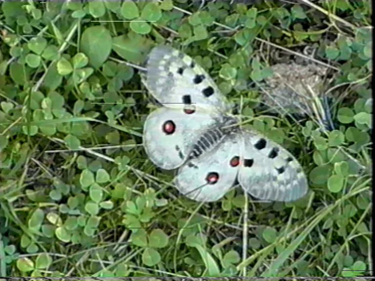

    Had a look at both samples. Can confirm what jagabo wrote: In the Composite capture the highlights are clipped. Interestingly both captures have their hot peak at 252, which is kinda odd – I would have expected the Composite capture to clip at 255, but instead it clips at 252 and has almost nothing beyond 252 even though there should be something like the S-Video capture clearly demonstrates.
    I do not see any obvious MPEG compression artefacts. It's good old DV after all.
    Edit: Looking at the samples again today, I realized the Composite capture has it's line jitter nicely stabilized by the camcorder while the S-Video capture, which was first digitized by the Yamaha, does not. Reason is the Yamaha does not stabilize line jitter as it seems, and after the video has been digitized once the camcorder cannot correct the original tape jitter anymore.
    It's quite obvious with the top part of the video in the butterfly scene. In the S-Video cap it looks like jello while the Composite cap is stable. That's bad news because it means both capture routes have serious flaws – just different ones.

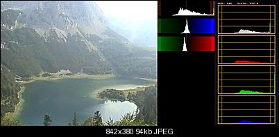

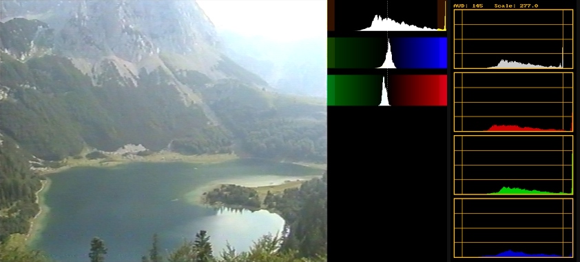

    Capturing as was done e evarlier, the levels problems is more complicated than one would think. Below, frame 174 of the s-video cap (the composite levels are worse), the YUV histogram shows raised black levels and clear clipping at the right end (brights). Borders and head switching nosie are cropped off to prevent throwing off the dark (left) side of the histograms. The RGb histogram (right-hand histogram) shows brightness clipping early, with chroma climbing up the right-hand wall (chroma clipping).
Name:	f147 - YUV - RGB.jpg

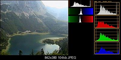

    Below, the same frame with everything brought toward the left-hand (darker) side using YUV contrast, offset, and slightly lower gamma. In the YUV histogram the bright cutoff is clearly visible and doesn't change, meaning that brights above a certain point are simply gone, nothing left to retrieve. In RGB the clipping points for both brightness and color are clearly seen and won't change shape. Clipping limits the dynamic range that can be achieved -- you can "stretch" the dark end and the bright end more if you want, but the high end and specular highlights will still be clipped and the image will look flat and washed out. Small "gaps" in the histogram indicate missing detail pixels, so further stretching will cause banding effects in large clear areas like big expanses of sky, water, snow, etc. Even with correction, the camera's auto gain during the pan creates problems of its own.
Name:	f174 Levels - YUV - RGB.jpg

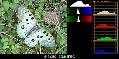

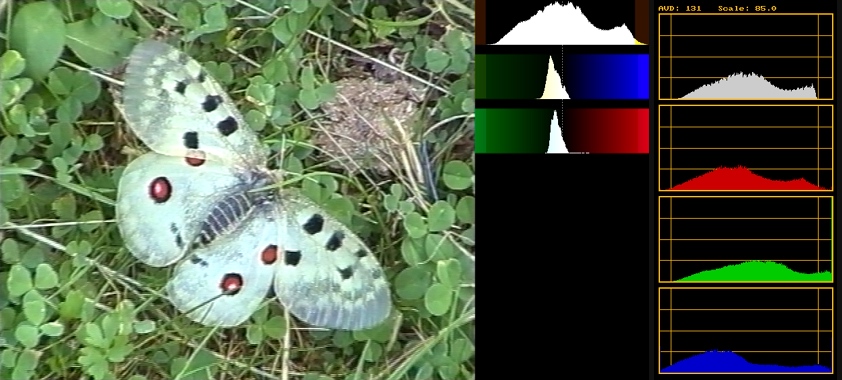

    Below, the unadjusted butterfly shot is a little better off, but still some mild clipping in the bright wings. Again, black levels are off and high gamma makes the image look thin and pale. Can probably be repaired, but it'll be tricky when gamma and midtones are twisted up during capture.
Name:	f364 -YUV- RGB.jpg

    With the two options we have examined yet it's "pick your poison". With the Yamaha (S-Video) route you have much less clipped highlights but there's no line jitter stabilization. The Composite capture has quite severe clipping but nicely straightened out lines (no jello effect in the top part of the butterfly scene).

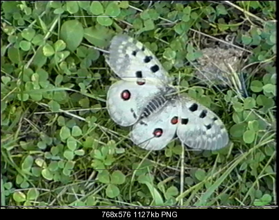

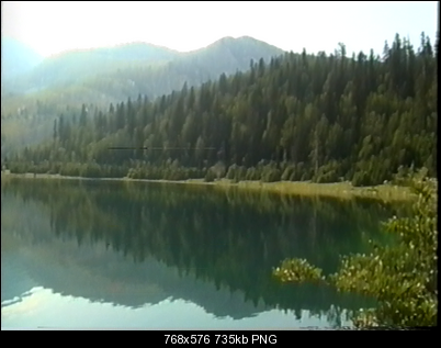

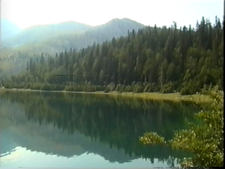

  16. What is causing these lines to appear? It only happens on the Phillips based card and only when capturing at 768x576. 720x576 looks good.
ID:	28876Click image for larger version
  17. Member Skiller's Avatar
    Oct 2013
    Germany
    IRQ conflict or just too much data for the controller. You probably do have other extension cards in use as well, right?
    But capturing at 768x576 is pointless anyway. The sampling clock for the digitization of the analog signal is fixed to ITU-R BT.601 standard (maybe not with Bt8x8 cards and custom drivers, but certainly with SAA7134) so capturing at 768x576 will just resize the already digitized video to that.
    The only correct capture res for your SAA7134 card is 704x576 (not 720). Comparing it to your 720x576 camcorder capture you can tell by the missing and smaller black sides that it is capturing the active 52 µs window of the analog signal which equals 704 pixels.
  18. Originally Posted by freee View Post
    That sounds like a software problem. Keep in mind that VHS only has a resolution of about 350x576. So capturing at 704 or 720 is already way above what's on the tap. 768 isn't going to give you any more detail.
