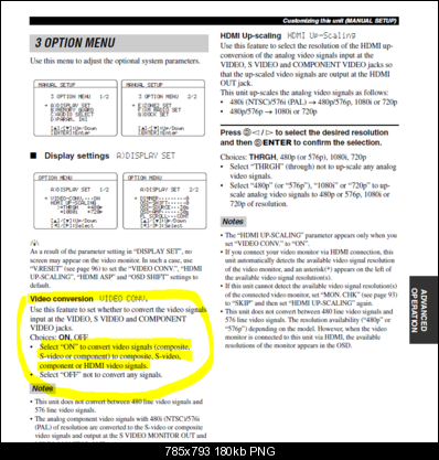

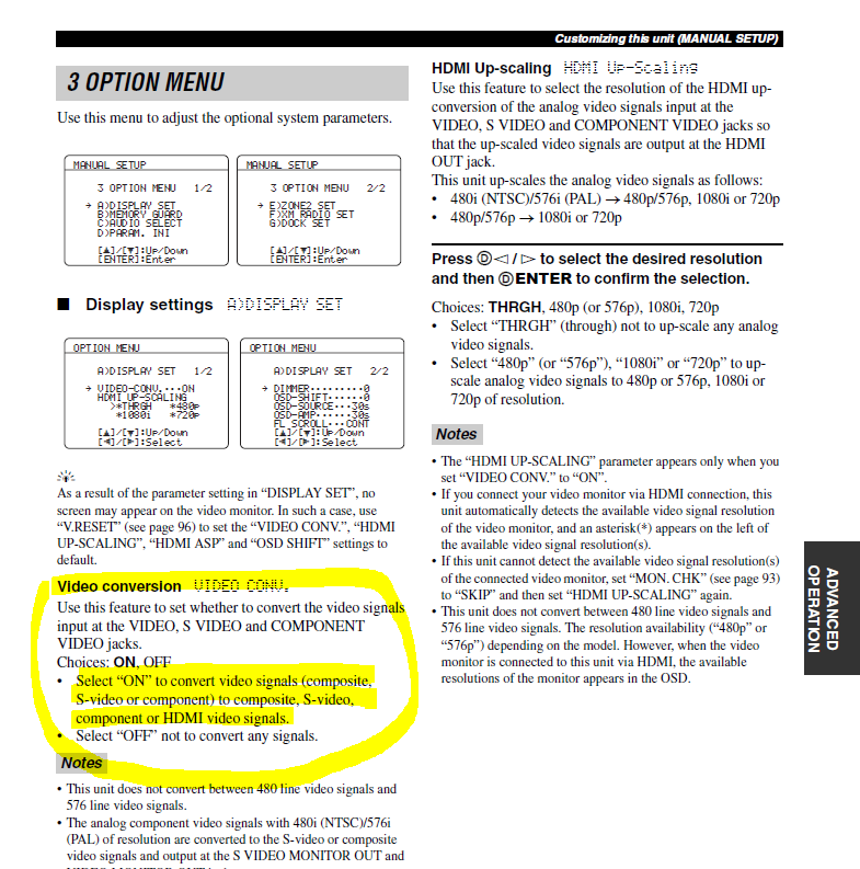

  13. OK, thanks to all gurus who contributed to my post. I have just realized that I have another option to get better result provided my logic is right. I was going through the menus of my Yamaha RX-V861 Receiver and bumped into the following option.
    If I am reading this correctly I can:
    * Connect my Panasonic NV-HD670 VCR to the receiver (composite to composite)
    * Set the conversion on the receiver to composite to s-video
    * Connect s-video out on the receiver to my old Panasonic DV Camera (it has s-video in input) and use the dv pass-through functionality to re-capture my tapes in dv-avi. Tapes are really in good condition. Or, use my old analog TV card PV951 to capture them as raw avi's (the card has s-video in).
    As I stated in my original post I have captured my VHS and VHS-C tapes in dv-avi years ago but I am not very happy with the quality. I have come across many suggestions that s-video is the way to go but the required hardware is either not available or prohibitively expensive.
    I am from a PAL land. I also have Canon HV30 but it has no s-video in option.
    Am I really going to get a better results by using s-video?
  14. Originally Posted by freee View Post
    Whether that works better will depend on whether the receiver has a better converter than the DV camcorder.
  15. Member Skiller's Avatar
    Oct 2013
    Germany
    You can use the Yamaha as a passthrough but it's not guaranteed this is will improve things, actually chances are it's making it worse.
    It really comes down to this:
    • is the comb filter which separates the Composite signal to S-Video better than the one in your camcorder?
    • how well does the Yamaha stabilize line jitter and how does it handle more severe signal dropouts (between recordings for example)?
    • does it clip or alter the video levels?
    • does it add noise or does it do some undesireable processing?
    You can only find out by testing.
    With VHS the advantages of a raw S-Video output (from an S-VHS deck) are only small. Once it's composite it depends on the comb filter in the connected device. The quality can be anything between rather much rainbowing and dot-crawl to almost S-Video like.

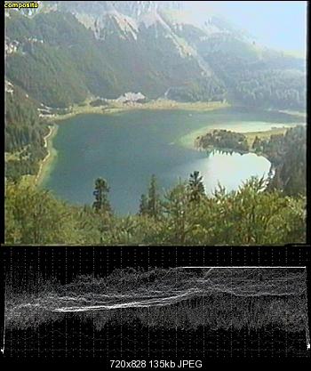

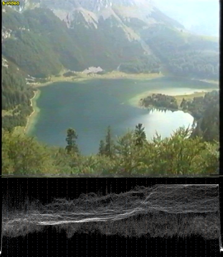

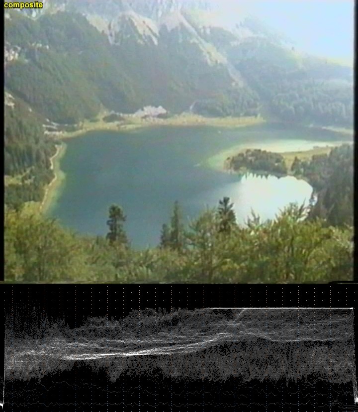

    The most obvious difference is in the levels. The composite capture has very blown out brights. So does the s-video capture, but not as bad. I adjusted the levels to match, and brought them into the legal range, for these screen shots:
    Look at the top right corner. With the composite video you can't tell where the mountain ends and the sky starts. It's clearly visible in the s-video capture. You may be able to get around this by adjusting the proc amp settings in the capture device.
    The composite cap has slightly more detail and slightly more color saturation. The s-video cap looks like it's been through a light noise reduction. The saturation can probably be adjusted with the proc amp. The loss of detail probably not -- cranking up the sharpeness might help.
    Hint: copy the two images to your Desktop or some folder on your computer. Use Windows Photo Viewer to view them, using the left and right arrow keys to swap back and forth. Even tiny differences will become obvious. Use Windows' Magnifier to zoom in to see the smallest details.
    Note the above images are JPG so they've lost a little detail. I meant them only for comparison of the blown out brights.

  27. Before I adjusted the gain on the two samples both waveforms went all the way to the top of the graph. I pulled the s-video sample down so that the max was at ~235 and then pulled the composite down so that the rest of the waveform matched. The OP should definitely play with the brightness/contrast settings on the capture device to see if he can bring the peak brightness down so it doesn't get clamped at 255.
