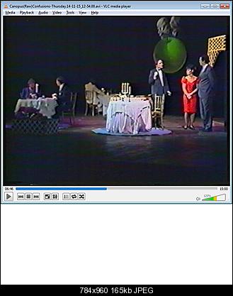

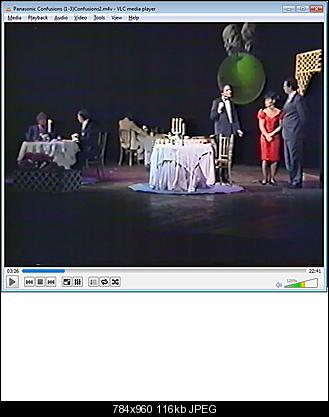

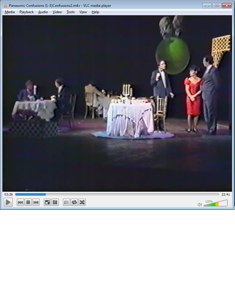

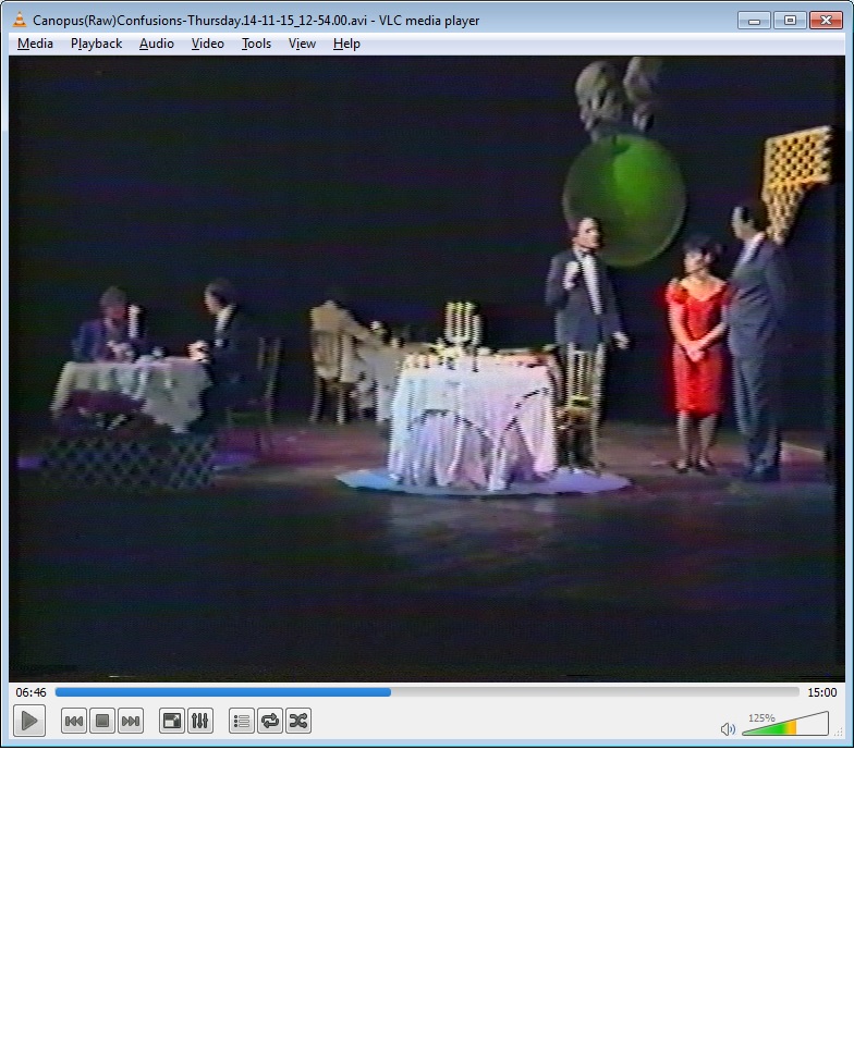

    Please see attached a screen grab from each, showing the blue streaks. The difference between the two is more apparent in the video, as the motion accentuates the artefacts more in the Canopus output.

  26. Member Skiller's Avatar
    Oct 2013
    Germany
    This looks a lot like the Panasonic is doing a noise reduction.
    On the other hand the ADVC is giving you the most raw and unprocessed output it can provide through the DV format.
    The Panasonic does correct the line jitter while the ADVC does not.
    Maybe you can use the Panasonic as a passthrough for the ADVC. A line jitter correction is very desirable for capturing so I wouldn't ever connect the VCR straight to the ADVC unless it's a deck with builtin TBC.
  27. The DVD recorder has captured with different levels and less color saturation. You easily filter the DV cap to match that, or vice versa. The DVD recorder has also obliterated small, low contrast details with a temporal/spacial noise filter. If you wanted to you could do the same in software with the DV cap. But you can't restore that lost detail starting with the DVD recorder cap. The DVD recorder has cleaned up the horizontal jitter (line TBC). You can probably pass the signal through the DVD recorder and record with the ADVC to get the same benefit.
    If you want to capture and be done, use the DVD recorder. If you want the best possible quality and don't mind spending time working on the video, use the ADVC (possibly passing the signal through the DVD recorder to clean up the time base).
