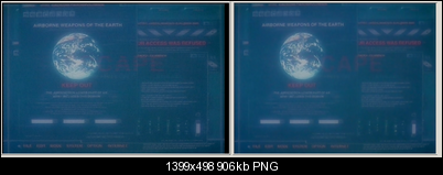

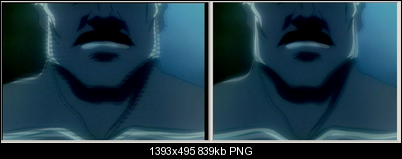

    I have an old bootleg (unfortunately) anime I'm trying to rip and improve the video. I've managed to get VirtualDub and find a few plugins (a feat for me coz I'm pretty Windows/video stupid here).
    The "noise" is present during playback even after the filters and even in the lighter scenes. It's like static on an old tv or something? I'm not sure how to describe it. Is there a way to smooth it out without losing too many details? Any suggested filters I'm unaware of that will work better?
    Here are a few shots from VirtualDub as examples of what I have so far:

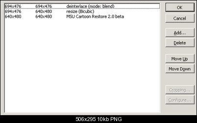

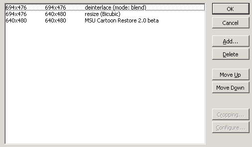

    And the filters I'm using:
Name:	Screen Shot 2014-11-05 at 3.57.46 PM.png

    Definitely provide a sample but in the mean time why the tiny resize? Nothing good comes from those tiny resizes.
    I like to apply an edge aware blur for animations and then apply a "Lumetri" or some "film stock" kind of look.
