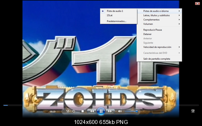

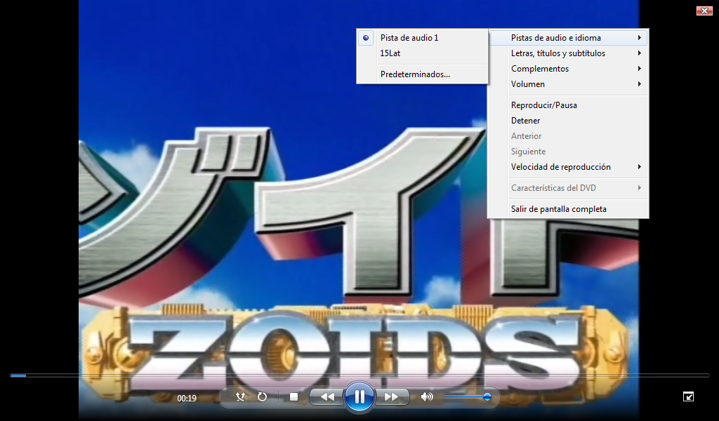

    I used to play all my Dual Audio AVIs in Windows Media Player 12 (Windows 7) just fine, I could select which language I wanted (Fullscreen mode > Right click > Select Audio Track & Language)

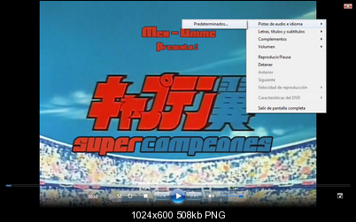

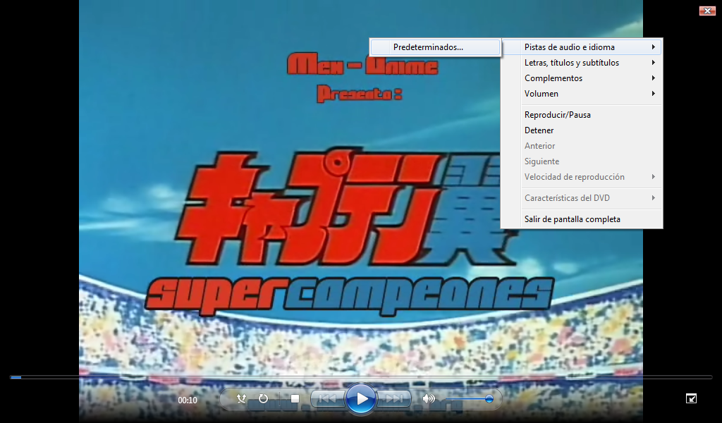

    Then I installed AviRecomp to add hard Subtitles to some Vids, and the computer was working fine until last week (except for a couple of icons in the taskbar everytime I open some video, that was so annoying) when I unistalled AVIRecomp ('cuz I don't use it anymore) all my problems started, everytime I played any of my Dual Audio AVIs in Windows Media Player 12 both sounds were played at the same time and it couldn't let me choose the audio like before just showed me "predetermined..."

    So I was giving up until I read somewhere to use Codec Tweak Tool portable to fix the issue, and well my problem is now half-solved 'cuz if I play a Dual Audio AVI coded in DivX (see the Zoids one above) I can change the audio just like before

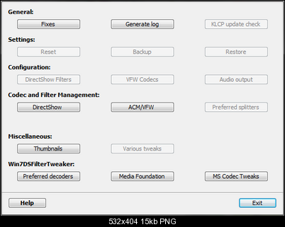

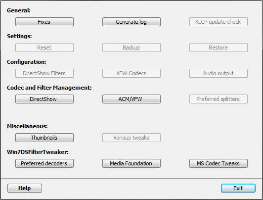

    Codec Tweak Tool only give me this options:
    In the preferred decoders there's only two options "Microsoft or USE MERIT" it doesn't matter which one I used for Xvid it keeps giving me both audios at the same time

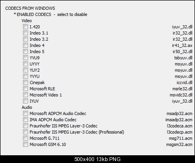

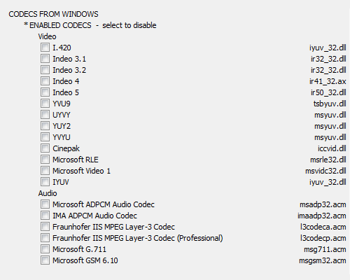

    In the DirectShow section are only two codecs in audio is Microsoft G.711 decoder and in source is IVF source filter, and these are the codecs that Codec Tweak Tool found in the VFW / ACM codecs section
    And the same here, I disable all the options and is useless, if I go to MS Codec Tweaks and disable media foundation it let me choose audio in the Xvid movies but shows no image, just audio

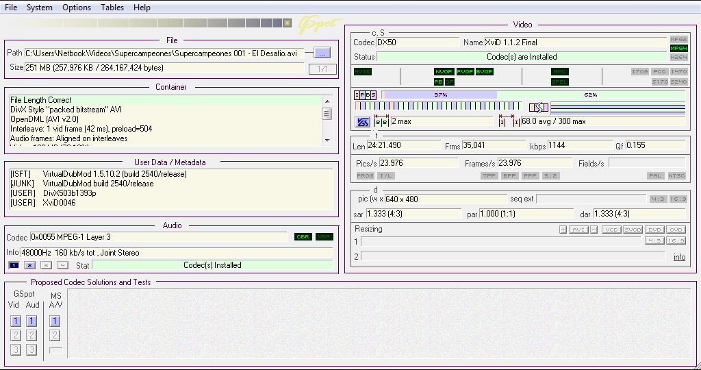

    *Also I used AVI FourCC Code Changer to treat 'em like Divx and WMP12 let me switch between audios, so I know it has to do with some codec playing xvid files but I need to know which one is causing the issue and how to fix it.

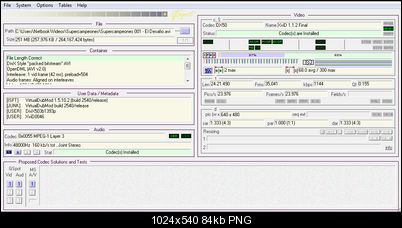

    This is the gspot screen with the file info:

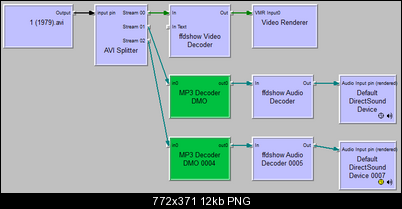

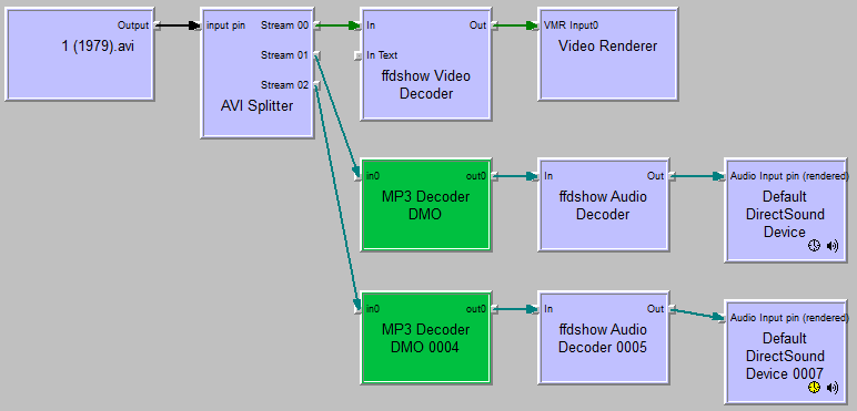

    I agree. It's probably in the AVI Splitter. Try re-registring quartz.dll (Windows' built in reader/splitter/codec library).
    A DirectShow Filter graph for an AVI file with dual audio tracks (from GraphStudio):
    The Avi Splitter is quartz.dll.

    If the dual Audio AVI file says this:
    I can switch audios, but if it says this:
    I can hear both audios at the same time and WMP won't let me choose which one.
    So I know it has to do with the way WMP12 treats Xvid header coded files so it must be a misconfiguration assigned to that type, because if I change the "FCC Description Code" from xvid to divx and the "FCC Used Coded" from XVID to DX50 in the file, WMP let me choose the audio I wanna play.
