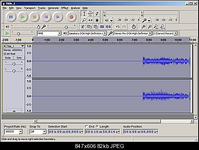

    Using Audacity 2.0.6 with the ffmpeg library I notice that when mpg files from a DVD or wtv files recorded OTA are loaded, there is a section at the start of the stream that is blank.
    It increases the length of the stream anywhere from seconds to minutes depending on the running time of the source.
    If the same audio is extracted using ffmpeg cli and loaded, the audio shows the correct length.
    The mpg files are generated by VOB2MPG, the wtv files are from Windows Media Centre.
    Anyone have any comment as to the reason.

    Point MediaInfo at it and see if there's a "Time code of first frame" element in the video track and if it matches the blank section length.
    Dec 2005
    Canada
    There is a time code, but I think its refers to the time of the frame in the original DVD that this was re-authored from.
    Time code of first frame : 01:24:15;09
    Another example is an ota recording that I made lasting 24 seconds, when converted to mpg, the time is way off.
    Time code of first frame : 10:22:43:31
    As a side note, I normally use a portable version of Audacity, but I downloaded and installed the latest version..the results were the same.
    Sep 2012
    Australia
    Do you have a file that DOESN'T have a "time code of first frame", does it do the same thing?
    Dec 2005
    Canada
    No, all the mpg and wtv files have a "time code of first frame".
    Other formats don't have a problem (but they don't a "time code...").
    If I take the mpg which came from VOB2MPG and let ffmpeg re-mux without re-encoding, it loads into Audacity without issue (it still has the original "time code.." thingy).
    Sep 2012
    Australia
    Hmmm, try "debug"|"advanced mode" in the MediaInfo GUI and see if there are any kind of delays.
    Dec 2005
    Canada
    Original.txt is the one with the wrong length in Audacity.
    New.txt is the original, re-muxed using ffmpeg with the correct length.
