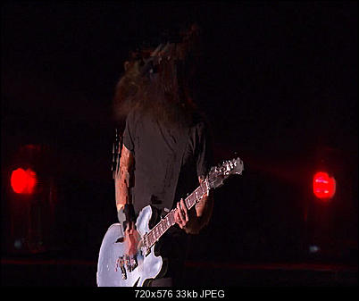

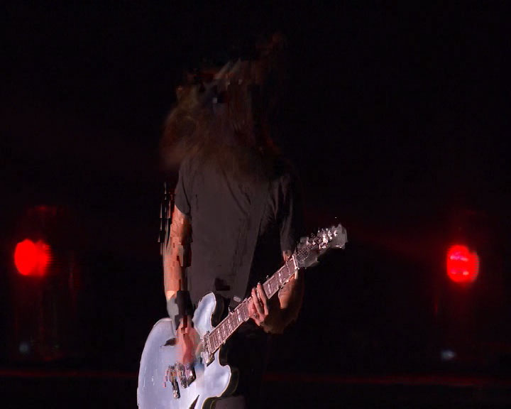

    Ran it through DGAVCIndex and encoded a sample, result:
    So I guess it doesn't like that either, at least not with that script combo. I don't have an Nvidia card, no. Haven't used ffmbc before, will take a look.

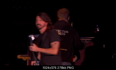

    Created the avi, 1.05GB for the minute so not too bad. Just encoded it with HCEnc, result looks good to me although there is one issue that I've been seeing in a few of my recent encodes. The following image is from the M2V in Vdub with a deinterlace filter.
    I'm referring to the red horizontal lines under his ear, off his shoulder and to the right of his thumb. Is it just the red lighting on stage that causes those lines?
    Here is the output file - https://mega.co.nz/#!pEs1CCbY!EI8YqKVh93_grxG8dvd9tPHMxrE_cB38iBhC5CRu_cc
    Less noticable in motion but I do see it occasionally.
  11. I'll take a closer look , but I the problem is your method of screnshot taking - vdub doesn't handle interlaced 4:2:0 very well. It upsamples it as progressive .
    If you take a screenshot with avisynth (e.g. avspmod, or even through vdub with avs script), what does it look like (interlaced =true flag for the RGB conversion)
    mpeg2source()
    converttorgb24(interlaced=true)

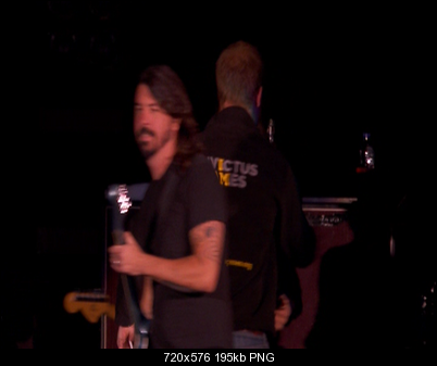

    Looks ok here, normal (not deinterlaced)

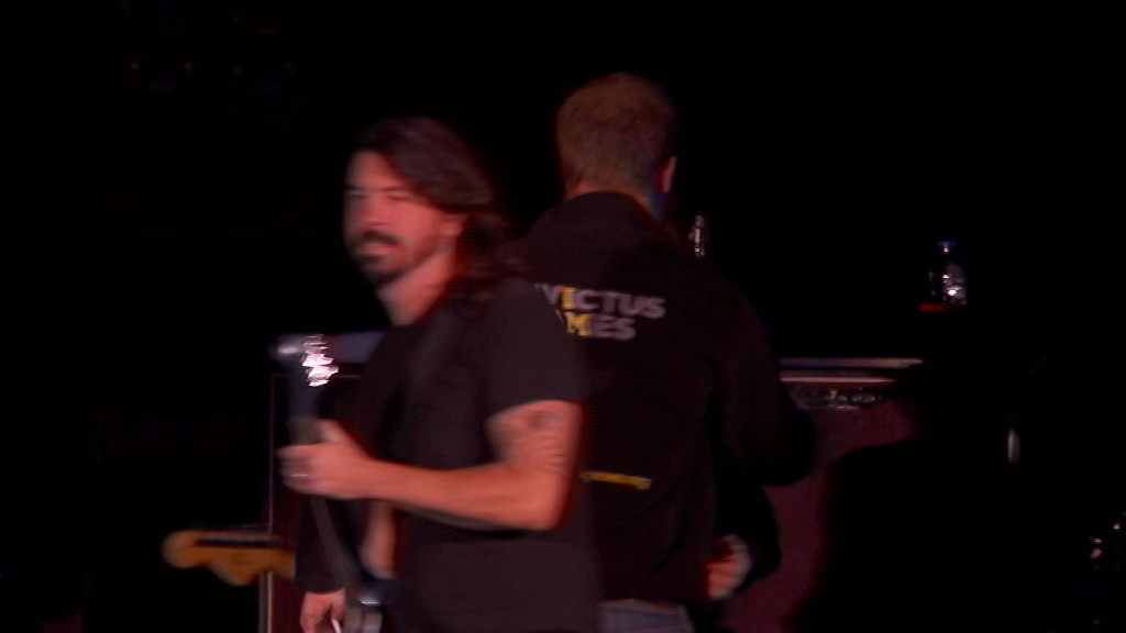

    Simple bob()

    Ok, did not know that. Tried that and yep, no problem now. Thanks.
