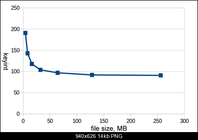

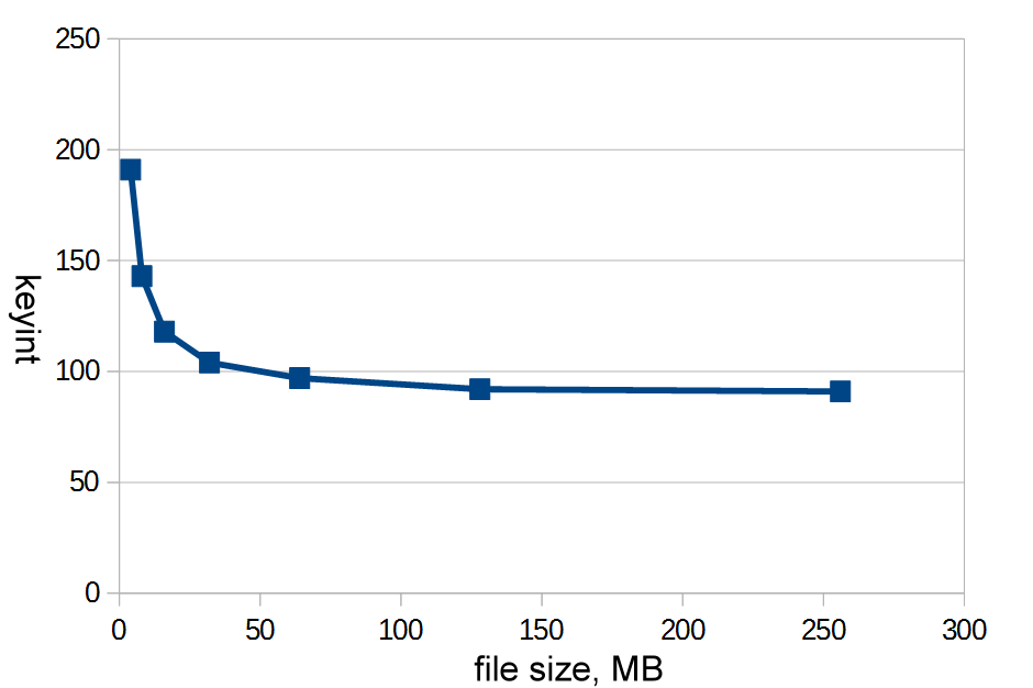

  11. Here's a rough example. A 10000 frame sequence from a Blu-ray M2TS file cropped to 1920x816 and encoded with x264 with the slow preset:
    keyint  file size (MB)
     4      191
     8      143
     16     118
     32     104
     64      97
    128      92
    256      91
    Of course, the exact results will vary depending on the properties of the video. For example, music video with lots of very short shots will benefit less from long GOPs.
